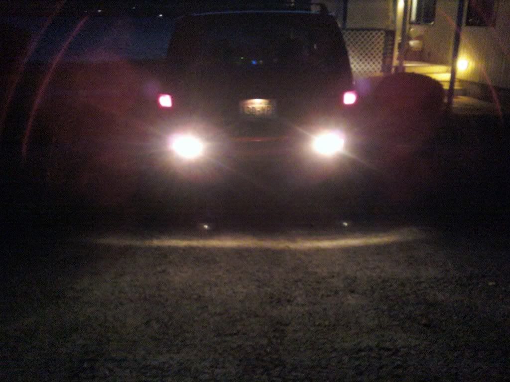

let me know what you think and also if anybody else has done this? or simular

clean... damn 10 characters

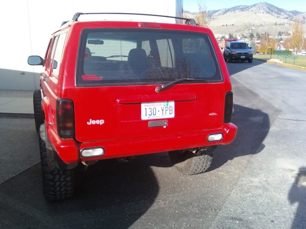

Can't see them all that well, but they're there. Right behind the funky roof rack (which never got mounted).

i mounted 2 to my rear bumper. one's hooked up to the back up lights, and the other one is going to go on a switch.

That looks like one of my next mods. I put them in my truck years ago. They are cheap, easy to install and incredibly durable.

#1 Cut 2 holes
#2 wire into stock wiring
#3 pop lights and grommets in and let er rip

It really is just that easy. If I remember right, I took some careful measurements and drilled a 2" hole on each side of where the light would be. I then cut out between the two holes with a Sawzall, spliced into the factory harness so the bumper lights came on with the stock lights, tagged some self tappers into the frame to ground the lights, crammed the grommets into the holes and crammed my new lights into the grommets.
