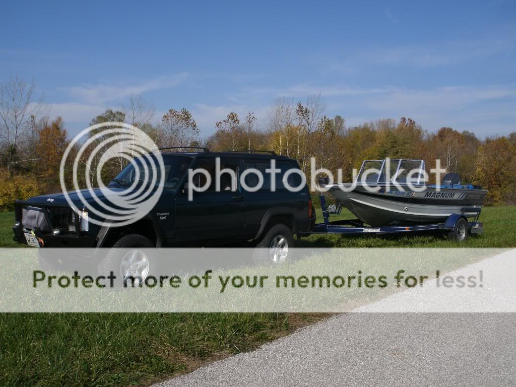

Hey guys I tow a 17 foot Sylvan with my 2000 xj Sport with a 4.0 auto and a 8.25 rear end. After going to the lake and back I started my jeep and it sounded like it was missing. After giving it a little throttle, it ran fine. Just want to make sure I'm not hurting my xj!
