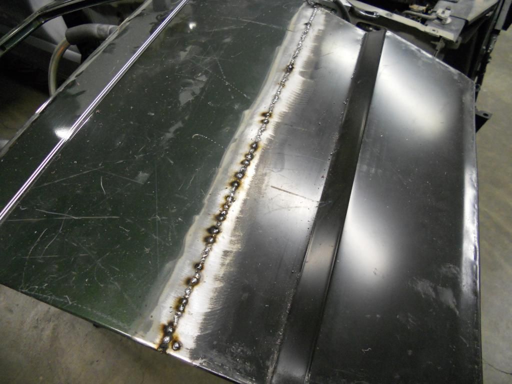

Spot welding like a pro (or trying to at least):
Have I mentioned I hate body work:

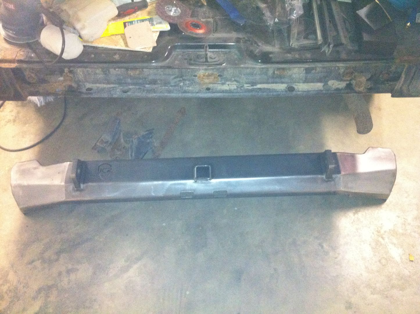

And just ordered a JRC standard rear bumper

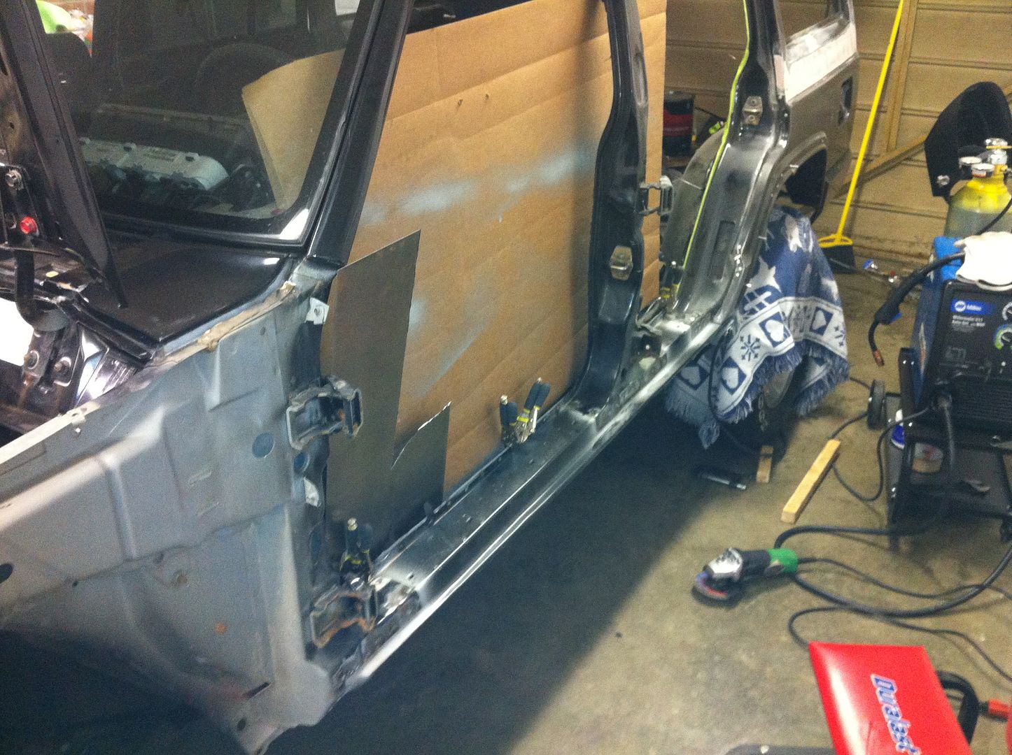

Decided to replace the drivers side rocker instead of just patching the bad areas... 100 holes later:
Replacement mocked up:
Burning it in (29 welds done... 71 to go!):
New hood! It doesn't quite fit though, hoping new hinges fix that:

Thanks! Yeah, unfortunately this project has been dragging on pretty good due to work and spending most of the time on my WK. And now nothing will get done in the next 6 months due to deployment. As soon as I get home I plan on finishing it up though! Its getting close to being ready for paint. Well since I dont have any pictures of the progress with me here... I'll just whore the WK out. Here is is right after repainting the bumper and cleaning it up:
The bumper right after paint... Just practice before spraying the XJ

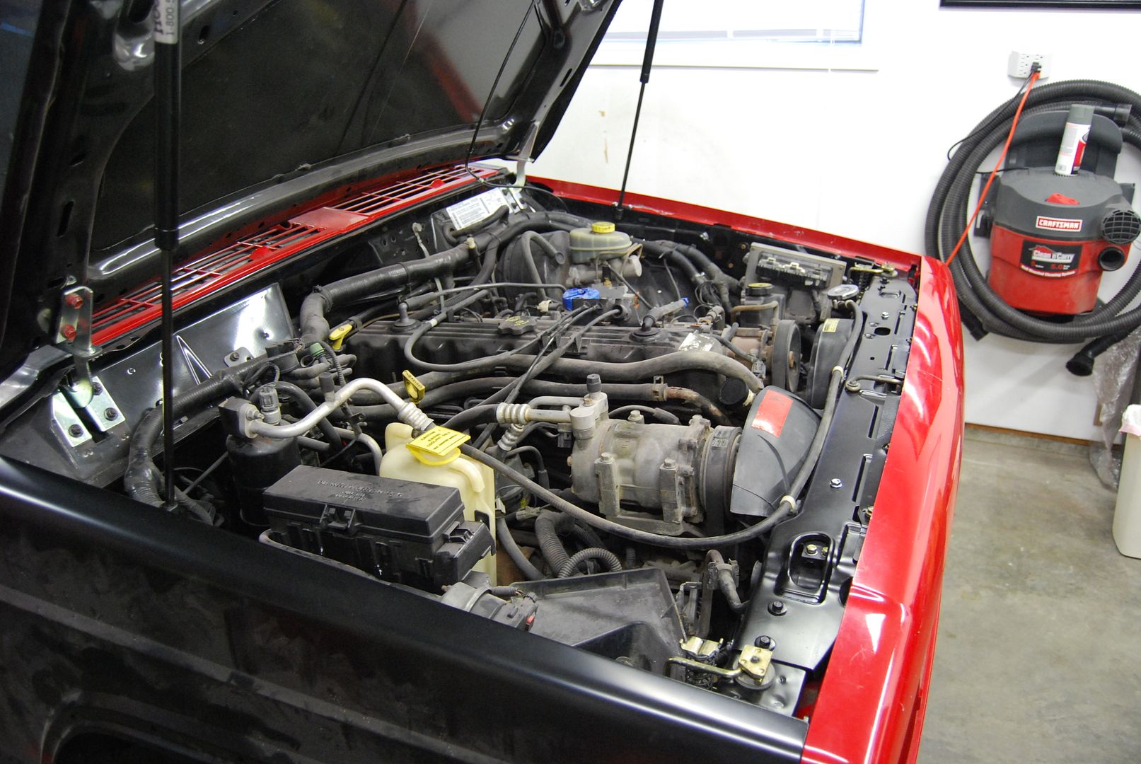

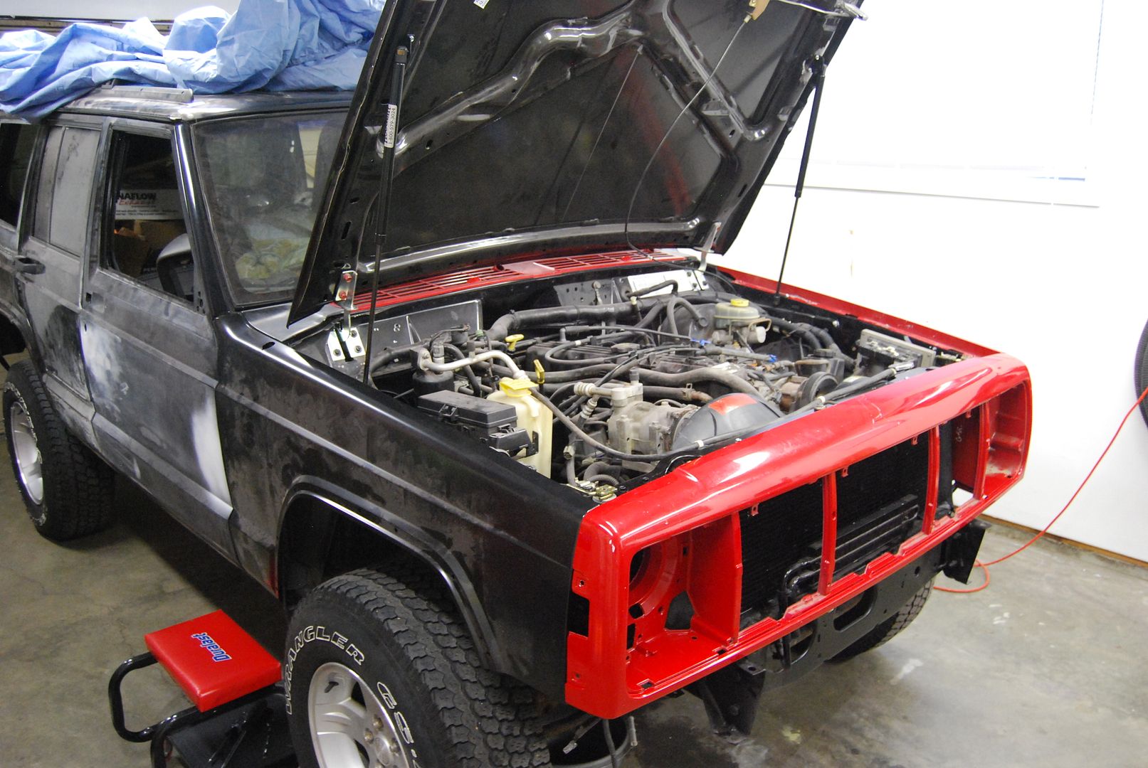

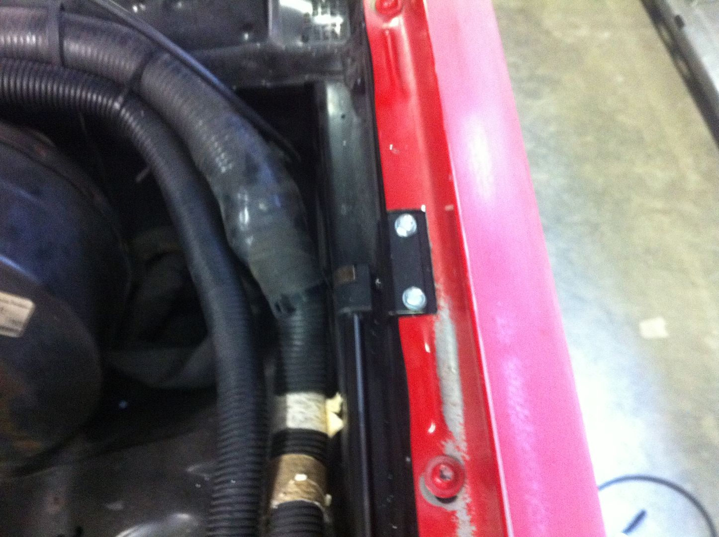

Finally got everything on the front end aligned... the frame is pushed towards the passenger side about 1/4" so I had to redrill all the mounting holes for both fenders. Its pretty close (or at least close enough) now:
All new hardware (hood hinges, latches, strikers, radiator and gromets, ect):

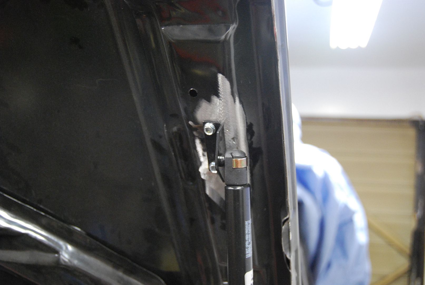

Installed Hoodlift struts. I cut the fenders instead of installing over them for a more professional fit:

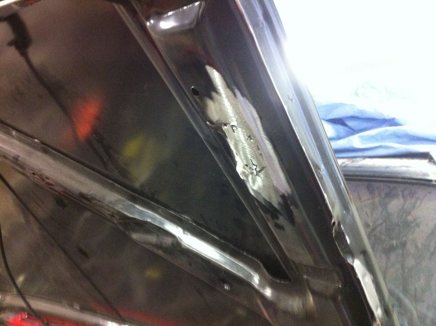

For the hood side mounts there is a dip on the drivers side that needed to be fixed. I welded in a plate:
For the hood latch armature I welded in 2 nuts instead of the factory rivets since the aftermarket hood had some large holes there so the rivets wouldn't work:

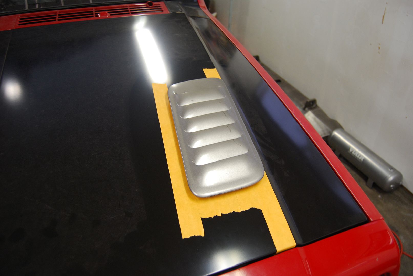

Test fitting the 5.9L vents:
Holes drilled:
All done!
I even got the factory drip trays to bolt up with some trimming:
Getting closer to paint! The build is going pretty slow with my constant state of being deployed (another one coming very very soon). But I'm hoping to have some paint on it before I leave. I think I've decided on a color too!
