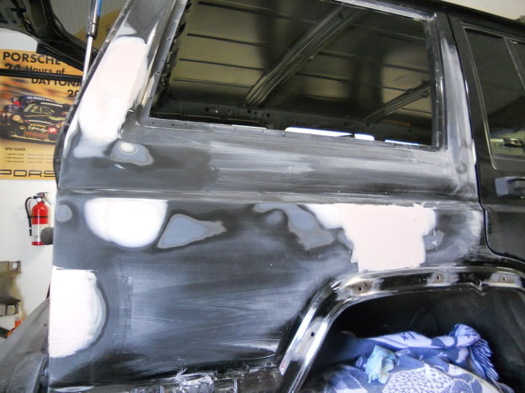

I haven't posted an update in a while, hopefully I'll have a lot more time to work on the Jeep after next Friday. But this will probably be the only update until then.
This fix is taking the majority of my time:
The other side isnt too bad:

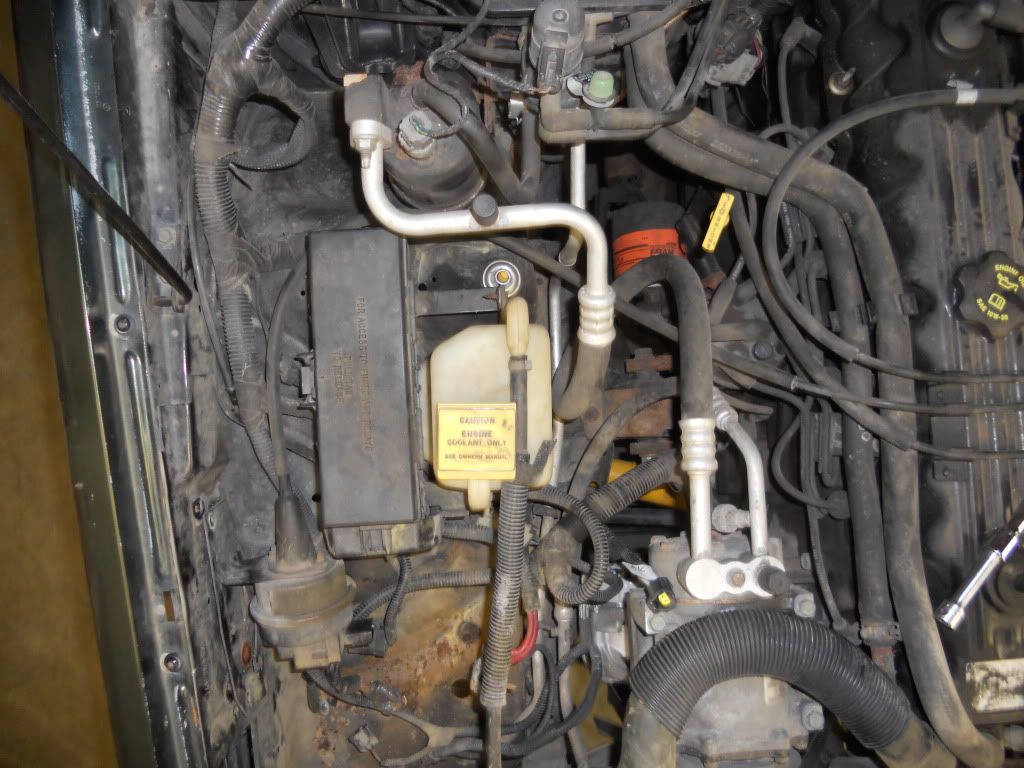

I've decided to stick with black for the color, so I'm not going to paint the engine bay.
Before:
After:

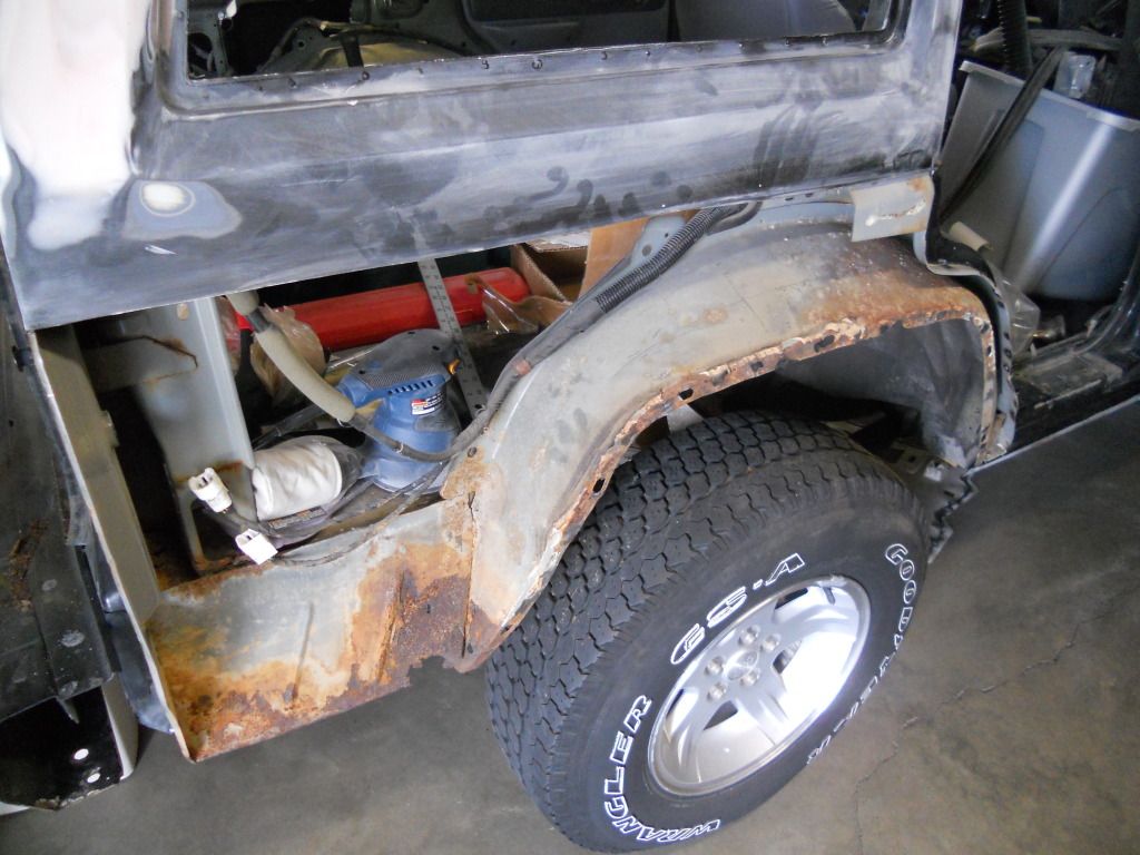

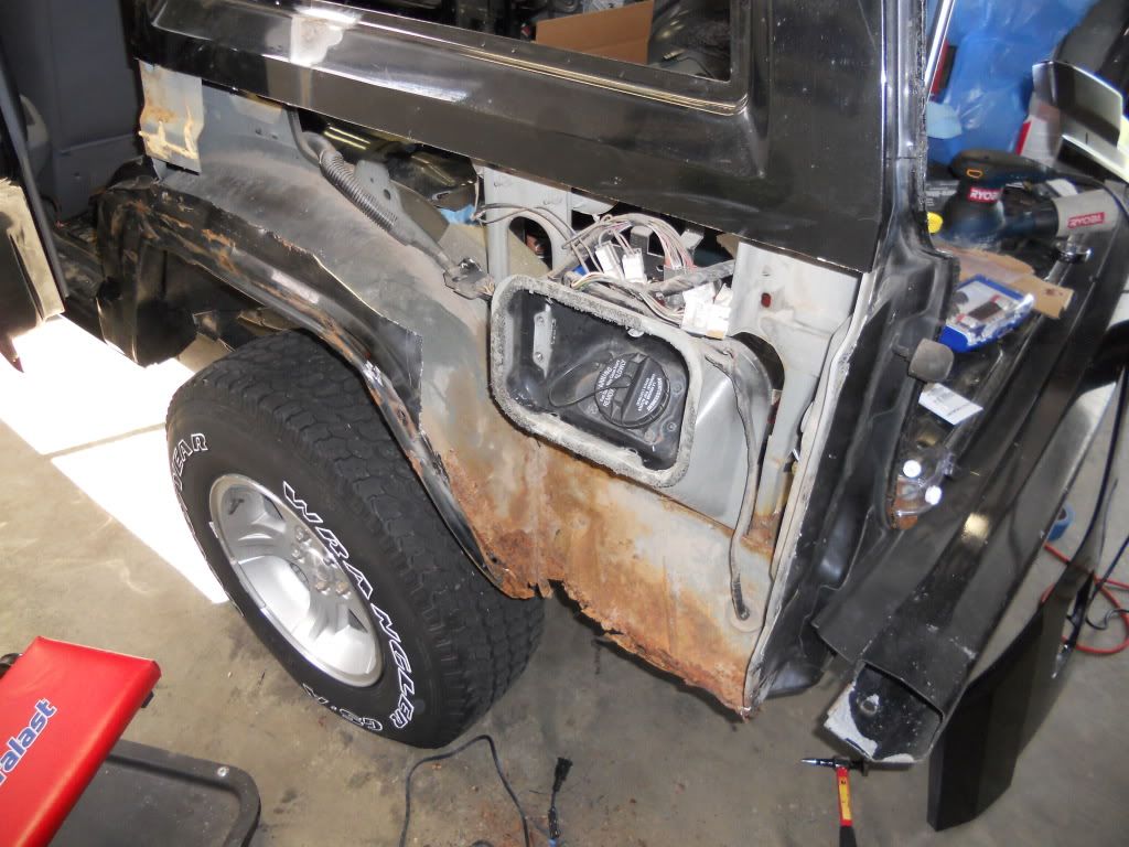

Finally got some time to work on the XJ! Hopefully it will be ready for paint in 2 weekends, or else it will probably have to wait until next summer...

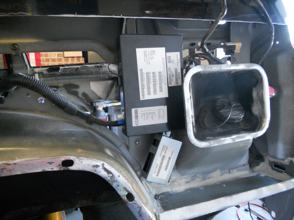

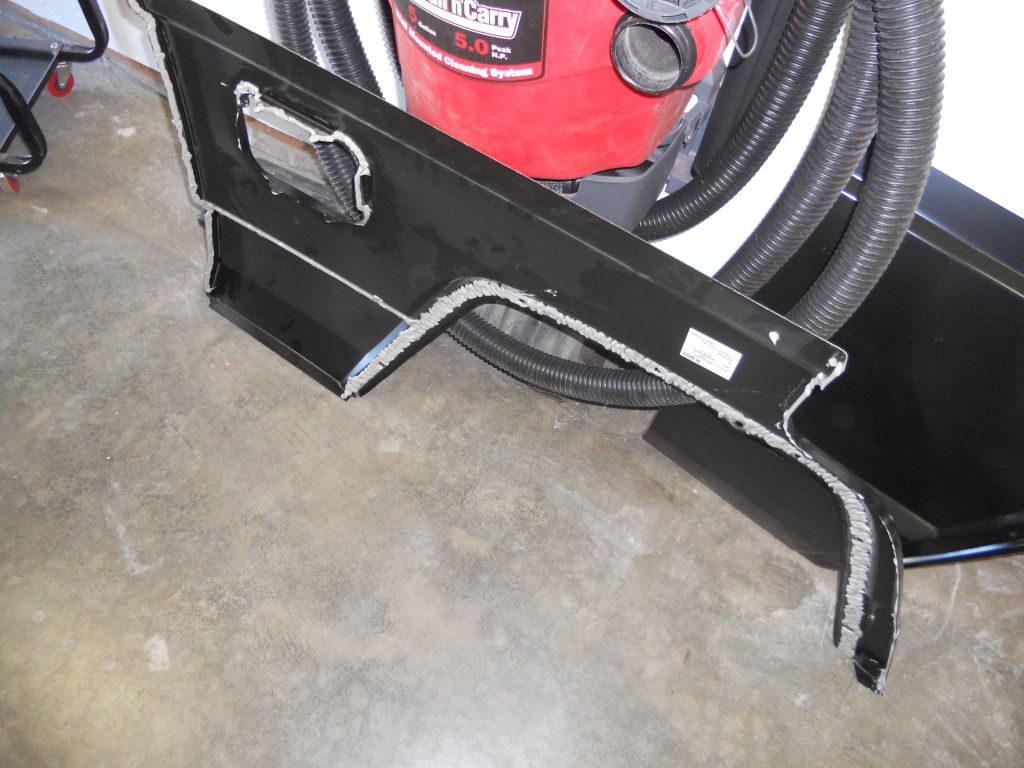

I finally finished cutting and grinding out the old panel (harder than it sounds when you don't have a spot weld hole saw):
I'm planning ahead for the eventuality that this will become an off-road toy instead of a daily driver. I decided to make the panels flat behind the body line so I can do the rear fender chop with ease:
Found a good spot to mount the sirrius radio hardware:
Glue around all of the mounting faces:
Welded the seam (or at least started welding the seam):
I liked the results so much I decided to just do the same on the passenger side instead of dealing with all of the body work:

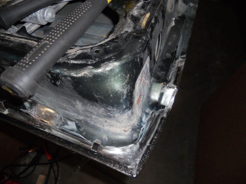

Now to fix that stupid bent rear door:

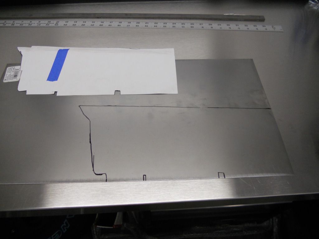

After tacking the panel on, I glued around the edges then folded them over:

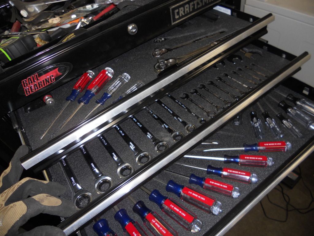

And finally I found some time to cut out some tool foam to organize a few drawers:
I almost always wear gloves... almost always:
