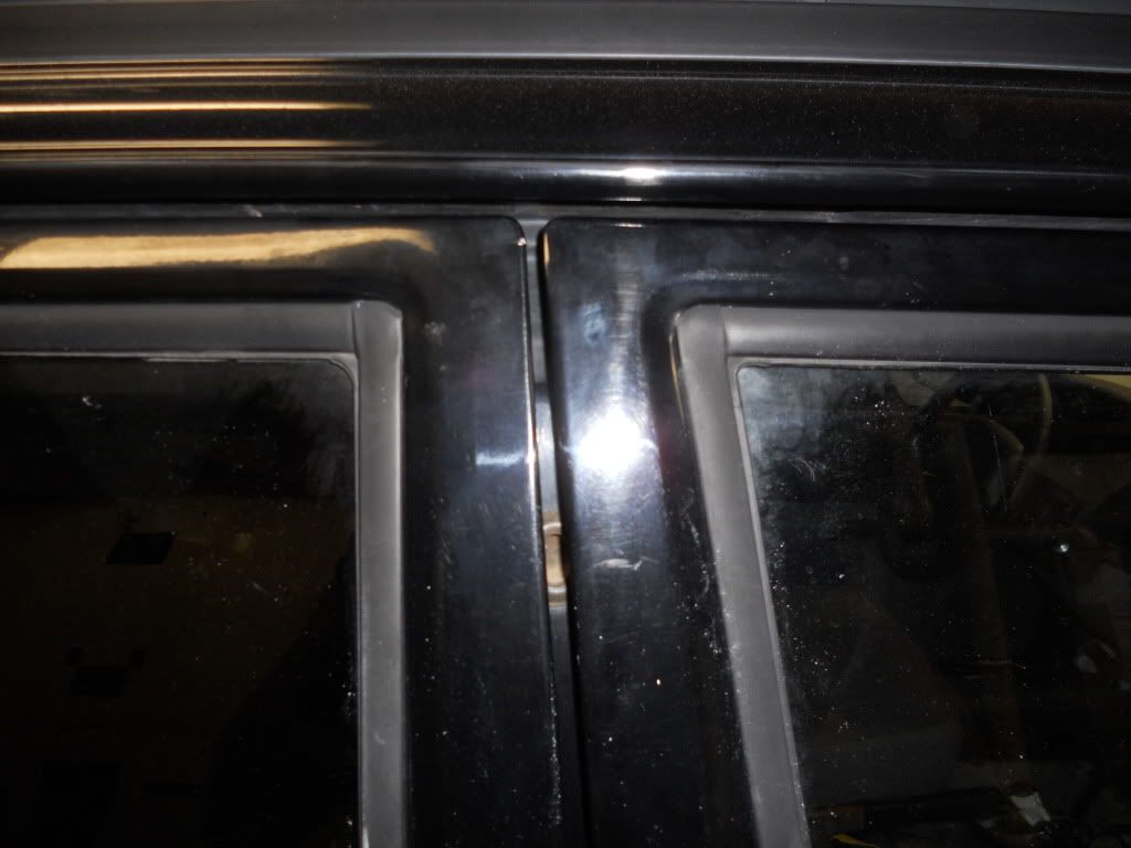

I plan on leaving the doors on for paint, thus I needed to get them aligned (or "gapped") correctly with weight on the doors. I felt it was best to do this before paint instead of after, so i could get them right before I start removing stuff from them. So I spent today working on it. Its a tedious process of trying different spacers on the door hinges and making small adjustments to move the doors in and out and up and down.
The upper spacer on the right front door was a little too thick causing the door to droop too much in the rear so I made one that was about half the thickness (I tried removing the spacer but it made the door too high):
The goal is an even gap all around. This requires not only manipulating the hinges, their spacers, and moving them every which way, but also making sure the door strikers are in the proper position.
