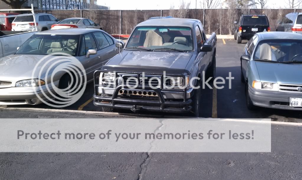

i dont even consider my jeep lifted, it has a budget boost
here is the taco version of your bumper
How ironic, theres a cherokee in the back!
