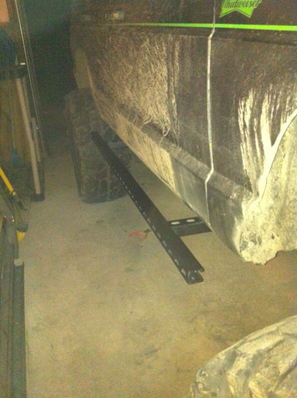

So those sliders just bolt to your frame rails? Are there any more supports?

The sliders are mounted to the frame rails in three places and the the pinch seam along the under side. It's very similar to how any after market brand is mounted. Each mount to the frame rail has a steel plate on both sides if the rail and two 1/2" grade 8 bolts going trough. Te pinch weld has 6-7 bolts with flat stock running the entire length to sandwich th pinch seam

You should have made some beast sliders like these, I heard they got all their materials from Lowes.
But seriously I do like your sliders..just not that bumper.
