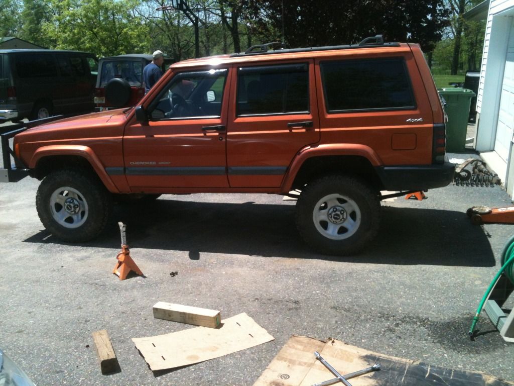

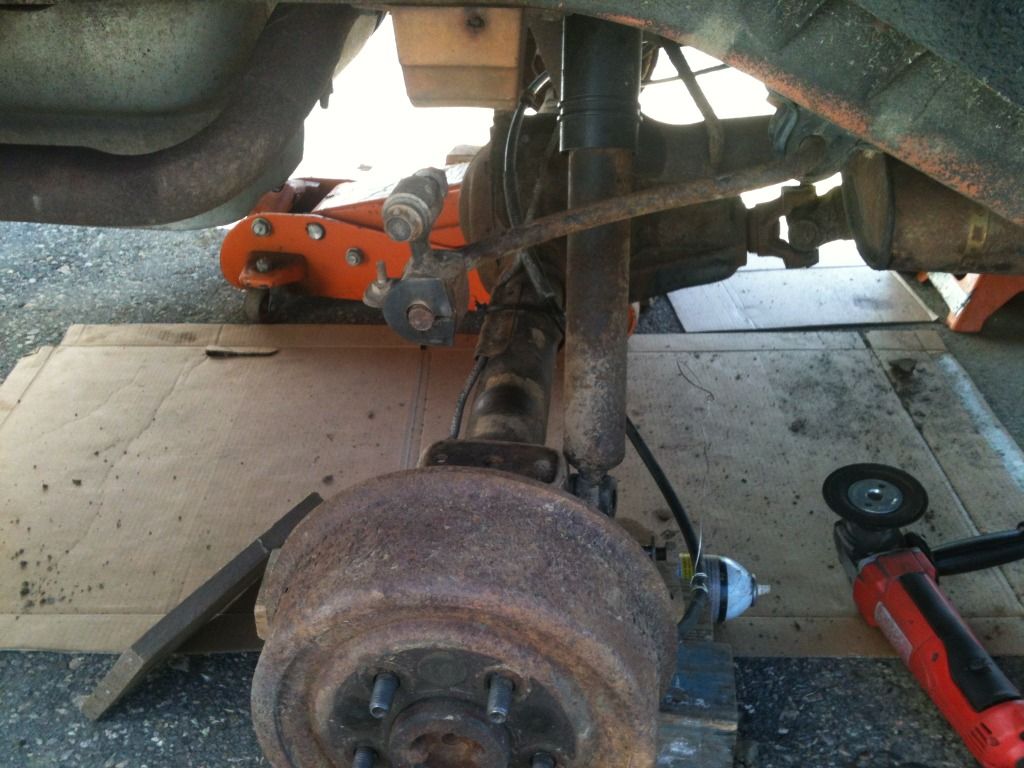

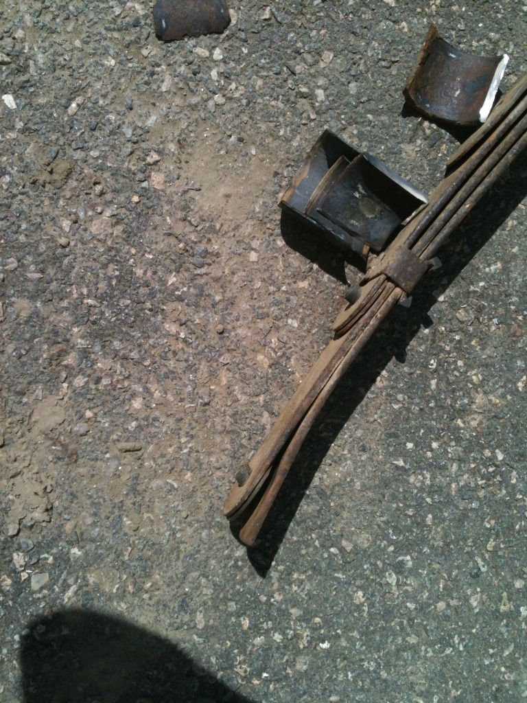

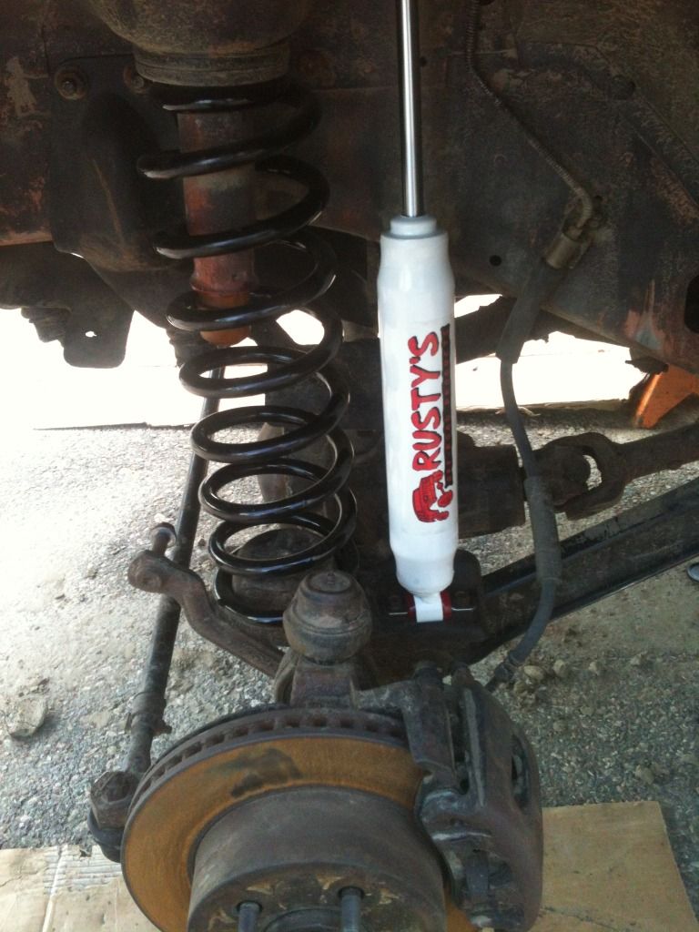

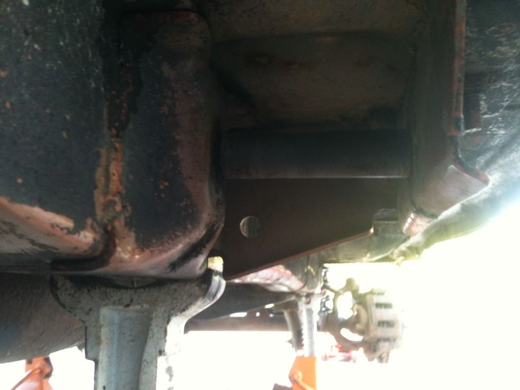

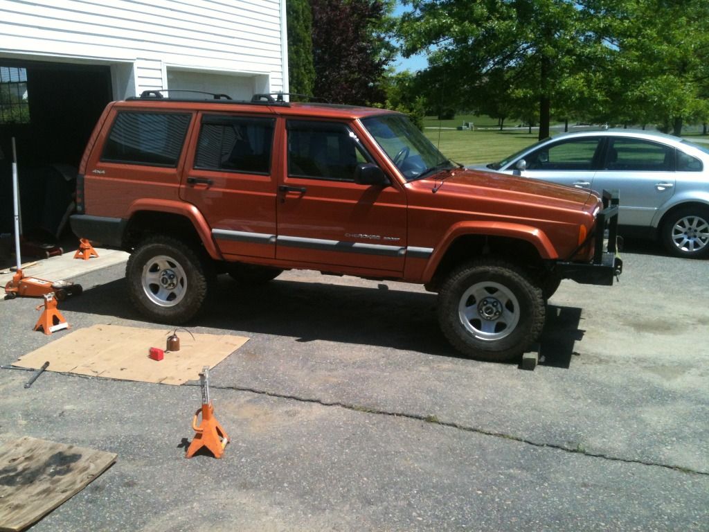

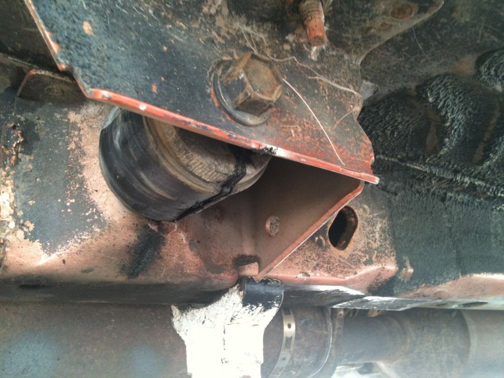

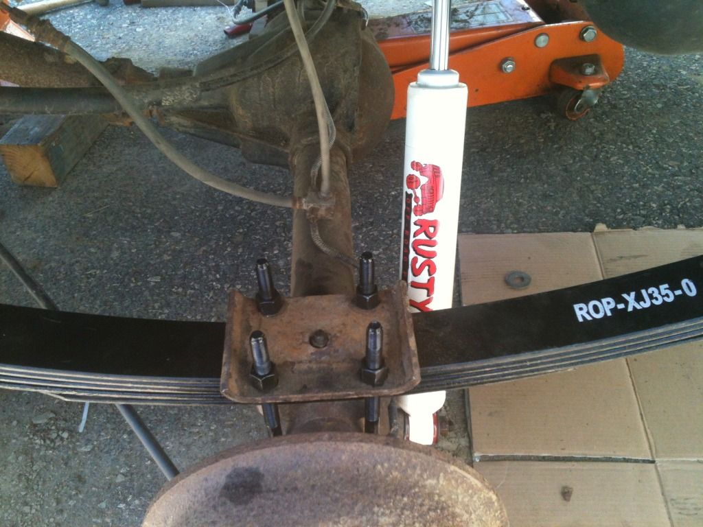

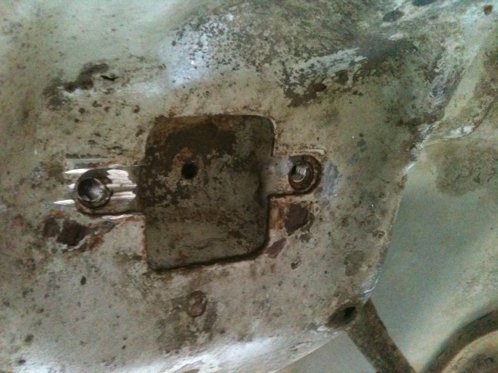

So today started the lift install. Was able to get all the old stuff out and the front end totally finished axcept for the discos. Im having trouble with the rear leaf centering pin fit into the spring perch on the axle. Any body have anyhints. I managed to snap two bolts on the rear shocks but drilled it out and tapped a hole for a 5/16 bolt. Here are some pictures of the progress. Has anybody used the Rustys(or other brand) rear brake line relocation bracket with success?? Im afraid to break the line when it gets relocated. The front spring bolts were seized to the metal sleeve so I cut the srpings off and used an air chisel to seperate the sleeve and turn the bolt out. SOme pictures of how I cut the springs off, front installed and rear taken apart.

Everything was sprayed with PB blaster numerous times. I tried test fitting the new leafs in but the centering pin is slightly to big to fit in the spring perch. Does anybody have any solutions to this?

Drill the spring perch?

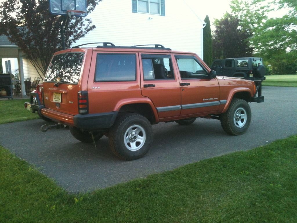

Was able to file the centering pin down to the right size. Got everything installed and its AWESOME. no more feelin like a grocery getter. The rear shackle angle could be a little better but I'll see how it is after everything settles a bit. SOme pics of the final work and how its sitting. Im kinda likeing the back end a bit higher. Right now the back fender fair is siting 36" from ground IIRC. Iv gotten up to 65mph and not had any vibrations which is great. And final pic of the jeep family in the field(minus the CJ2A)

35s fit nice with 3 inches of lift. Just saying.....
