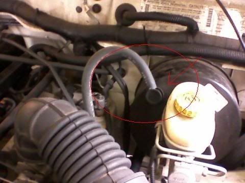

eek ima post a pic to make sure its the brake booster, one sec lol, grr t mobile come on! send the pic to my album!

ok heres a pic, im just making super sure! just a lil nervous abotu doing it...

post #5 of 10 Old 08-23-2008, 03:45 PM
Sublimize23
Location: West Chester, PA
Posts: 76
'98 XJ All stock
'02 Mustang GT - Toy
Sublimize23 is offline
post #6 of 10 Old 08-23-2008, 03:47 PM Thread Starter
JeepCherk98
2003
Location: Oxford AL
Posts: 190
Lol i will *just do it* now
