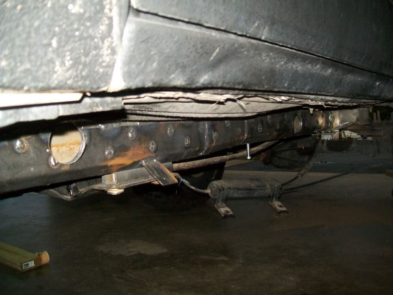

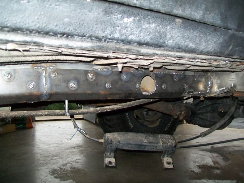

holes drilled 2 3/8
slugs into the passenger side
Driverside
the frame isnt like l channel its rounded in towards the center so I notched the slugs to get it flush with the inside
about what itll look like

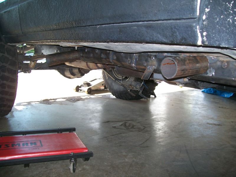

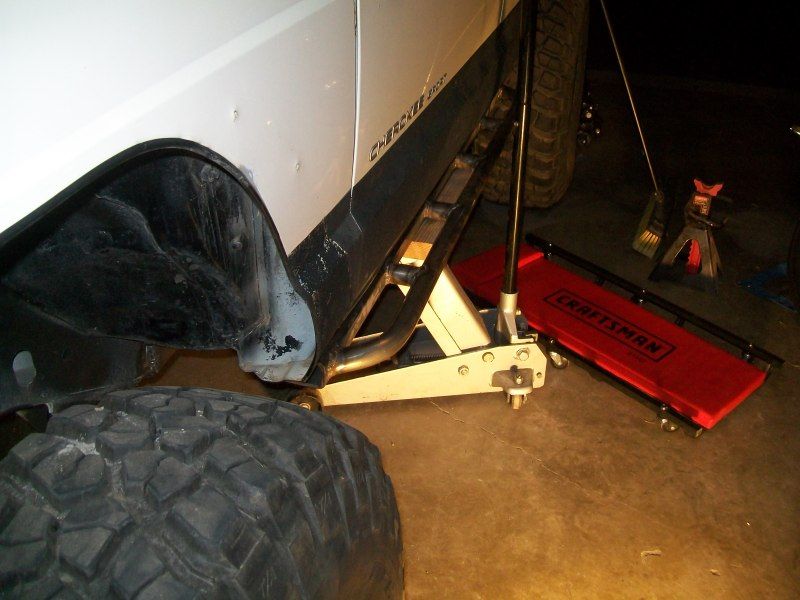

got them level and welded the slugs to the slider..now ima pain them and then weld them to the frame hopefully sometime next week. I welded them here at the shop with the big welder.

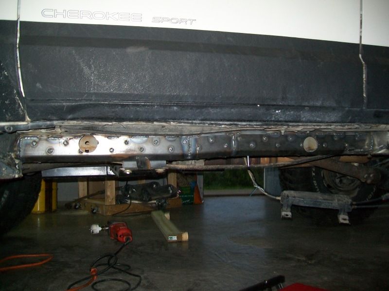

got them finished fully welded primed and painted this pic shows the slugs
and donesky!!!! wanted to do somethin different so I painted them white!!!
