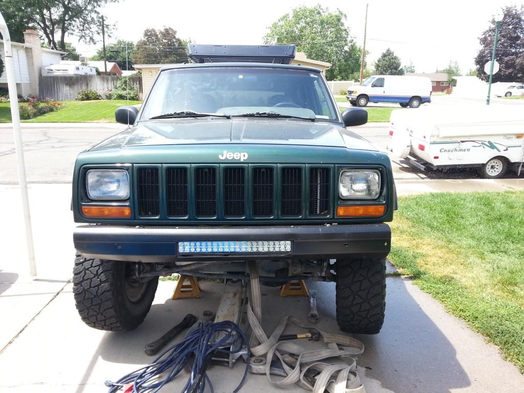

The main problem that you can see from the pictures above is that the arms cannot compress down to stock length. They cannot even get short enough to accommodate a 3 inch lift. I installed them on one side and it pushed my axle at least an inch forward.
I was to lazy to take the tire off to get a good picture, but you can kind of see it here:
I decided not to continue installing them due to this issue, so It has been sitting in my driveway on jack stands for most of the week.

As it sits now with the stock track bar you can see how far the axle is shifted:

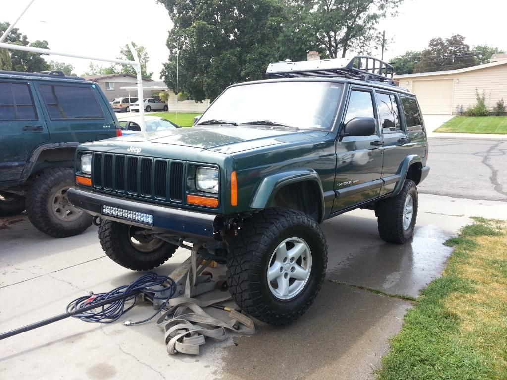

My poor Jeep will be sitting like this for another few days...
Also, I think I forgot to mention that I picked up a roof rack a few months ago. I have it mounted to my stock cross bars at the moment.

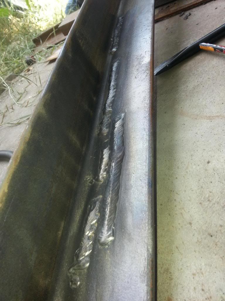

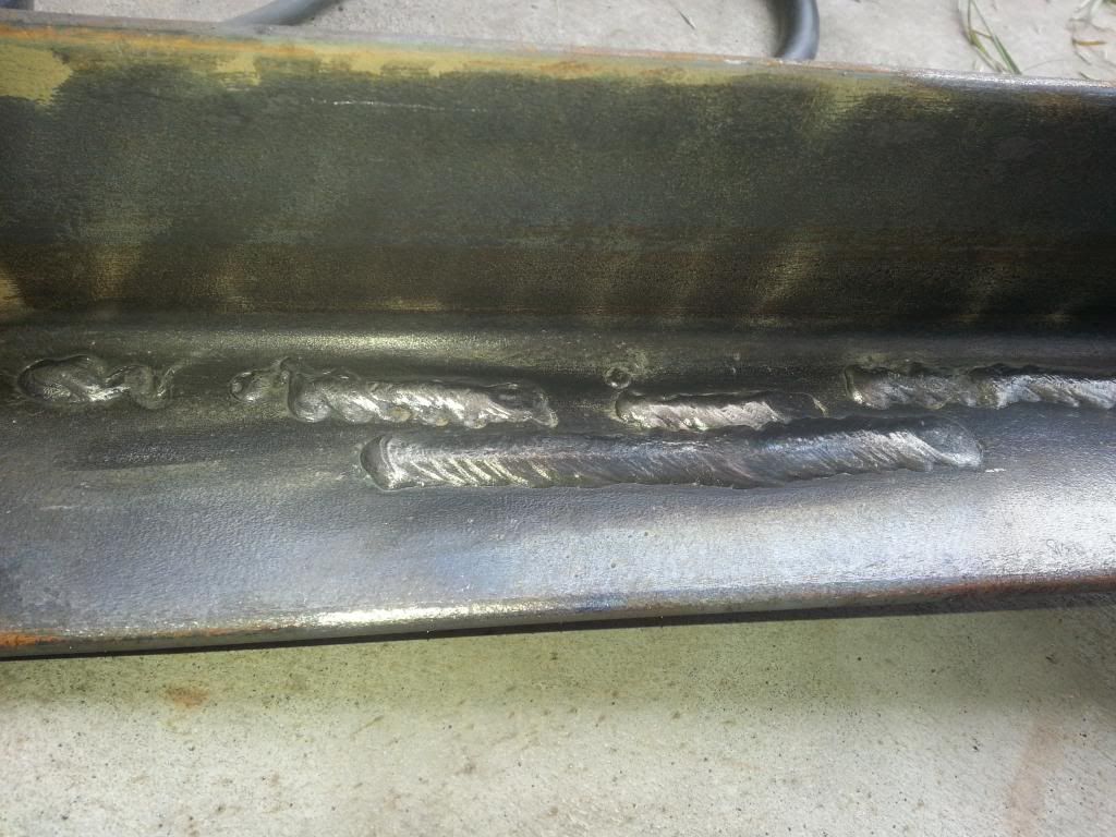

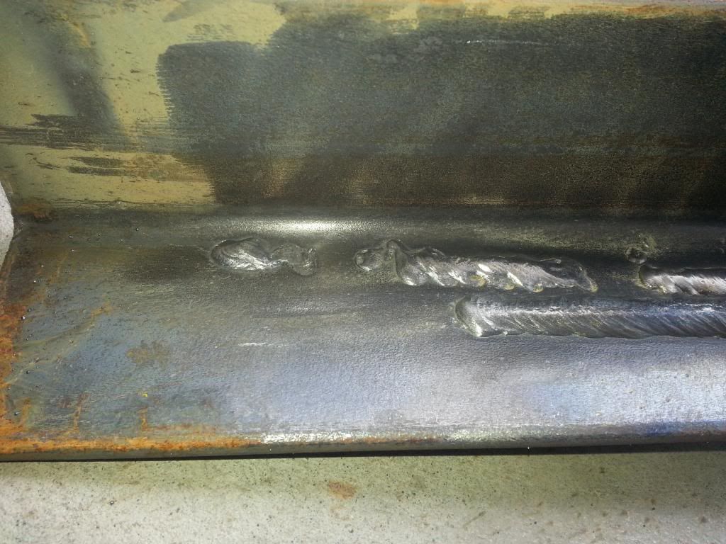

Totally unrelated, but a few months ago I bought a MillerMatic 211 and accessories. I will be posting pics later of my setup. I have not done any structural welding, and I do not feel comfortable welding to my jeep yet, but hopefully soon I will be able to start really fabricating.
My first ever welds with Fluxcore.
