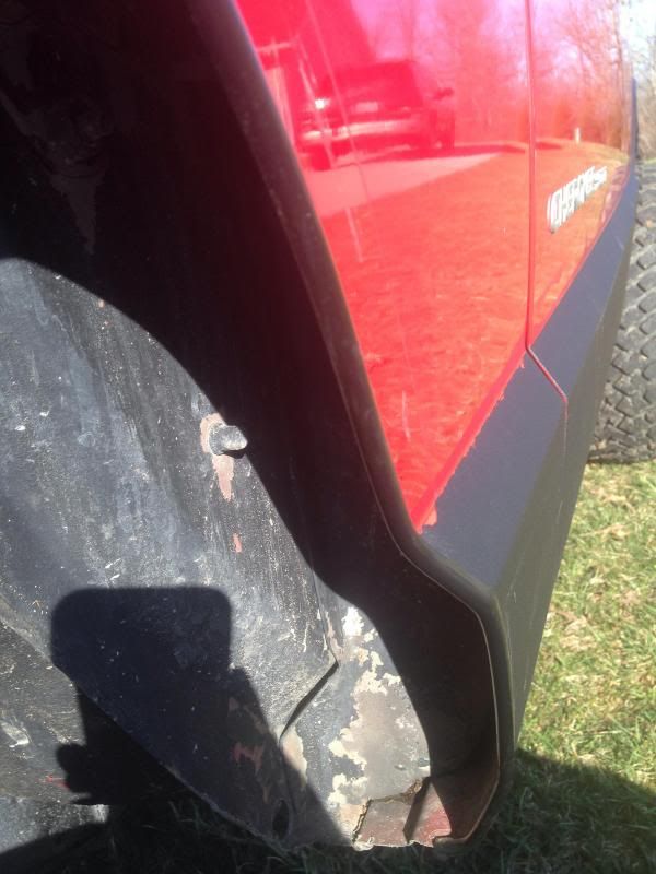

I also bought new JKS sway bar link because the ones I bought used were way to long for me. The left nice little puncture holes in my wheel wells....
