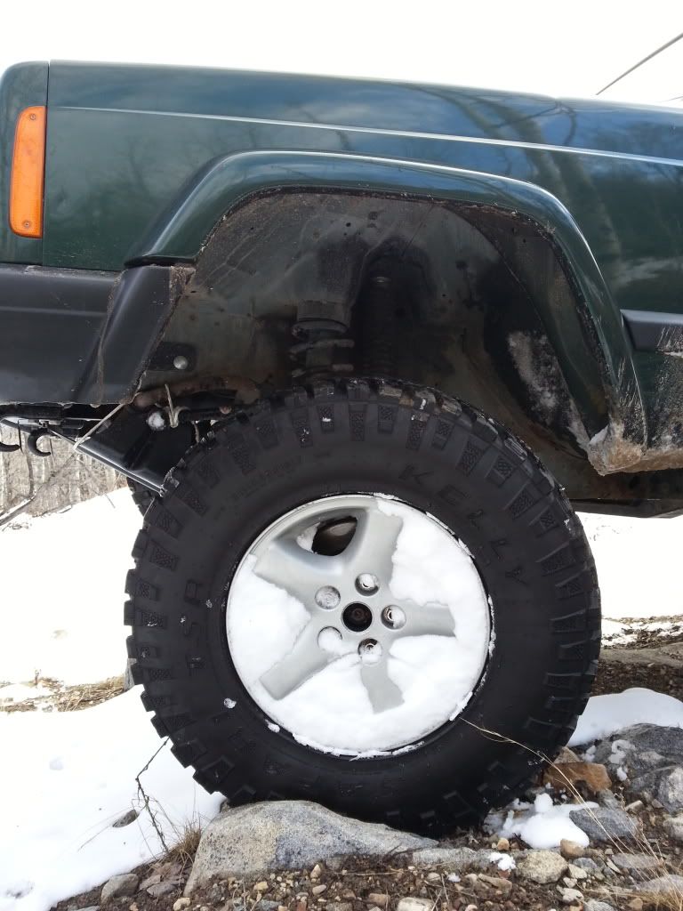

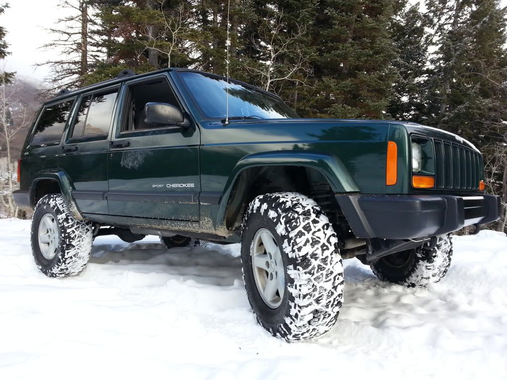

I have a mod or two left to post about until I am caught up, but yesterday I did some snow wheeling and wanted to share some photos.
Starts at Wasatch Mountain State Park and the trails wind up through the mountains. There was probably a good 8-10 plus inches of snow when I got higher in altitude. I was by myself so I didn't do anything I couldn't get myself out of.
These tires are awesome in the snow.
My puppy absolutely loves the snow, and now that my tires can handle it off road I think I will enjoy this winter more as well.

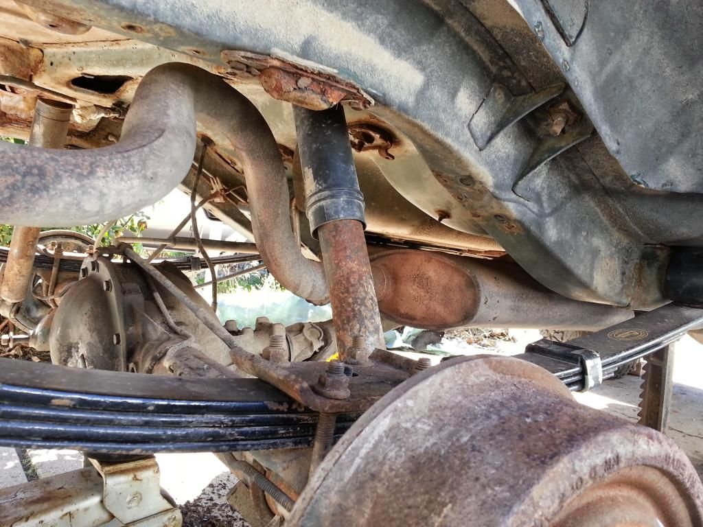

My stock exhaust has been really troublesome since the time I owned the jeep. There were some rust issues and still is in some places, but the hangers were pretty much gone. After some good dirt roads and wheeling the exhaust dropped down and was being held by the header, the hanger in the back, and the cross member. I had several leaks in my system, and I also wanted more sound and to free up any power due to the stock exhaust.
I wanted something that had a good rumble or growl to it, but was also not super loud and raspy. I literally took over a year to decide. After watching videos and reading reviews I settled on Magnaflow. I ordered through Performancecurve.com and below is the invoice:

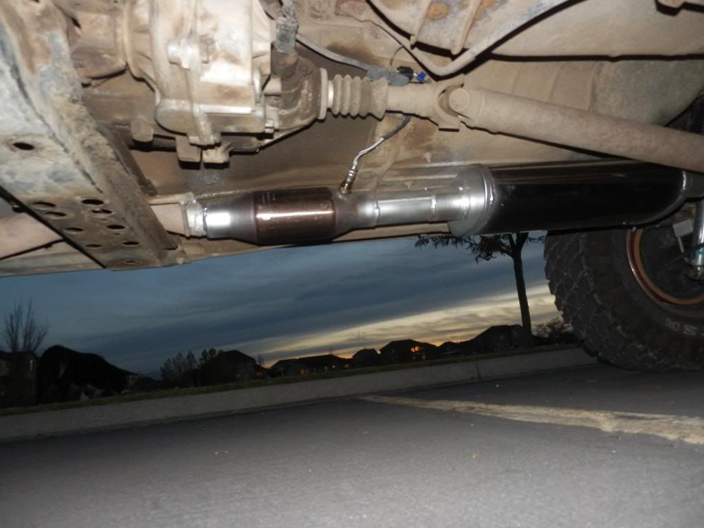

I wanted this muffler since I had heard this video on YouTube. This is also the Cat that PerformanceCurve recommended for the XJ.
I took it to my local muffler shop and had it all welded up since I like things done right the first time. They did break the O2 sensor after the cat trying to remove it because it was stuck.
The exhaust looks amazing under the Jeep. To be honest though I did not like the way it sounded. It was really quite, and just hummed. It also smelled really bad. The smell burns off after a while, and as the internet claimed the exhaust note has been changing pretty much every time I drive it. It is deeper and more rumbly which is exactly what I was looking for. There was little seat of the pants performance gains, but it does breath better. In higher gears it doesn't bog down like it used to. It is all stainless so I am not worried about it ever rusting again. I have really liked the new exhaust.

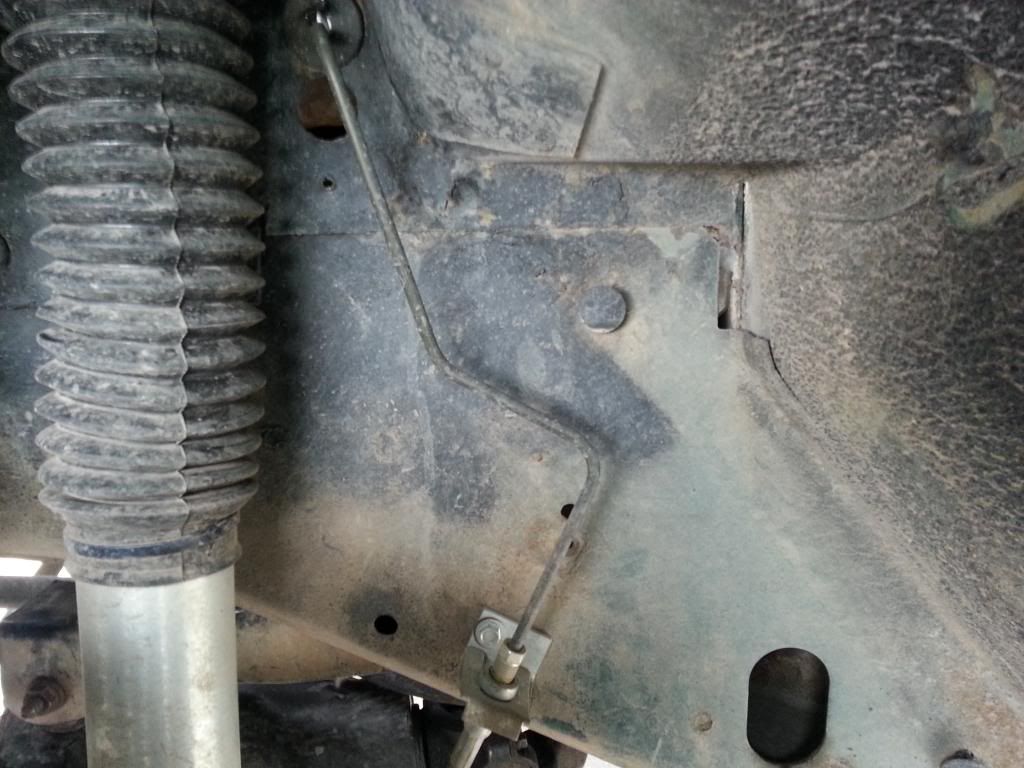

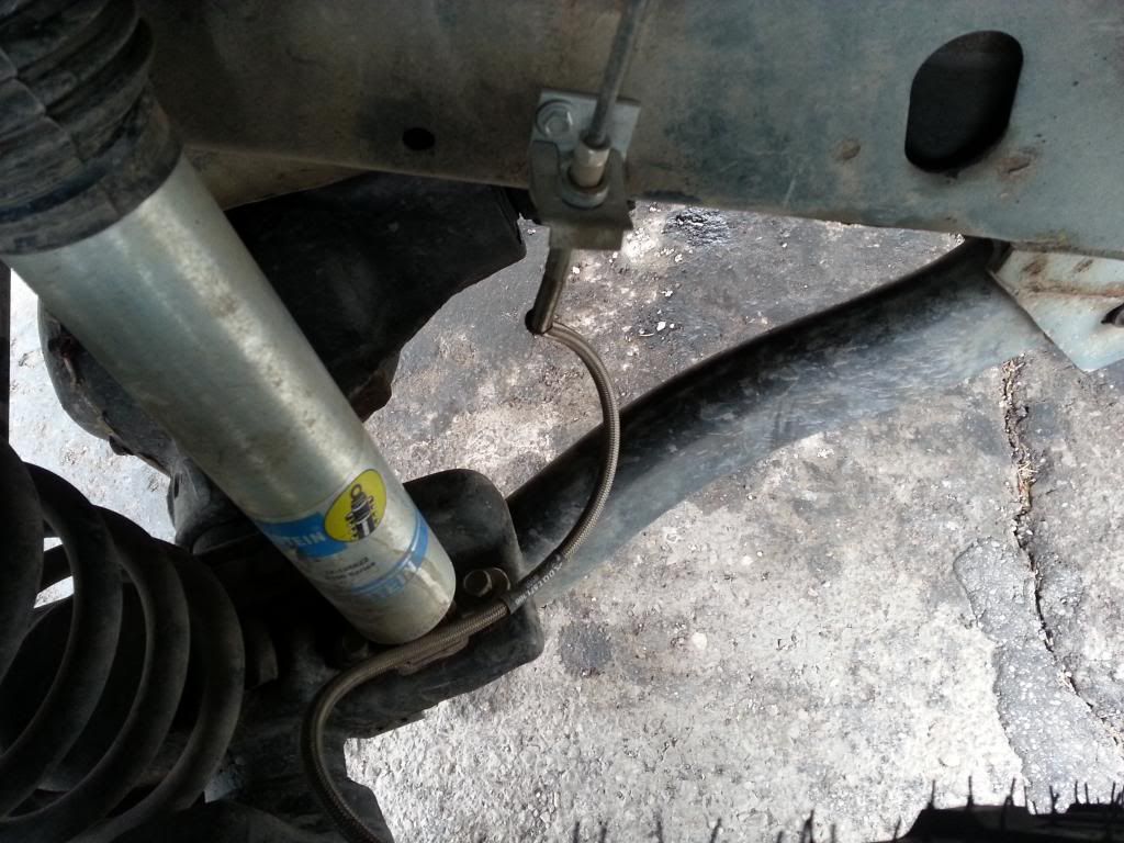

I bought a set up RE stainless steel brake likes from Quadratec at the same time I got my bump stops. Brake lines are generally pretty easy, but with the rust issues I had had the hard line decided to come off with the old line.
Luckily I stated with the driver front tire which is the closest to the brake system. I picked up a small hand held tube bender from Harbor Freight, and about 20 inches of pre flared tube with fittings. I bent it up and remounted it with the hardware included in the kit. Bled the system and it has worked perfectly for quite a while now.

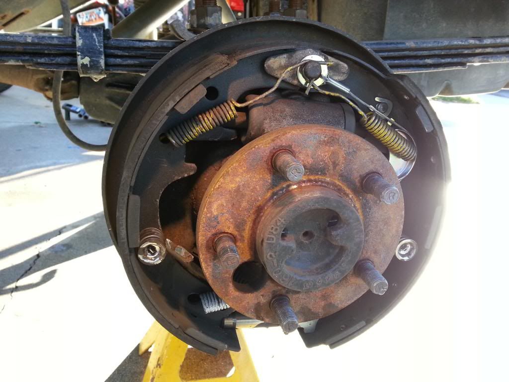

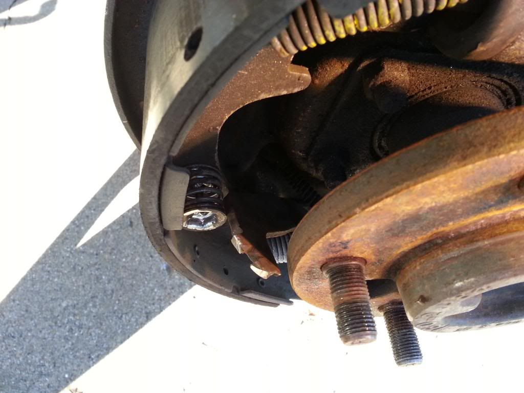

I rotated my tires today, and retorqued the u-bolts and check my brakes. I found that the bar that goes across the top of the drum brakes had fallen down and was just chilling. It had been worn down pretty good, but luckily was still usable. I think that this is what was causing the noise in my rear end and not a wheel bearing. This is why you dont ignore strange noises, and no the radio doesn't fix those noises.
I decided since I was going to be tearing down the brakes anyways that I might as well just get my e-brakes working as well. I ended up redoing the drums a few times because the dana 44 cables are the exact same length which does not work. The e-brake mechanism is mounted on the drivers side and this makes the drivers side cable to long, and the passenger side cable to short. I had to take the cables off of my 8.25 and install them. This is why I had to redo each drum at least twice.
It is really nice to have my e-brake back. Driving a manual without an e-brake is a little frustrating. I was also excited to get this done because I am going wheeling Sunday with some local forum members, and an e-brake can come in handy.
