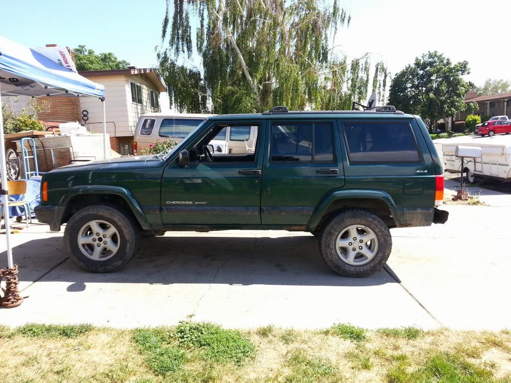

This was in 09/12 when I first bought the Jeep. Completely stock.

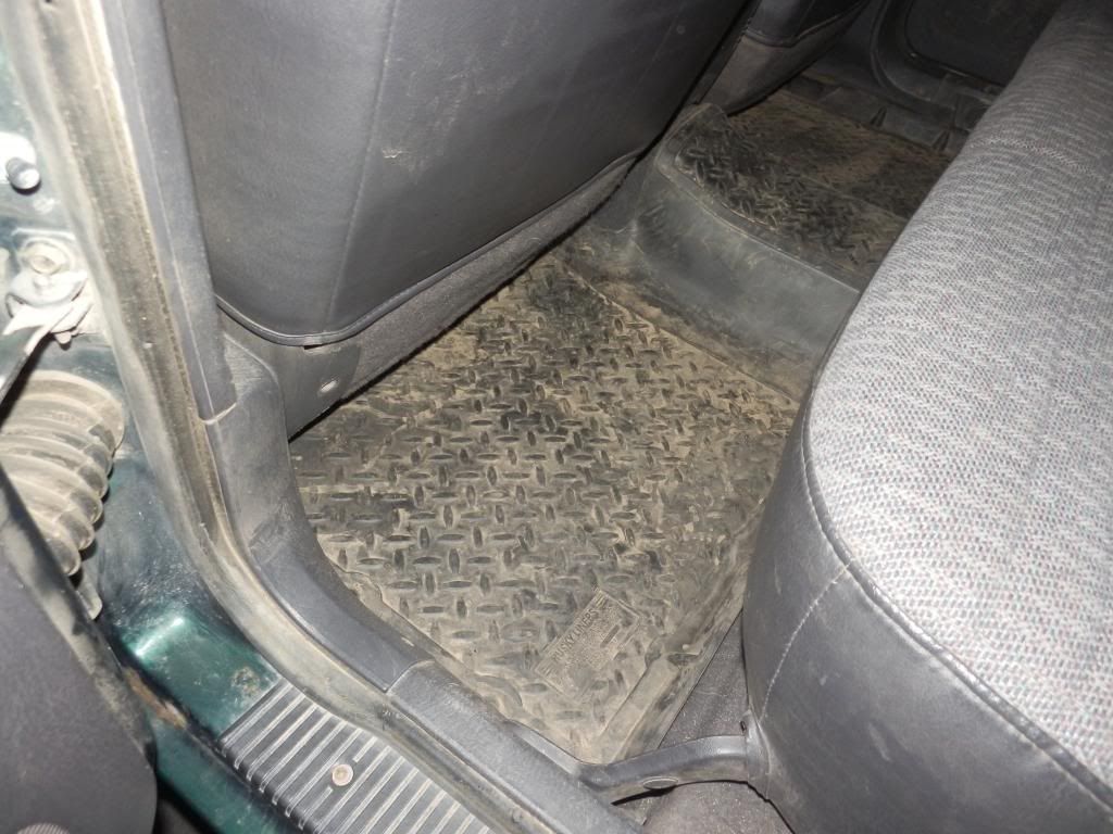

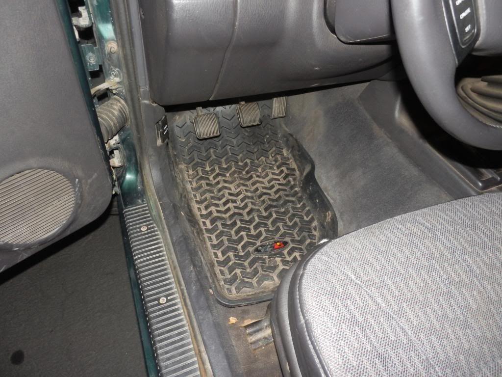

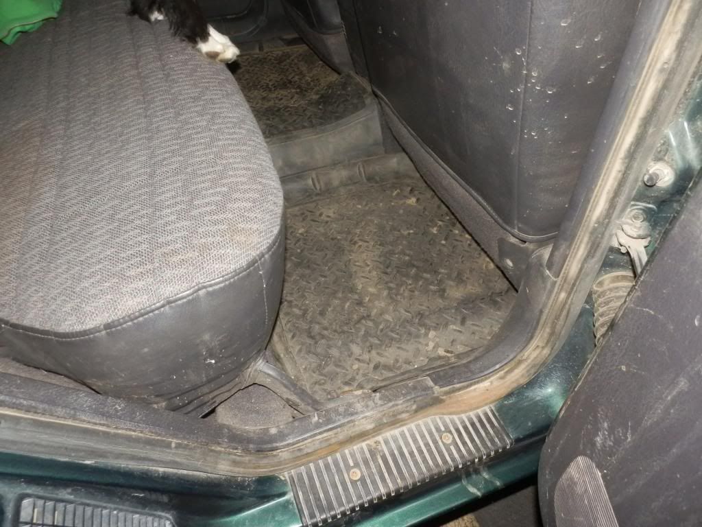

10/01/2012:
Price: $80 front and $80 back

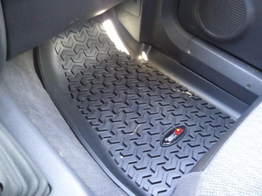

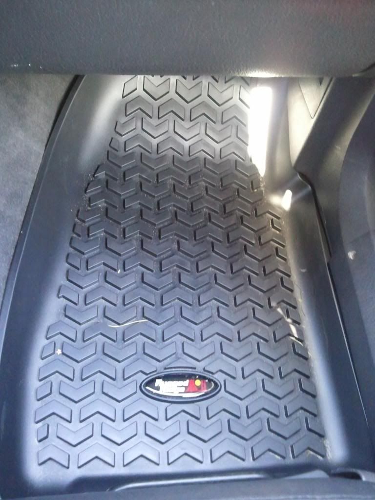

I wanted to protect my new XJ so I installed Rugged Ridge front floor pan and Husky liner in the back seat.
[/URL]"]
I really love the front liners. They are super sturdy and very good at keeping the floor clean. The rear liners are decent, but they are very cheap. I wish that they had the Rugged Ridge pan type when I purchased these. They do a good enough job, but they feel cheap and do are nearly as good as the fronts.

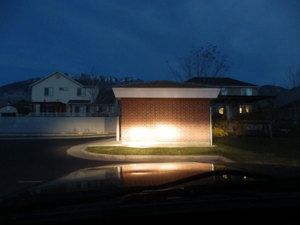

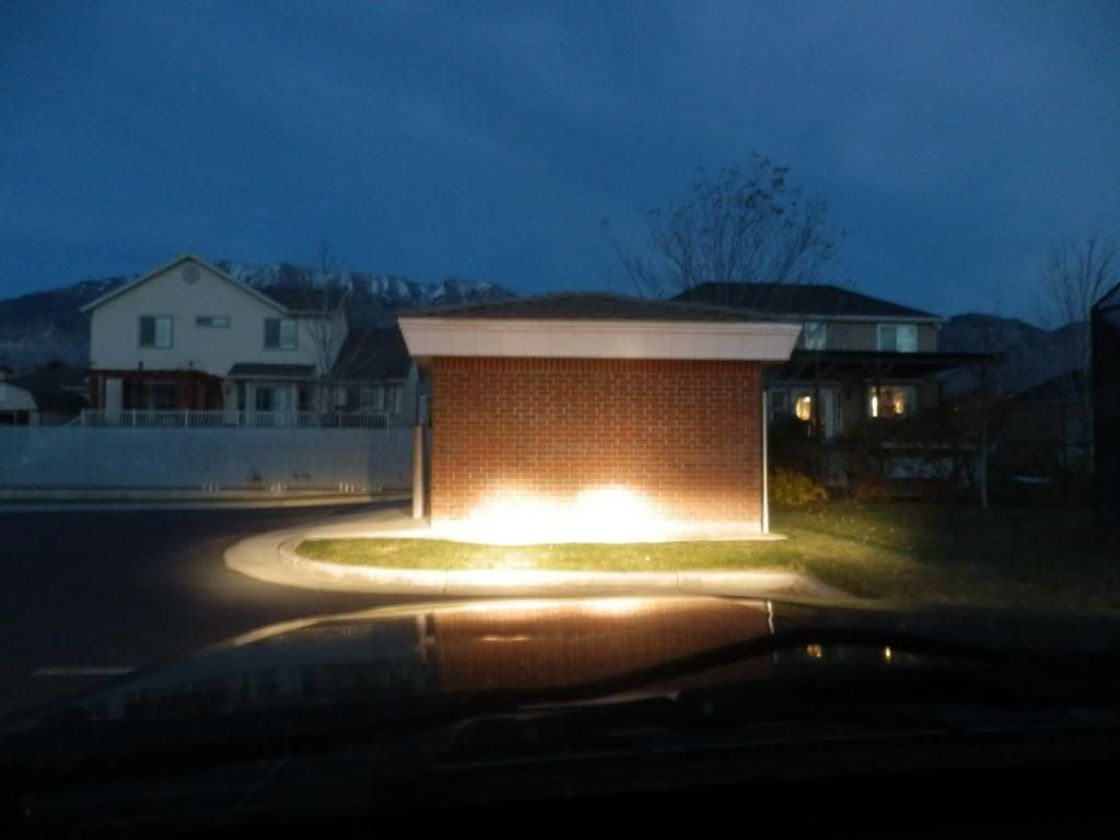

We all know the stock headlights on the XJ are pathetic. I got the best beams I could which were the Sylvania SilverStars. They were significantly better, but still lacking.
2/15/2013:
Price: $40

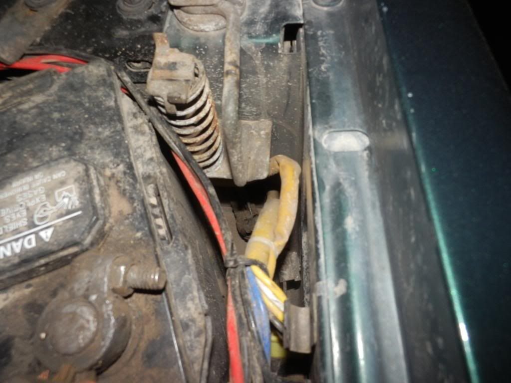

Installed the headlight harness upgrade. http://www.eautoworks.com/Putco-H4--...s-PRD7540.aspx
It was pretty straightforward if you know a bit about electrical, so of course I had trouble with it. After a week I realized that a I had a really poor ground on the drivers side causing that light to barely glow. Once I had it installed correctly it made a huge difference in the amount of light and the whiteness of it. For $40.00 this is a must do mod for every XJ owner.
Since I have installed the lights my lift has changed and they are pointed to far down, but here are some of the pictures.
Old Lighting...
New Lighting:
Low
High
Harness Pictures:
This is where is comes out. It goes to a relay mounted next to the battery. It then has a now plug for each headlight.

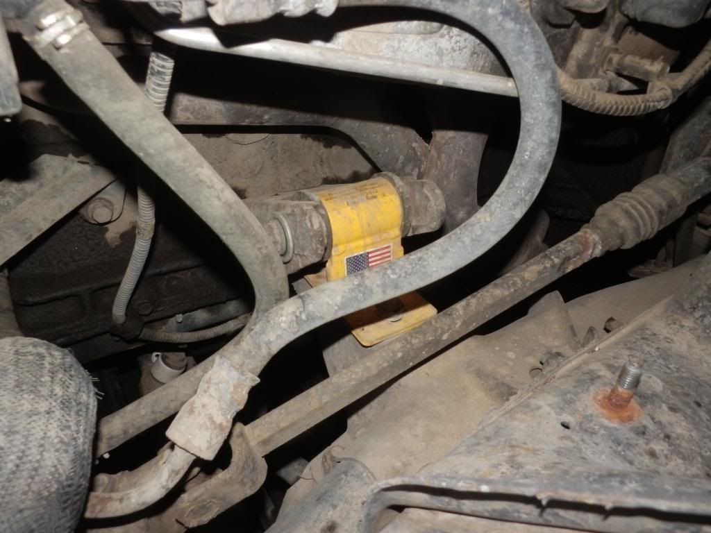

2/09/2013:
Price: $200

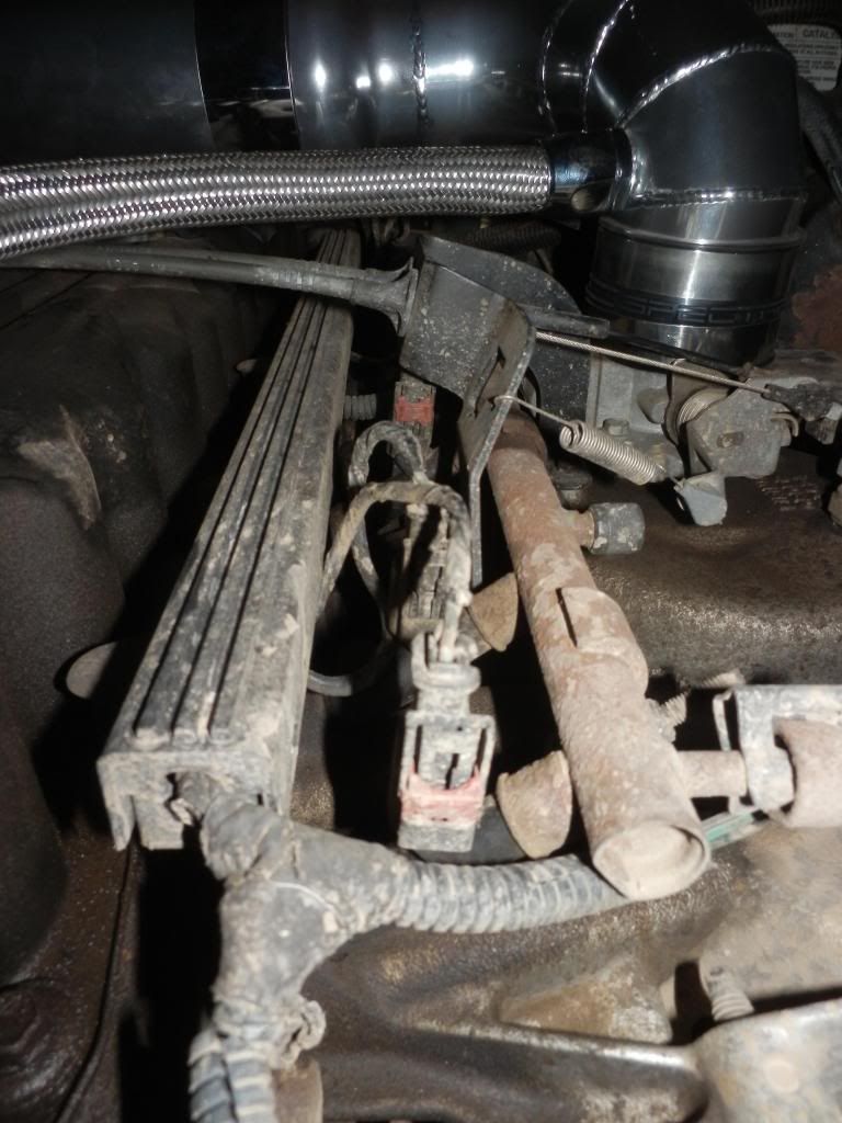

I decided that it was time to do the fabled Injector Swap. Many people get the neon injectors, but I decided to purchase the set from PrecisionAutoInjectors. http://precisionautoinjectors.com/pr...fuel-injectors
The Good:
The customer service was good, shipping was fast. Installation was super easy. There are so many guides that I didn't bother with a write up. I could immediately tell that the jeep was more responsive. I don't think there was any significant increase in power, but the response made this very worth it.
The Bad:
From the first time I turned off the engine the Jeep would take longer to start. I would have to let it crank over many more times before it would finally catch and start up. Once it did it worked fine. I tried contacting him the same day I installed then and he would not work with me. I made several attempts to call at different times of day, and many emails that he never responded to.
I filed a chargeback with Paypal and he never even contested it. I got my money back, but I really only wanted a working set since I loved the way they performed. When I was trying to identify the issue I took the fuel rail out of the engine and pressurized them. The immediately built up a bead of gas in the tip of the injector. I was seriously concerned that this would wash my cylinders if left so I installed my old injectors again.
My father was not concerned about the hard start or the slow leak since they were not pressurized while the jeep was not running so I helped him install them. They worked fine for about a week and one day his jeep struggled to start and would run like it had a terrible misfire. We took the fuel rail off and pressurised the rail and one injector sprayed fuel into the middle of the street. We had washed his cylinder, but luckily we were able to restore compression and his jeep is still running okay with my old injectors.

I had ordered a new set of injectors from fiveomotorsports.com and the install was even easier since I had taken the others in and out several times to identify the issue. Performance as the same which was excellent, but it also started up perfectly. I have had them installed since then and have never had a problem.
Doesn't look any differnt

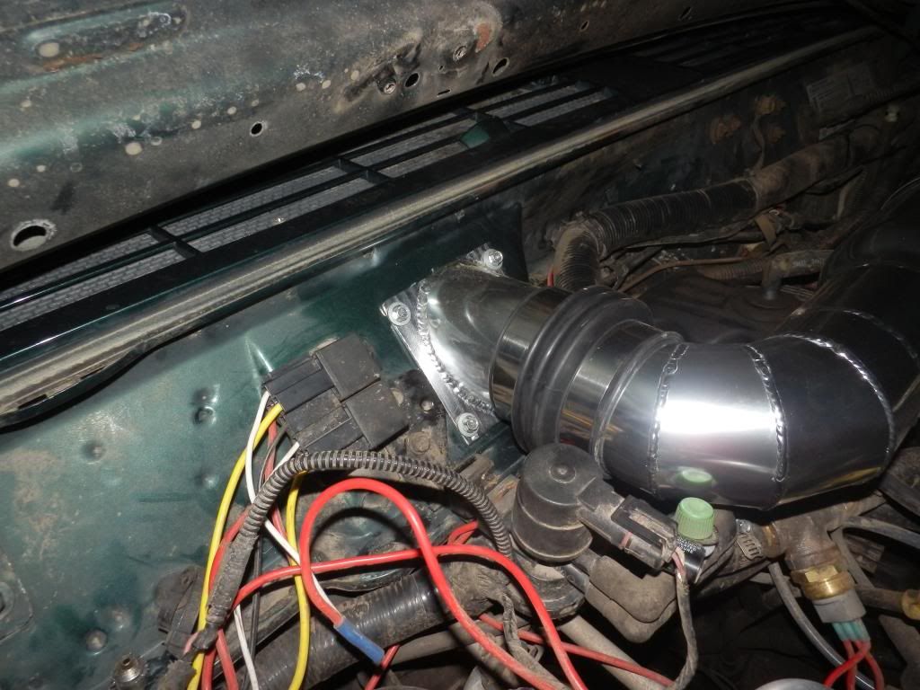

4/1/2013:
Price: $100 after core return
I installed a bored throttle body from StrokedJeep.com. http://www.strokedjeep.com/tbody.html
I got the 63mm Tbody and the gasket. The install was super easy. I don't feel that I gained any horsepower, but this again increased the responsiveness of the engine. I mailed back my old body as a core charge and he sent me the refund. He was very professional and good experience.
Didn't take any pictures of the throttle body itself because it didn't look any different externally.

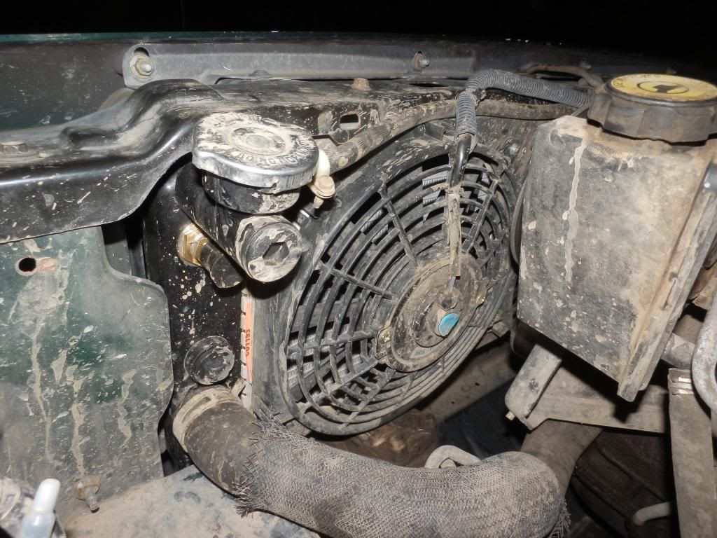

4/20/2013:
Price: $240 for fans, $50 for the controller and do it yourself wire harness. probably $20 in other wire and connections.

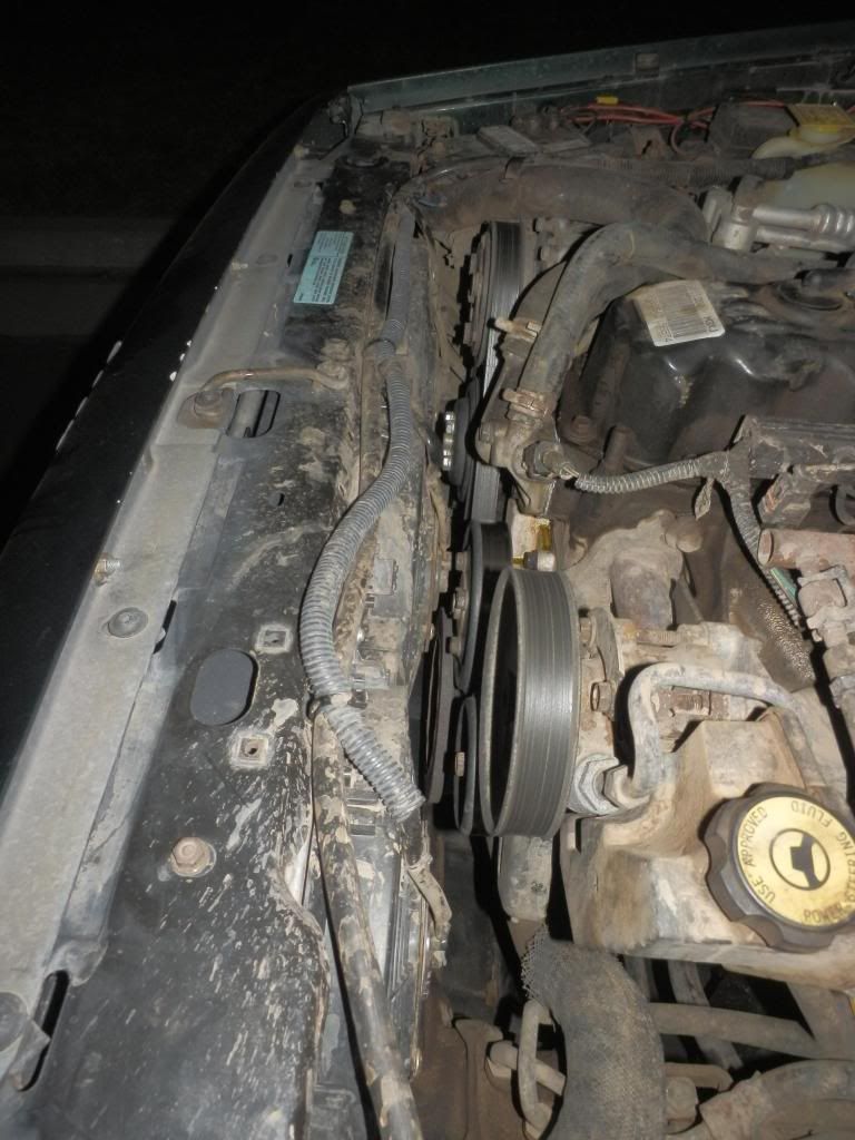

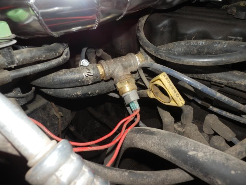

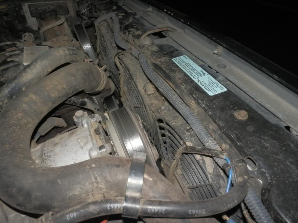

I replaced my stock mechanical fan and efan with the DirtBound Offroad efan set up. Fan Kit Looking online they have changed quite a bit and the prices are much higher. I also got the Fan Control and wire yourself kit for the 2 stage set up.
Install:
As usual I had some difficulty with the wiring. I have been meaning to clean it up, but I have been lazy.
Removing the mechanical fan was easy enough, and they provided the shorter bolts to replace the studs that hold it.
Everything came separate and I had to assemble the fans onto the shroud. You have to take a few parts off of the front clip to secure the shroud mounts. This was really easy so no problem. You then use some self tapping screws to secure it on the bottom of the shroud.
I had to call DirtBound a time or two during the install for electrical questions, but I got it all figured out eventually.
I had to splice the fan controller into the upper heater hose which was not a problem, but I do advise that you wait until your engine is on the cooler side.
Review:
The cooling with these fans is fantastic. Not needed for higher speeds, but when moving slow they never let the jeep get hot.
After about a week I noticed a grinding noise when accelerating and when I looked under the hood i could see that the old mechanical fan mount was digging into the back of the fans. The problem was that the screws that hold the fans onto the shroud did not stay secure and backed themselves out in combination with my worn out motor mounts.
Of course this was not realized until after a fan had came completely loose and fan against my engine and broke to pieces.
I was able to work with DirtBound and the provided a replacement fan and missing hardware. I used Loctite on every screw and it hasn't been a problem since. I have also replaced my motor mounts to stop it from contacting, but that will be a later post, actually next post. I don't have any pictures of the install or before, but here is what I have taken of them installed.
Controller

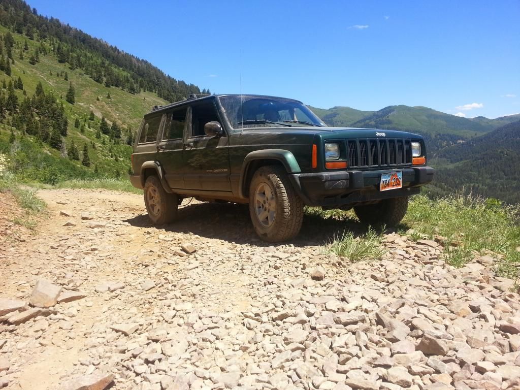

Trip Report
I took my father and puppy up American Fork Canyon for an early birthday present to him. We were going to try Forest Lake, but there was already a large group heading up there and we didn't know if we could make it in my stock XJ with no recovery points.
Mineral Basin was also out due to the fact that I have no recovery points at stock height.
We found a road that looked promising and we just drove. We took each possible turn off then continued till there was no road left.
It was really quite fun, and I got to take some pictures since I let my dad drive most of the time.
Map of the route.
