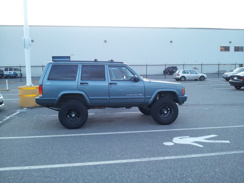

[IMG][/IMG]
Definately a lot of beautiful blue XJ's runnin around here in the PNW! Here is mine and I just saw a similar one and a stock one yesterday. Both blue. I will be rereading your great thread for ideas!

I haven't seen too many blue ones, so I get compliments all the time about the color. Yours looks incredibly clean...are you going to keep it that way or put it under the knife?

It always happens when I get a new car, I always start to see them on the road! Just saw another blue one yesterday.
I plan on keeping it this way for the most part. It is very clean and I can't see modifying it too much. I am the second owner with only 94k babied miles on her. It has the K&N, Flowmaster and some other little goodies already. The lift is Acos-OME. I have a 8-1/4 rear w 4:10s and posi to go in but have not had time.I think I will have to do a SYE too. I will reread your build thread for some other ideas. I want to do some light wheeling with her but don't want to risk body damage. I didn't buy it for a heavy wheeler, she just fell in my lap for a good price. I have always liked the cherokee and have loved this color.
