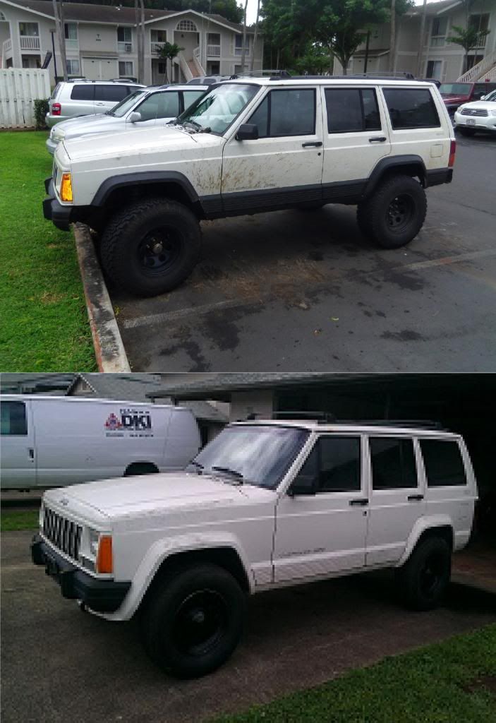

was just looking at the before and after of my xj... pretty satisfied with how its all coming together. it sucks to be tracing down this fueling issue but all in all, i love my xj!! well i love it now... haha not so much before when it looked like a sugar cube on wheels

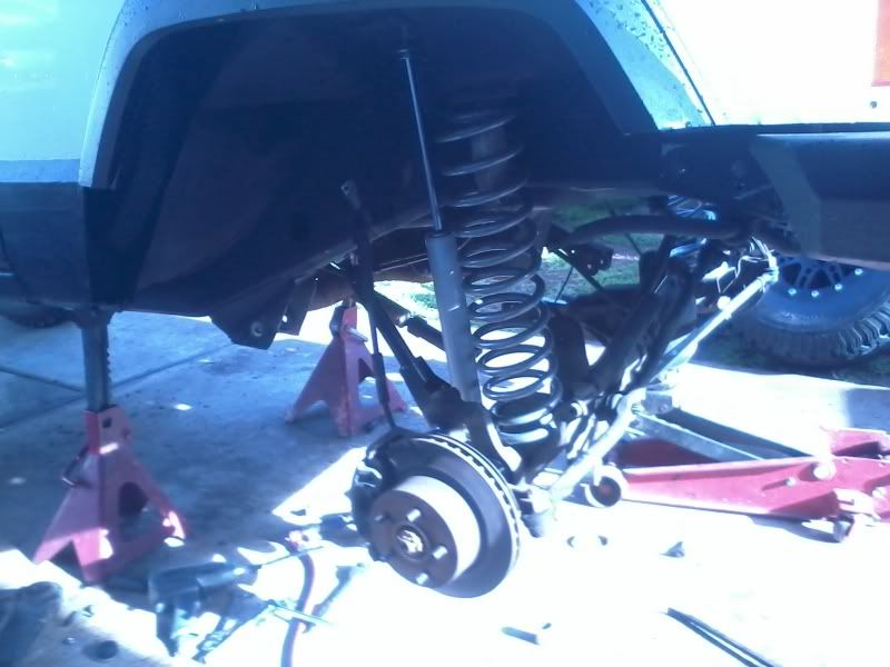

i havent been on for awhile but as an update, ive replaced the entire coolant system (radiator, pump, thermostat, upper and lower hose, new fluid, and cleaned the overflow jug). the jeep is running nice and cool again. i just want to throw a switch on to control the aux fan.
current plans now are to start looking into components for 5-6" lifts (not sure what i want to do about the controls yet), start working on chopping the rear cargo area and then also designing a cage for the inside...

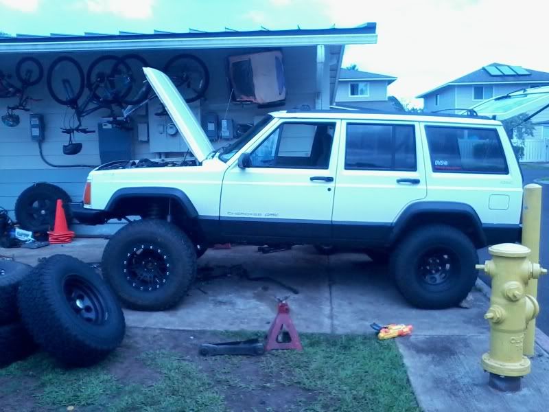

ok so its been a really long time since ive been on here. i have been crazy busy with alot of different things and in my spare time i wrench on the xj... ive come to a point where ive moved on from my unknown problem with my fuel system and started to build it up. i still cant believe i started with this thing as a tinker toy and now its one of the tallest xjs on the island of oahu... the build is still going but since i last posted ive completely rebuilt the cooling system with a new radiator, water pump, t stat, upper n lower hoses, and i cleaned the overflow jug out since it had mud at the bottom. i also put in all new injectors (which did not fix my fuel issue lol), installed a smittybilt xrc front bumper (rear is on back order), took of my 3" lift and installed a 6.5" lift with new adjustable upper and lower control arms, t case drop until i order the extended driveshaft and sye, and also installed a new set of procomp 15" with 33x12.50 bfg ats. before i order the driveshaft though im looking into extending my wheel base so im not sure what ill do with that yet... but more will come!!
