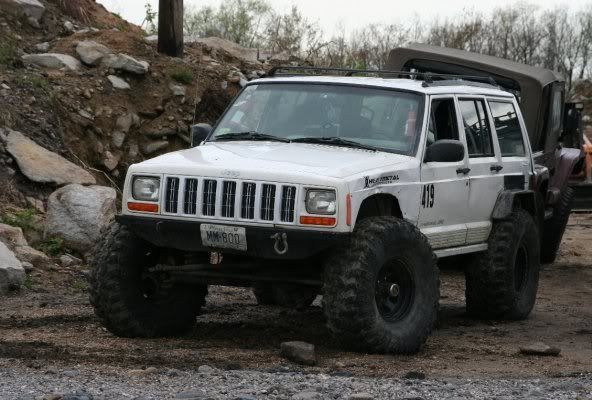

What do want out of your rig? Lcog or Hcog? What kind of trails are you going to be running? You can run 37s on 3 inches of lift with trimming a little welding and proper bump stops. Here comes the hate LoL. RC shocks are there weak link. Do your homework because if you wait around for a definitive answer on here about what to do you will die with a stock XJ in your driveway. I'm new to this XJ area but I got my 06 TJ in 06 and nothing has changed. Update your OP with specific info for better results.

Hmmmm, let me get this straight. 37's with 3" of lift with "trimming," ha no. To run that you need way more than trimming. Keep in mind that you can't trim the rear quarters too much because of the pinch weld. 3"and 33's, okay, 3"and up becomes a problem unless you can fabricate.
Rough county's shocks are most of their problem but their leafs are stiff and each one is different from what I have seen.
You are right about doing homework though...

I said bump stopping which is the most important part. I guess our definition of trimming is different.
Not my rig 37s less than 3 inches of lift per his post.

Bump stopping is not the only thing. To clear them you have to cut the pinch seam and weld in steel in place of it. But that's for fitting them. You also need things to run those 37's also. Its not just a "as long as it fits" kinda thing. A lot more expensive and complicated than just a simple lift with 33's.
