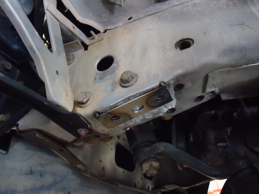

Passenger side motor mount is destroyed!
Driver side is not much better. . .

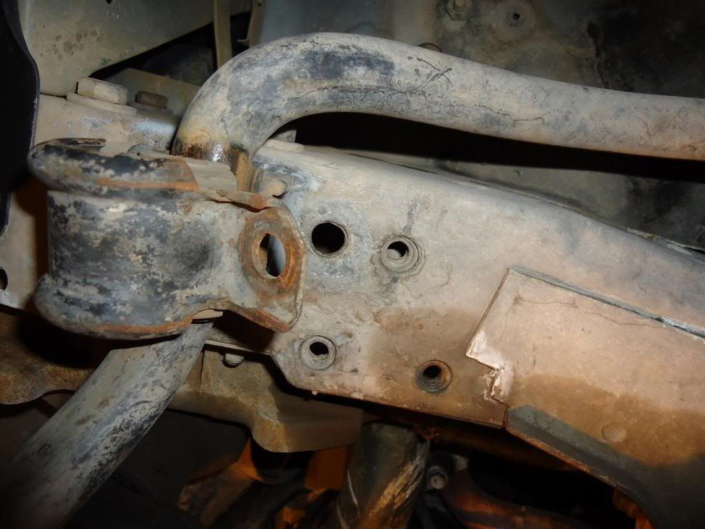

The passenger side mount was a pain in the butt!!
The oil filter was practically welded on so I had to get a little creative, I tried a nylon strap and a pair of vice grips and all that did was dent the filter. So i smashed the filter with a pair of finger grips I use for welding and it came right off!
After this point I removed the memory card and forgot to put it back in. . .

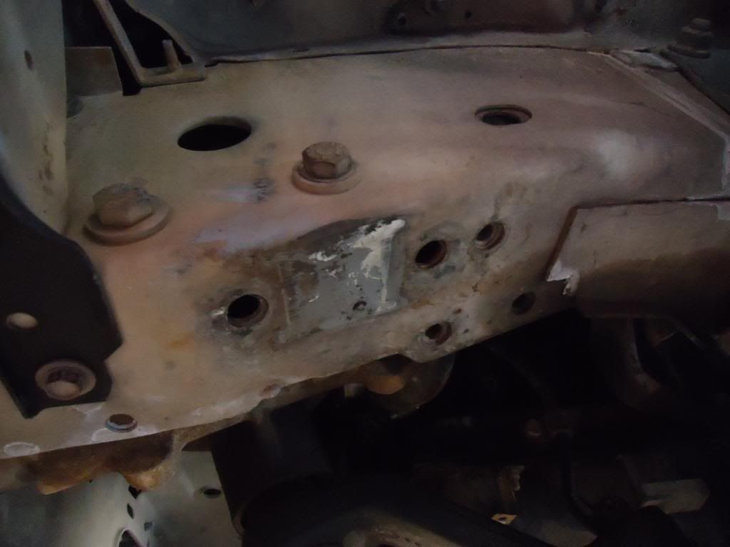

Pretty easy job, Pulled the air box and replaced the driver side mount, then I removed the oil filter adapter and replaced the passenger side mount. Pretty easy job all the way around.

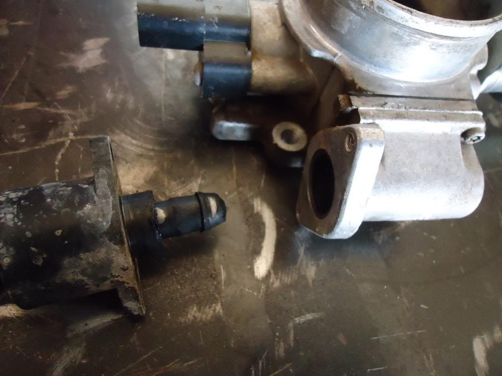

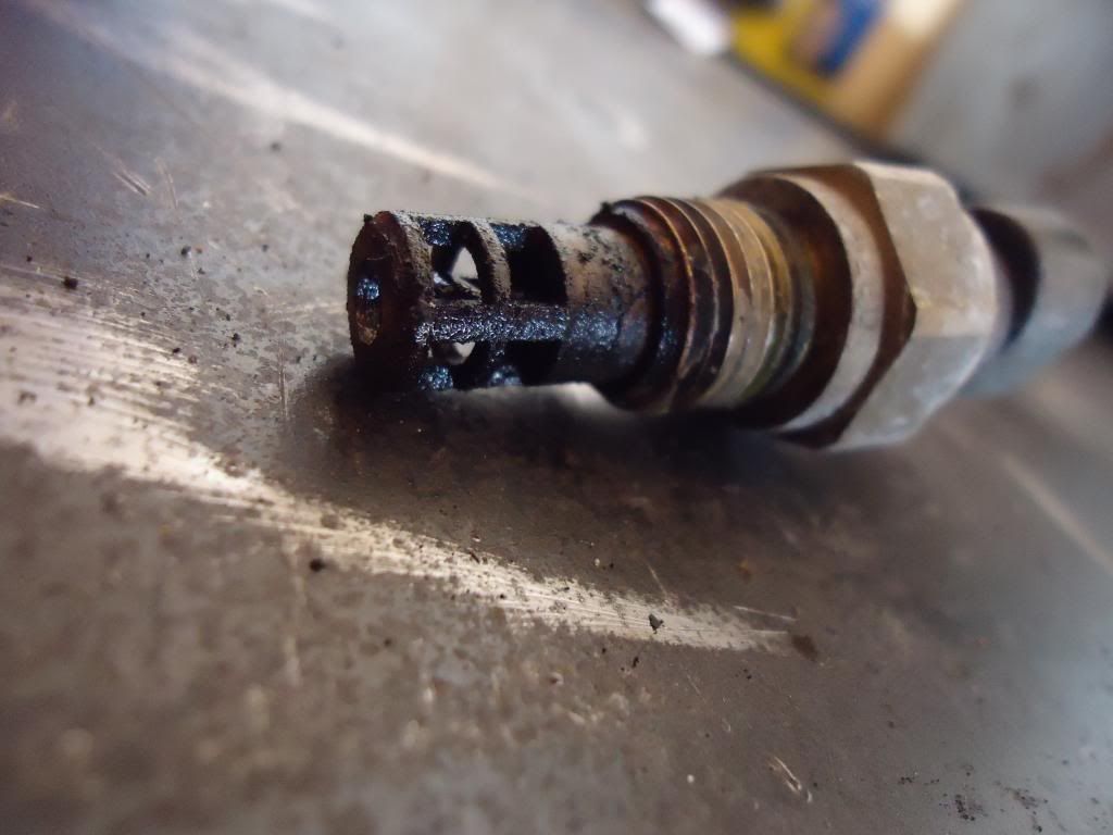

Worked my way over to the passenger side. Removed the oil filter adapter, broke the oil sending unit in the process. . .

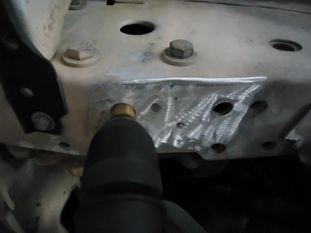

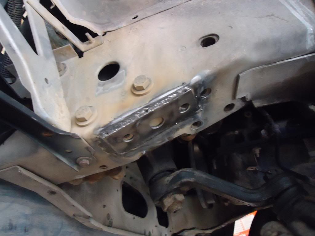

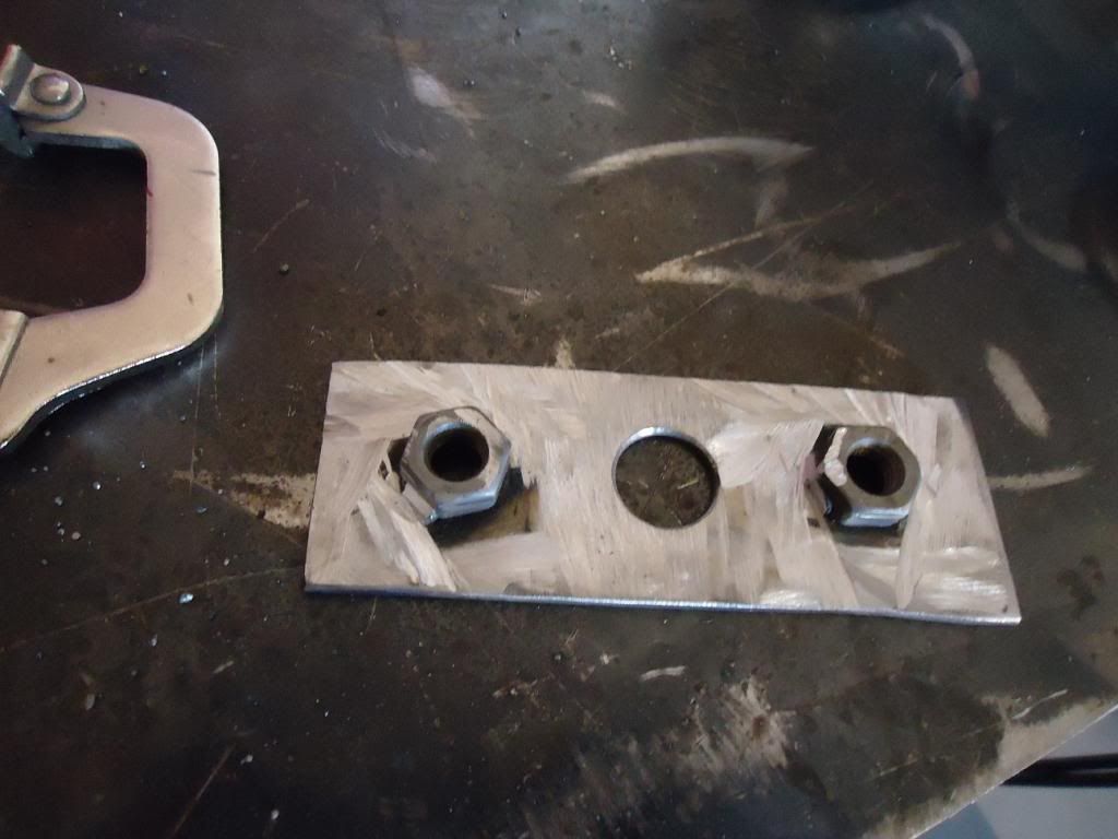

Welded with a harbor freight 90amp flux core welder. Works great! I ran out of wire in this pic, but I finished welding it after I got some more. stay away from the Harbor Freight wire, tips and its a great welder!

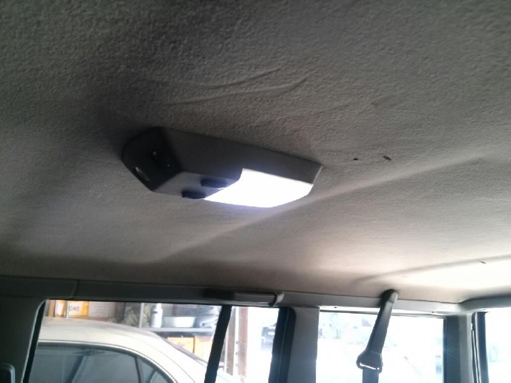

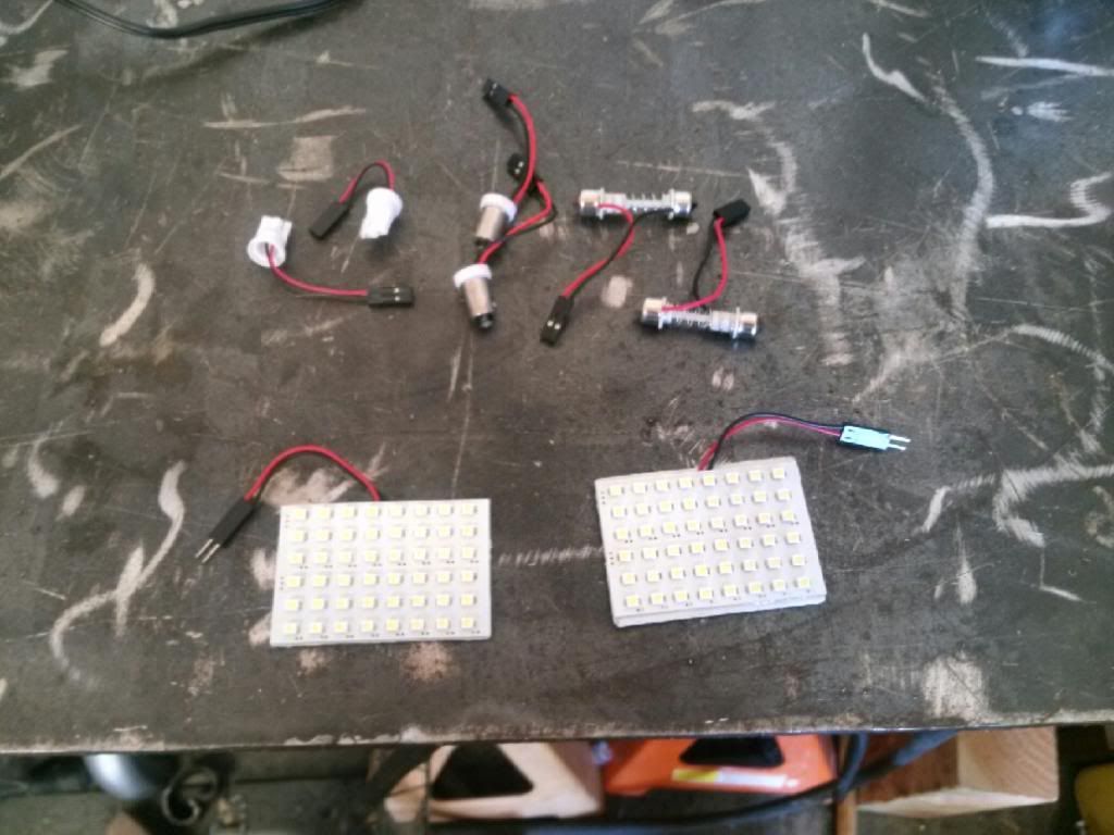

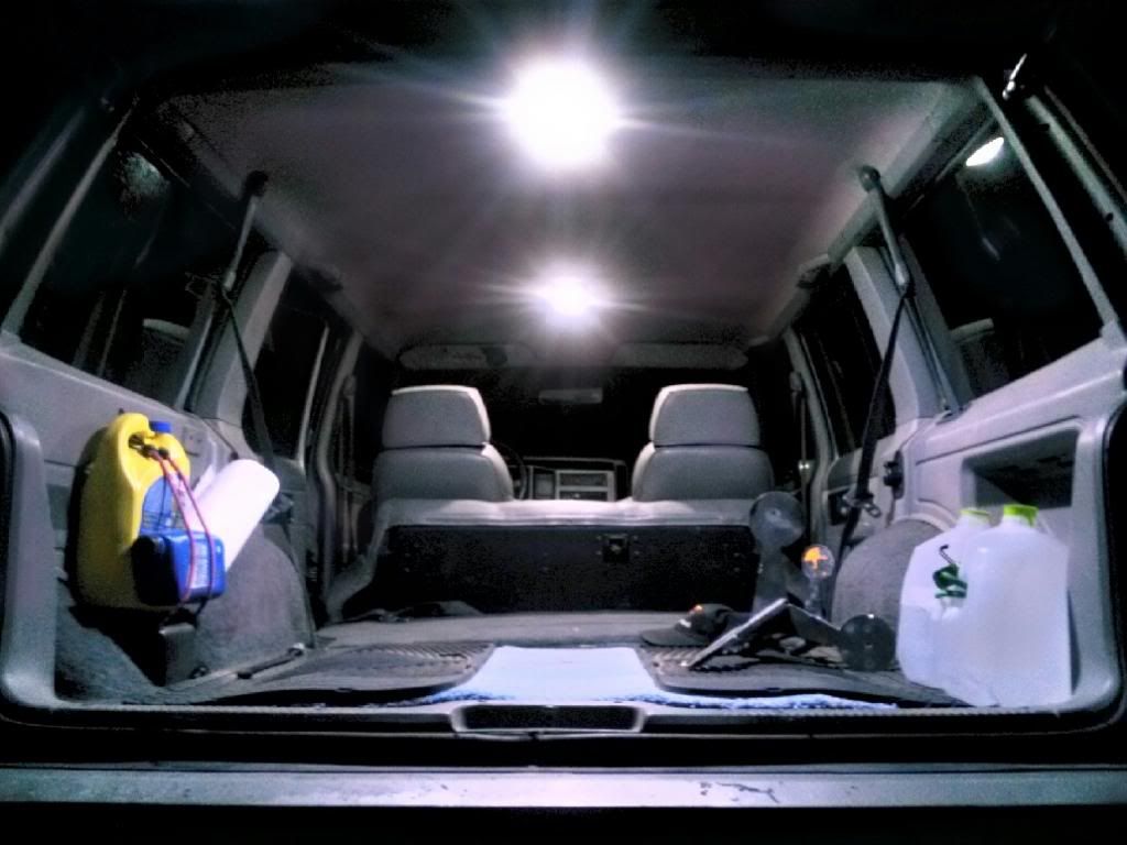

Well, whoever stole my Jeep busted all the interior lights so that was an excuse to get new ones. . . I went ahead and upgraded to LED. Super easy, cheap and bright! Maybe a little too bright.
