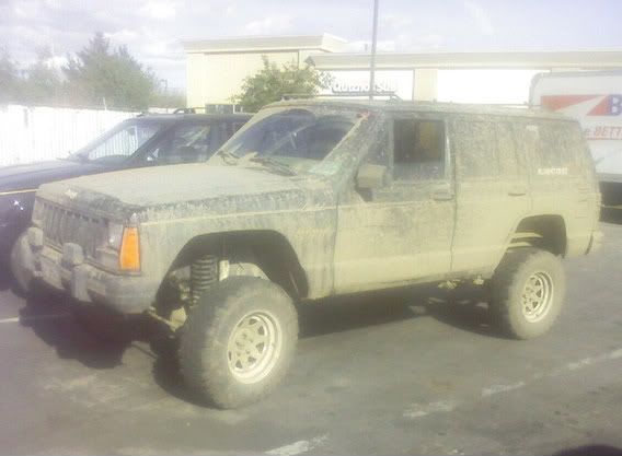

i personally didnt like the way it looked but then again i had trimmed fenders. looks much better with my 33's

look at my pic up there ^ thats 33's with a lot of trim. but theres more clerance than you need really. you could probally do it with minimal trimming just the spots u rub when u turn and stuff nothin big
