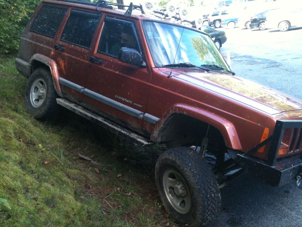

I have 30x9.5 of stock rims with no body issues. The only time you will hit is at full turn on the LCAs. Said tires at at fullest stuff Iv ever had and I never see this much articulation on a trail. IMHO a 31x10.5 would be fine on 3" lift
