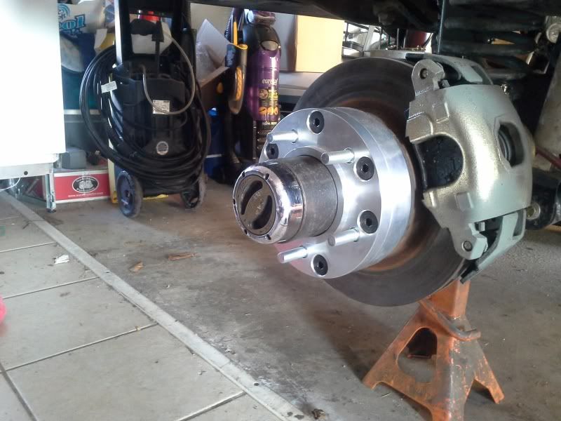

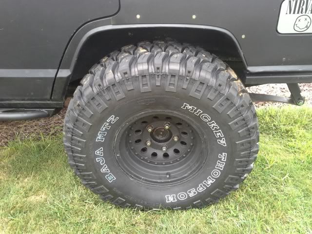

Ok, so here are the wheel adapters installed....

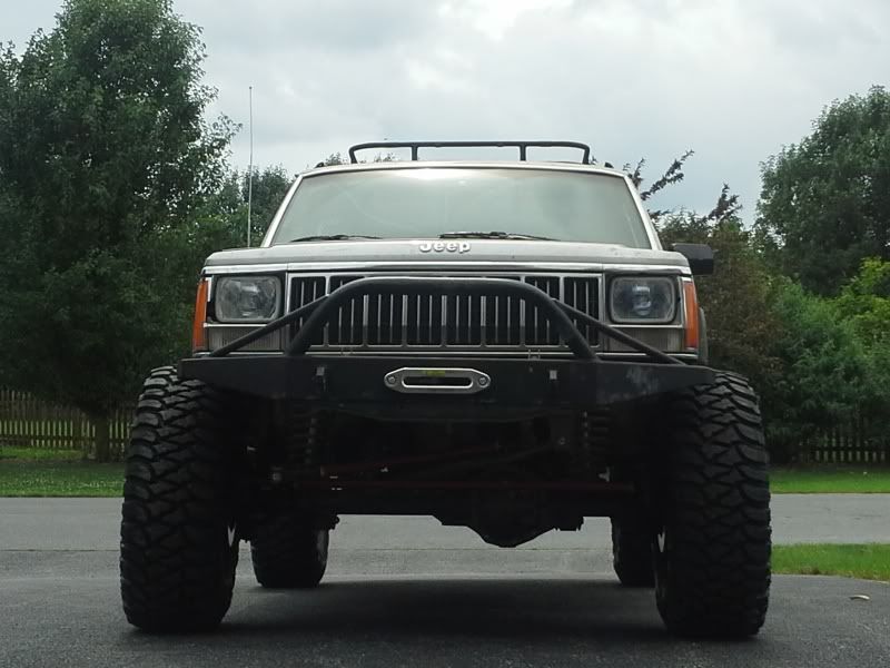

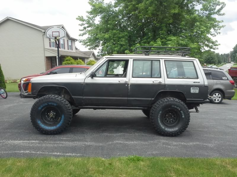

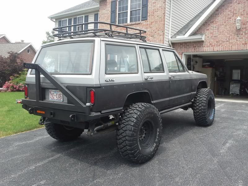

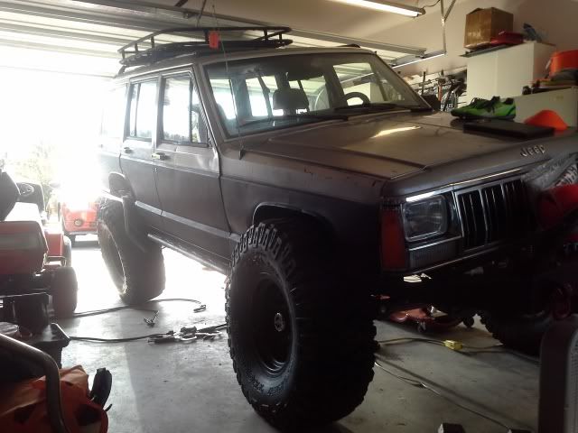

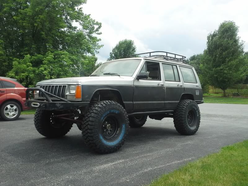

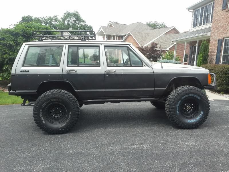

Finally rolled the XJ out of the garage for the first time in TOO long after I installed the 35's, new transfer case with SYE, new driveshaft, and fixed a few small things. I took it for a spin around the block a few times. The mini spool in the rear is going to take a bit of getting used to, but it isn't that bad. I couldn't turn the steering wheel to full lock, because the front wheels got into the fenders. I'll be trimming a lot in the near future. I also got some SERIOUS shaking/thrashing twice at low speed... about 15mph the whole Heep started convulsing. A tap on the brakes and it settled down. Not sure what is causing that, but I know I have a lot of adjustments to make yet. Need to adjust longarms, do an alignment, and grease everything that can be greased.
Thoughts??? Input??? Suggestions??? Let me have it.
*edit* Remember to comment in my other thread. . . link located in my signature. Thanks

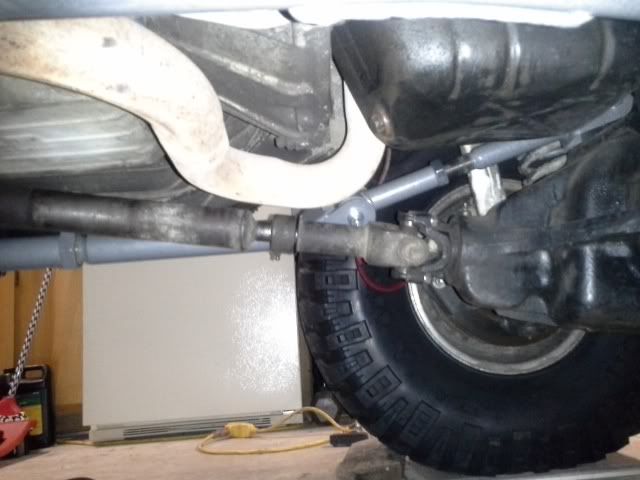

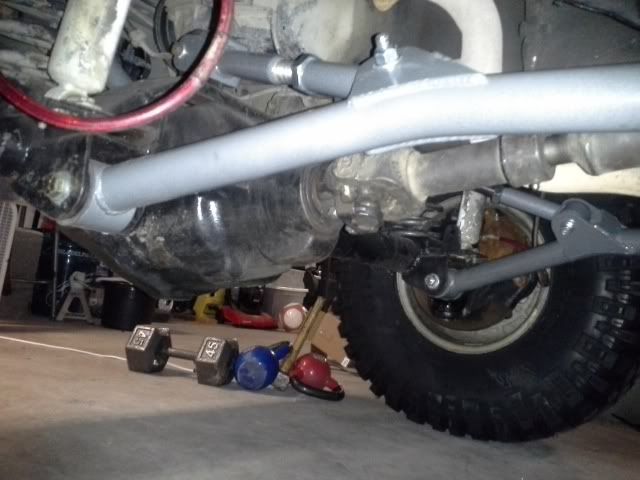

and a few more of steering, longarms, driveshaft, gas tank skid, and winch. . .

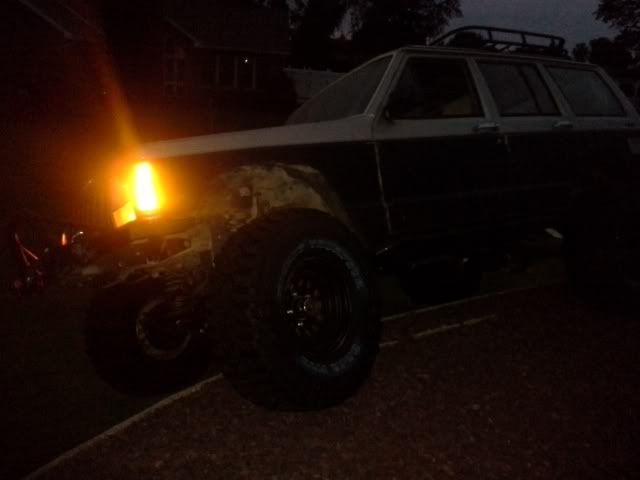

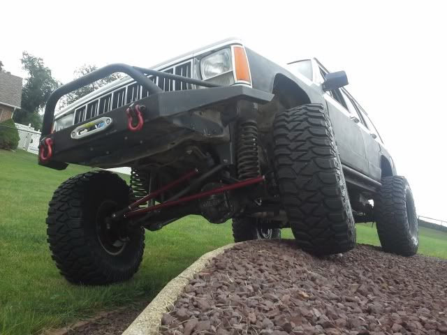

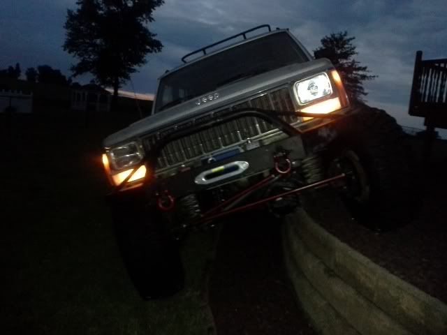

Ok, so I was sitting at the house wishing I had a ramp to see how the Jeep flexes. I was looking at the retaining wall in front of my pool and the light bulb went off......
Sorry the pics are so dark, but I got the idea as the sun was going down and I couldn't wait until daylight..... so this is what you get until I do it again. The wife wasn't very amused. She and my daughter told me they were going to laugh at me if I flopped the HEEP and to not ask them for any help when I did.

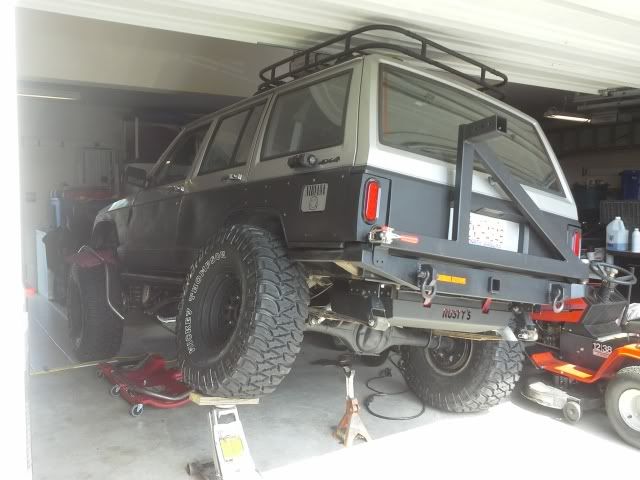

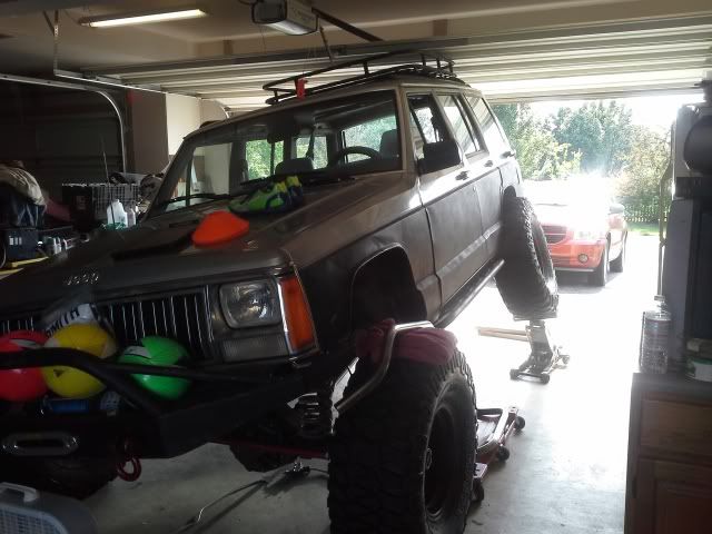

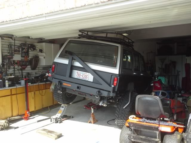

Then a few days later I flexed the rear in the garage with the floor jack. I was just trying to get an idea of how much more I have to trim. It's a little tight, but it doesn't look like I have TOO much work to do back there. I am going to beat on the lower fenders a bit and chop off the rear bumper side protection. The guy made those pieces pretty long.

I'll have to slap the front drive shaft in, so I can do the same to the front soon. That, and I have to find a better place/way to flex it more, so I can decide on what I need to do as far as bump stops and limiting straps.

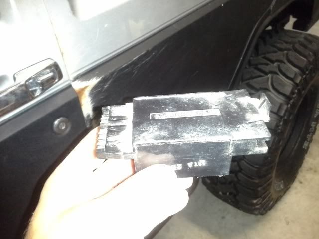

Got a little bit of work done last night. Troubleshoot the wiper issue. Wipers only worked on high and would stop wherever they were when you turned them off. After doing a search on here it turns out that the wiper delay module was bad. The wiper delay module is a cell phone sized black box that is velcroed up under the driver's side dash.
I just removed the box and plugged the connectors together. Now I won't have delay, but I have two wiper speeds and they return to the bottom when turned off again. The wipers ARE still a bit slow, but they are better. My guess is that something just needs greased, but I'm not worried about it for now.

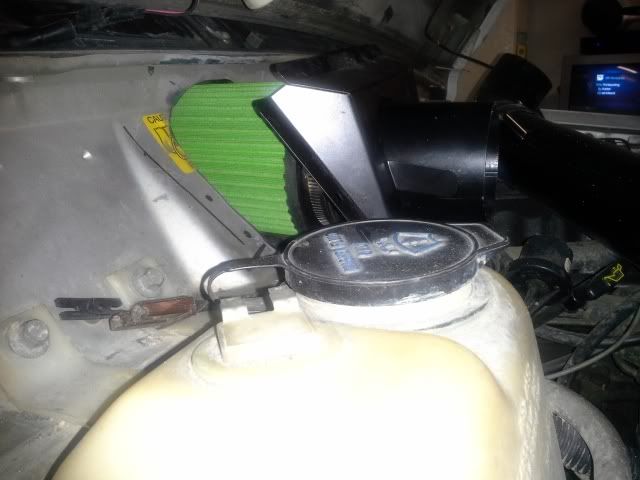

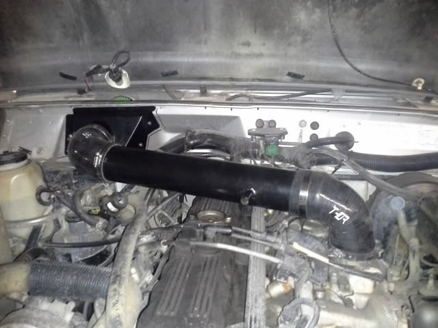

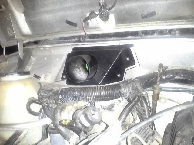

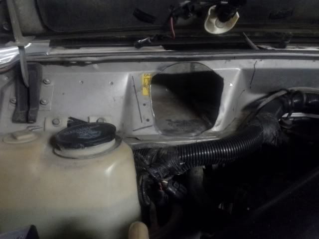

I also got rid of my homebrew cowl intake and finally installed the THOR cowl intake that I picked up awhile ago. Simple, quick install. Not much to it. I just made the hole in my firewall bigger, because THOR positions the air filter perpendicular to the firewall instead of laying sideways in the cowl how I had it before, so instead of the hole just being big enough for the tube it needed to be big enough to fit the diameter of the air filter through.
Here are a few pics of the install. . . .

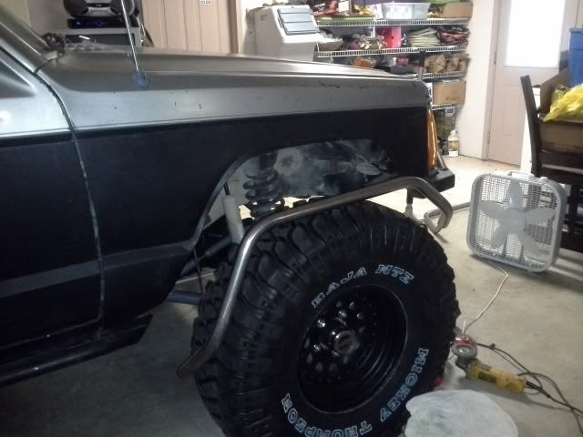

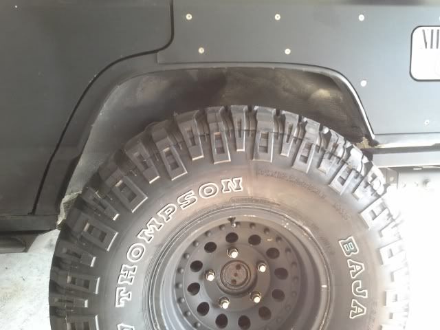

Next up on the to-do list is to touch up the few pin holes in my exhaust and then tackle THIS..... This should be quite interested
I don't know though. I might just do a quick fix for now to pass inspection. Just use self tapping sheet metal screws to attach some cheapo black plastic garden edging to cover the fenders.

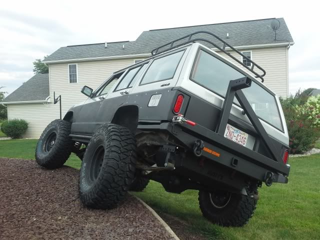

Just a little backyard flexing in the daylight this time. . .

Posts: 5,881

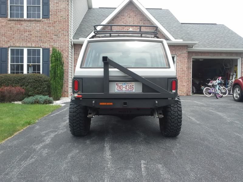

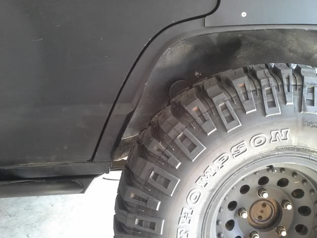

I already knew I needed to trim the rear bumper side protection. The way I'm sitting right now up on the retaining wall it is hitting my rear driver's side tire and won't let me back up. I think I'm just going to park there for the night and fix it tomorrow. Going to quit working on the Jeep now and take the family to see Grown Ups II.
Here is a new issue that I just noticed.... NOT happy about this one or know what to do about it at all. Someone come and make this not like this for me

Turns out once my suspension settled the front axle shifted an inch or two to the passenger side. So, I just have to recenter the axle and the driver's side coil shouldn't rub the track bar mount anymore. WHEW!!! Glad that wasn't a more pain in the *** fix.
