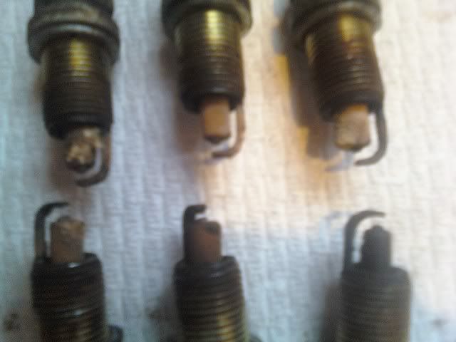

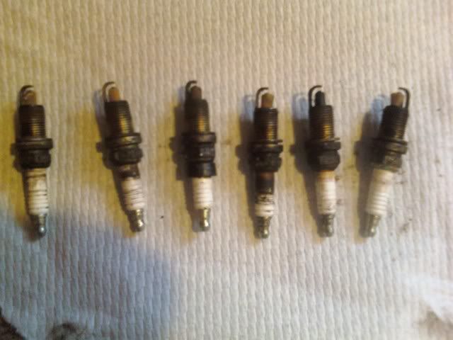

Gave the HEEP a tune up. Replaced the distributer cap/rotor, spark plugs (NGK), and plug wires. When I took the plugs out I was shocked at how HORRIBLY bad they were....
Is that just from them being old or can you what?

I would guess the tap tap tap is from a valve lifter that's stuck and not pumping up all the way - it happens with hydrolic lifters sometimes.
The exhaust,.. that is a little scary - My main questions are "was the oil white and milky?" and "Does the coolent level go down as you drive it?"
It could just be doing that because it's cold out - lots of cars with long exaust do - the water vapor that's created in combustion condenses into steam before it leaves the tail pipe. However it could also be a head gasket.
How hot is that ceramic resistor getting? It should get a little hot,.. but not too terrible.
My plugs looked the same way - someone didn't replace them in a long time.
