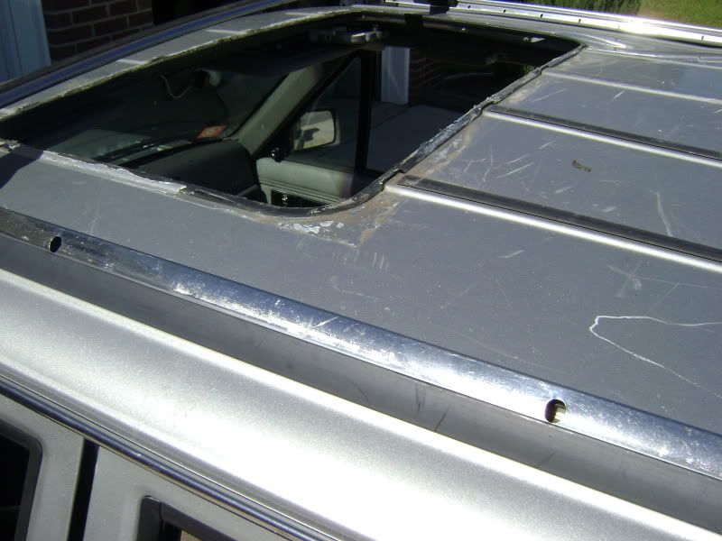

It has a sun roof but it leaks It leaked so long that it jacked up the headliner, so someone just yanked it all down... for the most part anyway...still has some crap hanging down

Leaky Sunroof with silicon around it and freakin aluminum tape

I ripped down all of the headliner and removed the sunroof assy. Just doing that and not having rotten insulation hanging down already made a HUGE difference. In my mind anyway Now I just need to get that sunroof hole plugged somehow. That....install the new starter, exhaust, and door hinges are top on the list. Then we'll move to more cosmetic enhancements when I know it's actually going to be driveable.
