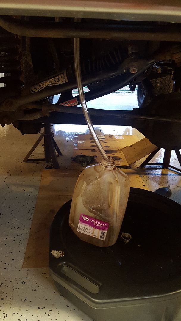

Got the fuel line fixed today, cut out the bad section and used a 5/16 to 5/16 compression fitting to splice in. No leaks so far, ill get a rubber insulated clamp to hold it on later. Also spliced into the return line after the trans to flush the fluid. Went through 8 quarts before i was satisfied. Cleared the codes as took it for a drive and it seemed to act normal. Shifted when it was supposed to and the shifter was able to shift manually with no issues. No codes after warming up and riving around for about 10 minutes so knock on wood I think the trans is fixed for the moment.
Fuel line splice
Poor mans trans flush

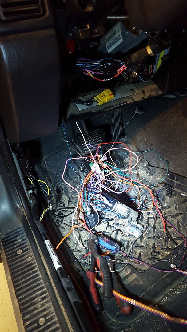

Fixed the rear hatch latch today, had to pull the trim and re adjust the rod going to the latch. Cut off the old muffler it was extremely rusted out and measured for its replacement. Started pulling the interior to diagnose non working power locks and front power windows. Replaced the driver switch with a junkyard one and got the driver window to roll down. Went to start looking into the door wiring for shorts/cut wires and ran into a snag. Apparently there was an aftermarket alarm system installed at some point. I worked for a little over 2 hours pulling it out and tracing wires. I have to solder back together 2 stock wires and wrap some others in some electrical tape. I have a feeling this is probably why there were issues with the door locks. Didn't get around to doing anything with the front suspension since I ran into this surprise.
Rats nest in the driver foot well.
All ripped out

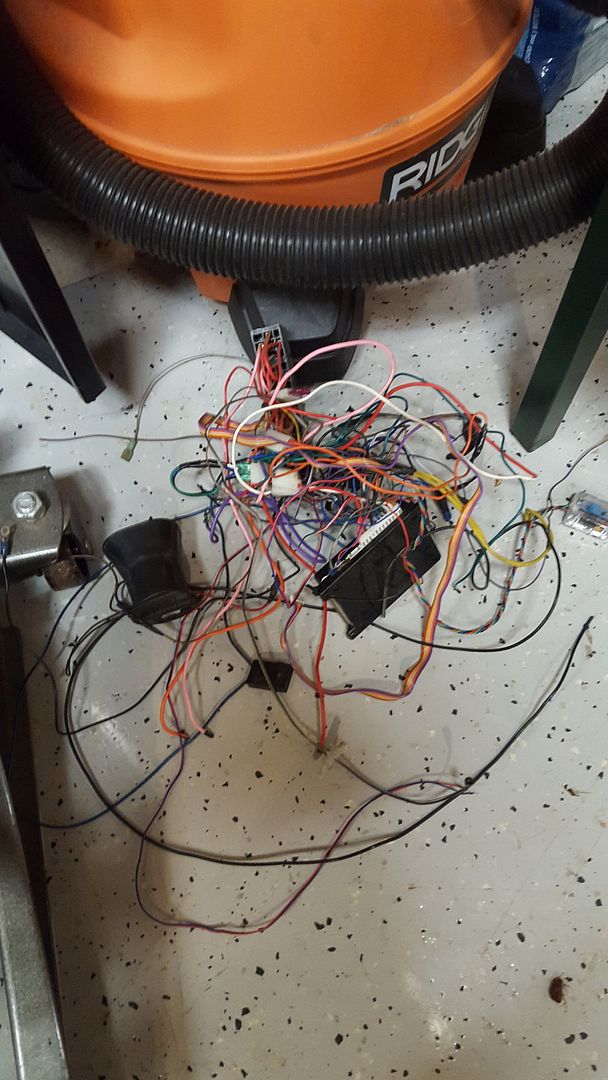

I hope you can get all the wiring back in place and eliminate all the issues. Aftermarket security system was the worst/dumbest thing I ever did to my '87. I was without heater fan, wipers, and turn signals for 3 years cuz I didn't want to screw up the security system I'd payed for. I'll never do that again. It was so frustrating, I wanted somebody to steal it.
D3<!L!>3D
S8NNG8 is offline
post #8 of 109 Old 04-28-2016, 09:03 PM Thread Starter
lowrnu
Location: House Springs, Mo
Posts: 107
got everything back together from tearing out the security system today. Everything seems to be working alright. Also got all the power windows to work. Re-soldered the door switches thanks to this video I found,
Power locks now unlock but are having issues locking. I am pretty sure the only broken wire was for the driver speaker that I re-soldered. A few others had broken insulation but were intact.

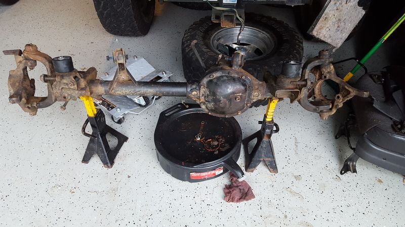

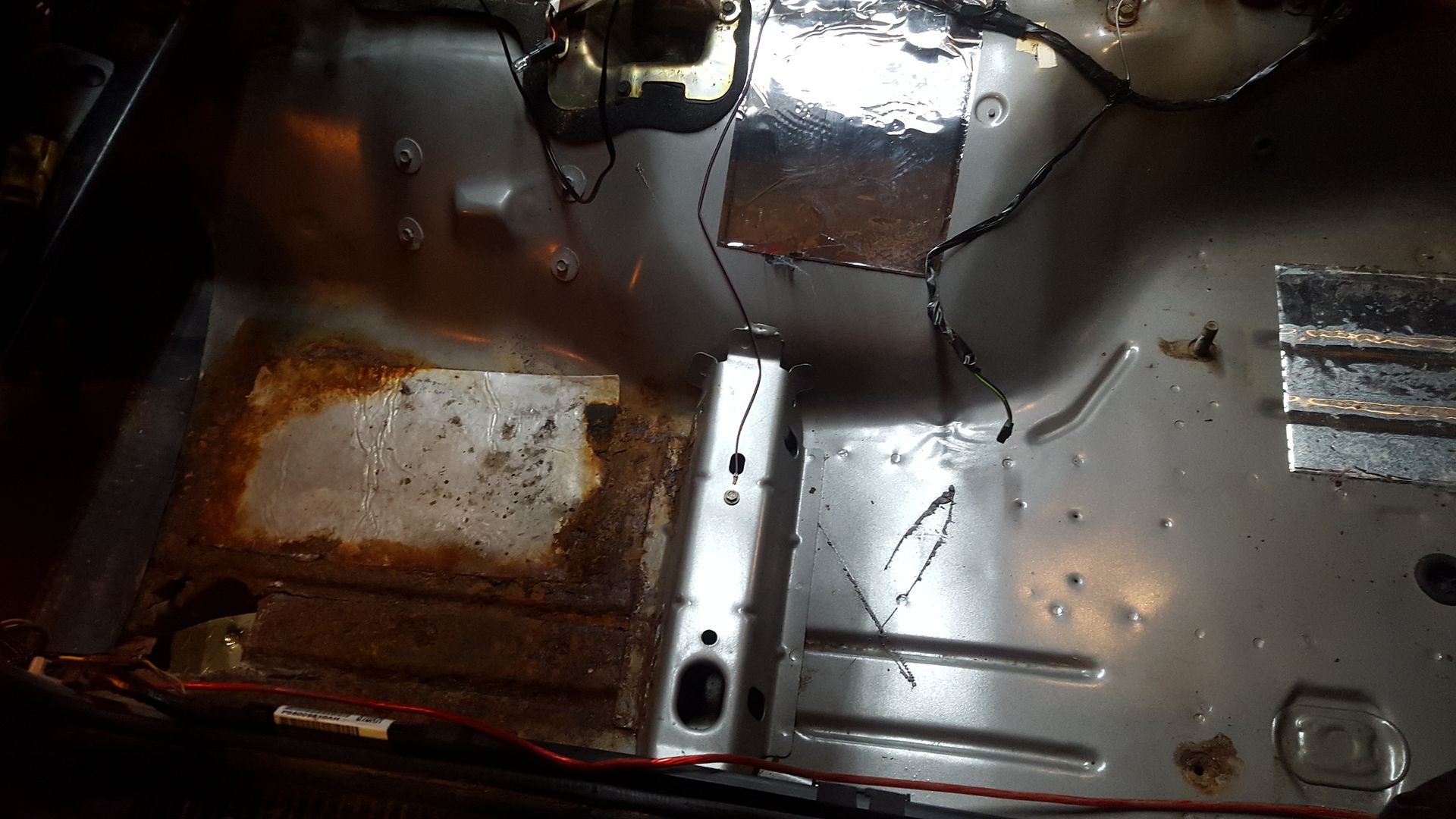

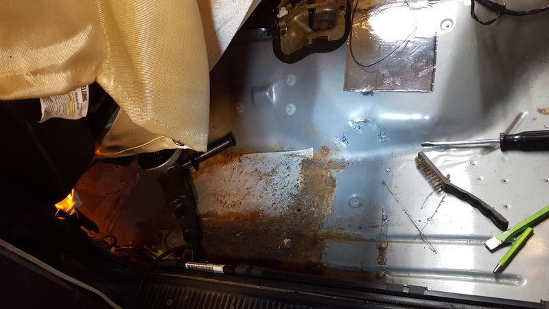

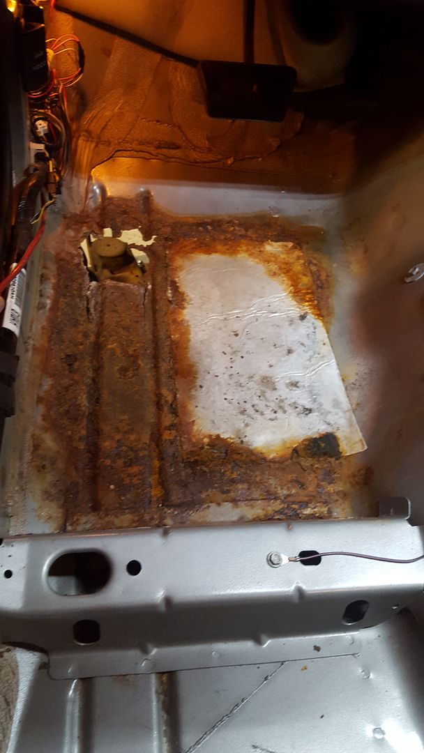

Got the carpet pulled out of the front half of the jeep. As i already knew there is rust. Patch panels should be here today, going to start cutting the floor out tonight in preparation. Still trying to figure out the whole front end situation as the lp30 and rusty hp 30 are sitting behind the jeep. Having trouble sourcing a housing for a reasonable price.
Driver floorboards
Passenger

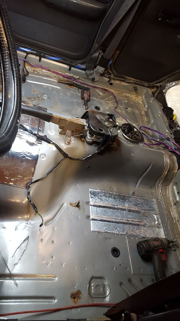

Got the driver side seat bracket removed and the profile of the section i am cutting out cut. Still need to drill out some more spot welds but i am making progress. Also removed the rear carpet, floor pans look good but there is some pretty serious rust on the lower 1/4's behind the rear tire so it looks like a cut and fold may be in my near future. In other good news i found a housing locally for $50 that i think should work so hopefully i can get this thing back on all 4's this weekend.

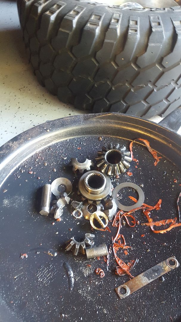

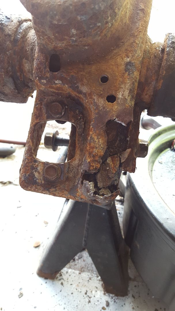

Posts: 107
Went and got the front housing picked up last night, much better condition than the first one I got. Track bar bolt hole is a little worn out so I may weld a grade 8 washer to beef it up. Got a nice little suprise when I opened the diff though, spider gears were in more pieces than spider gears should be in. I inspected the ring and pinion and they seem to be ok miraculously so i got lucky there. I initially was just going to swap in the spiders from one of the other front ends I have collected. Then after a few margaritas at the local Mexican place (cinco de mayo) I ordered a spartan lunchbox locker and new axles seals. I figure I would have done it eventually so i don't have to tear it down again this way. I was hoping to get a bunch done this weekend but am involved in a charity event friday/saturday night that is going to take up a good part of the weekend.
Surprise I found in the diff.

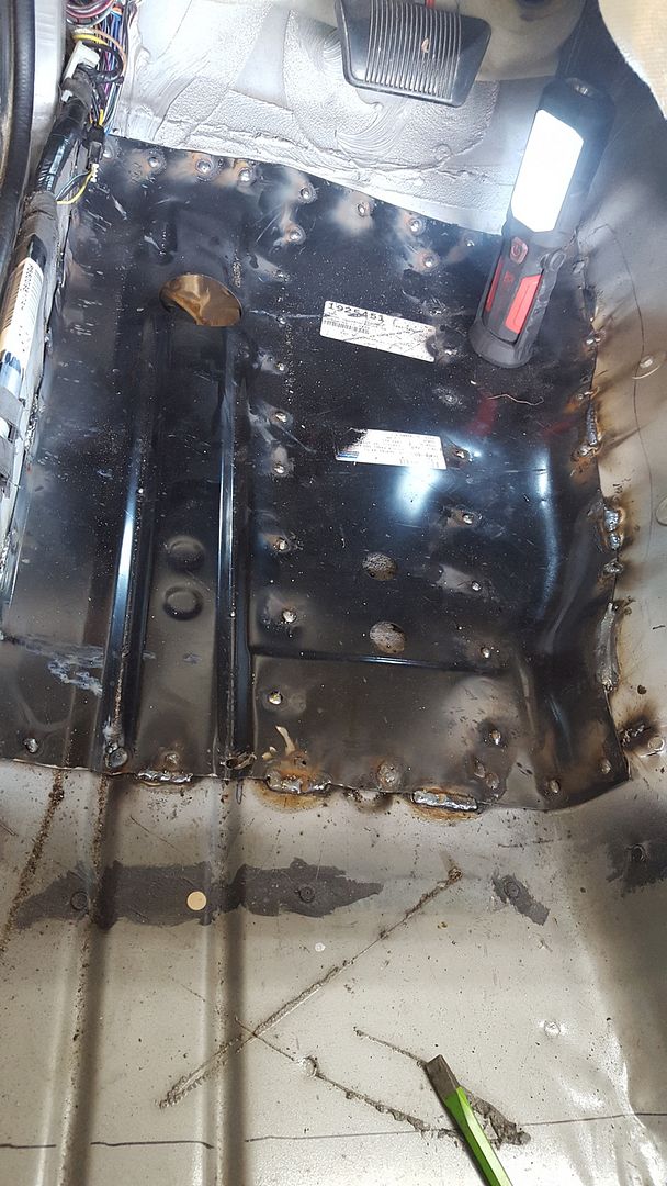

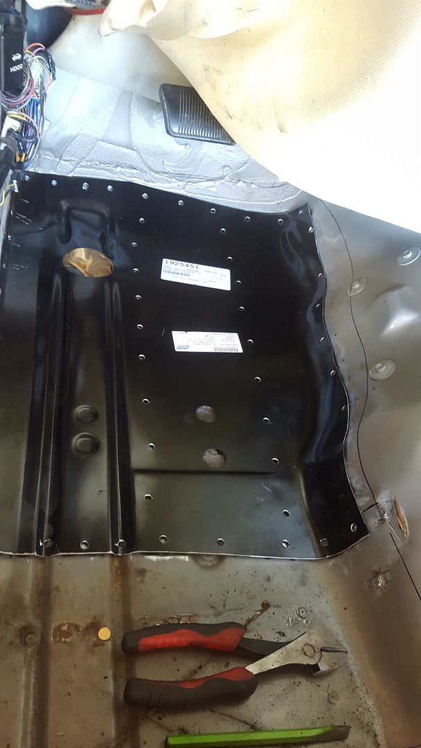

Made some decent progress this weekend for how much I had going on. Got the floor pan cut out and all the rust coated in por 15. Driver pan is welded in and welds coated in por 15, still need to seam seal but its in there. Got the passenger seat bracket cut out and started going after the spot welds on the passenger panel.
coated with por 15
Holes drilled for the plug welds
Welded up
Again coated with por 15

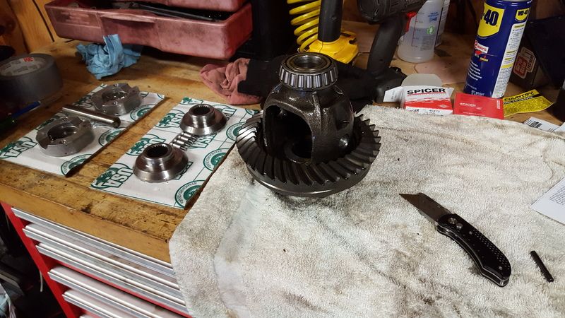

Got the sidetracked from the floors. New locker came in last night and I was excited to get that in.
Wasn't able to take any pictures during the install/ cleaning up the housing due to greasy hands. The housing got cleaned up with brake clean and the tubes were cleaned by pushing a rag with a 33mm socket hooked up to an impact. Did a pretty decent job of getting out all of the gunk. Got new seals and the carrier installed last night though. Going to pick up some new hard ware and hopefully get the housing under the front of it tonight.

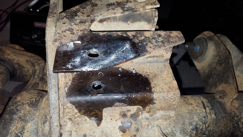

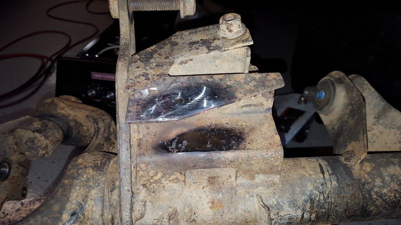

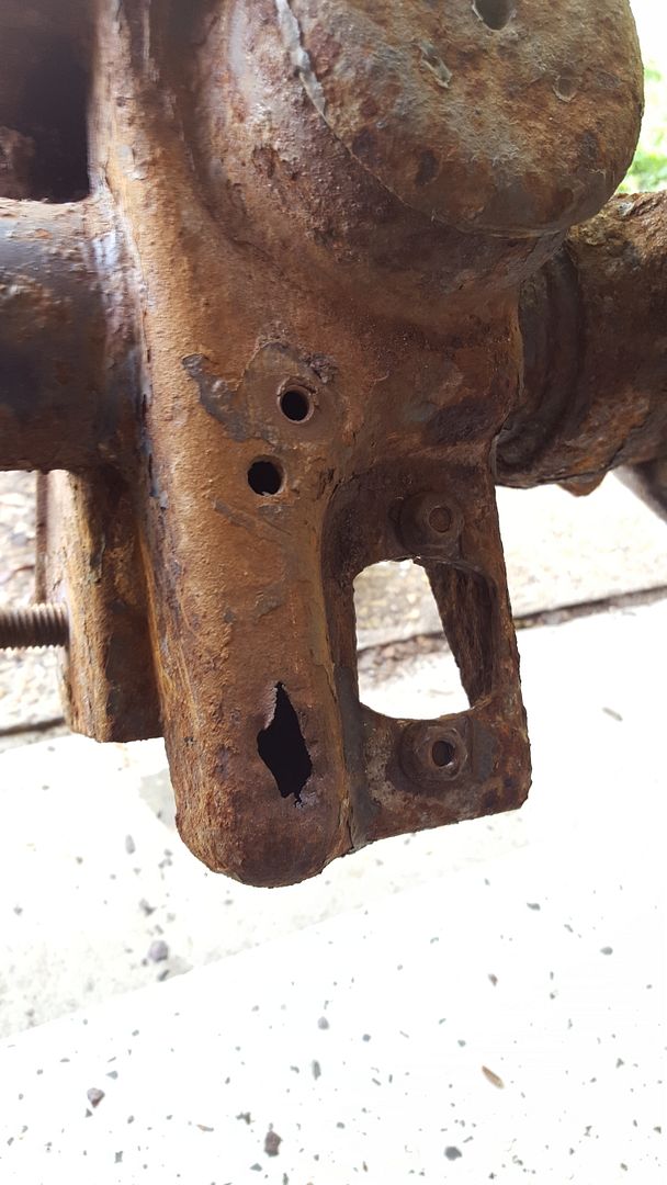

Had to cut my grass after work today, the yard was turning into a jungle. I did manage to weld up and redrill the holes on the track bar bracket. Hole location is withing a 1/16 inch of stock, im happy with that for the method I used. Cardboard cut and traced. Hole isn't perfect but I think im going to upgrade to a 7/16th bolt and ream the hole out to fit.
Bracket before
welded up
ground down
and re drilled
