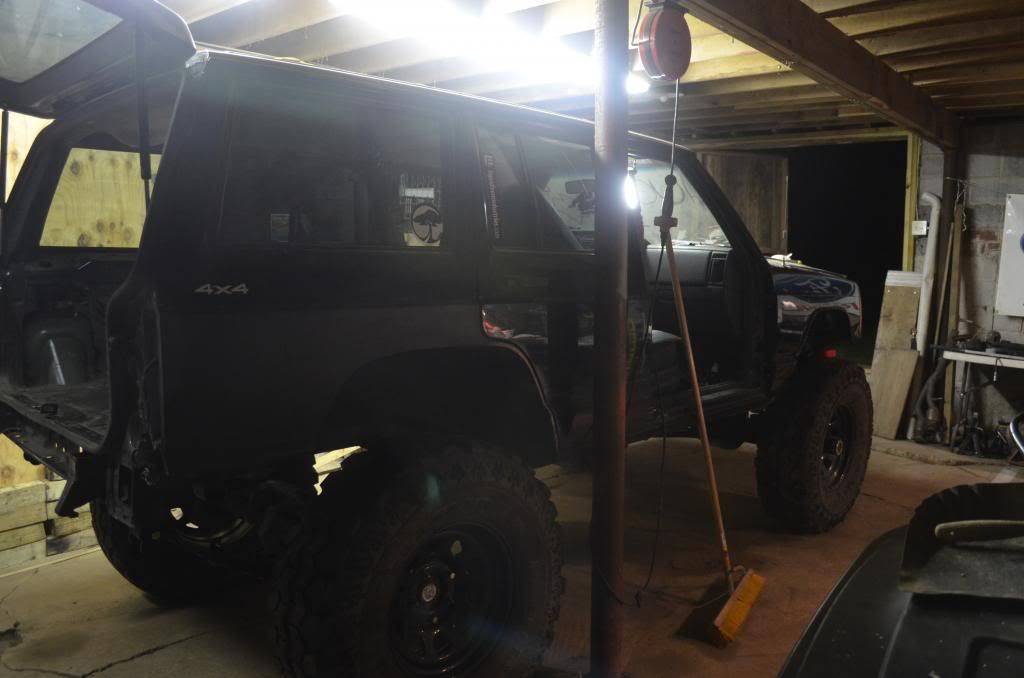

Well i didn't have as many pictures as i thought. But here is how it sits currently.
Pics aren't so great, but you get the idea. Axles are under, leaf perches are welded on, front coil perches/ control arm mounts are on.
It still needs the trac bar mount welded to the axle side, i have to build some driveshafts, and get some shock tabs. She also needs some spacers in the rear.

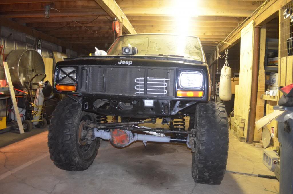

Got back in the barn and got some axle side shock tabs on bolted up the front shocks.
Close up of the completed front end. We had to shorten the drag link, and track bar
