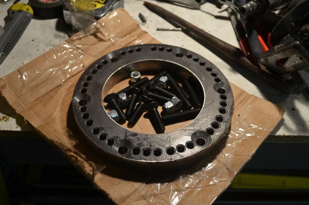

To keep things moving, my clocking ring came in yesterday
And bolted up to the 300 nicely

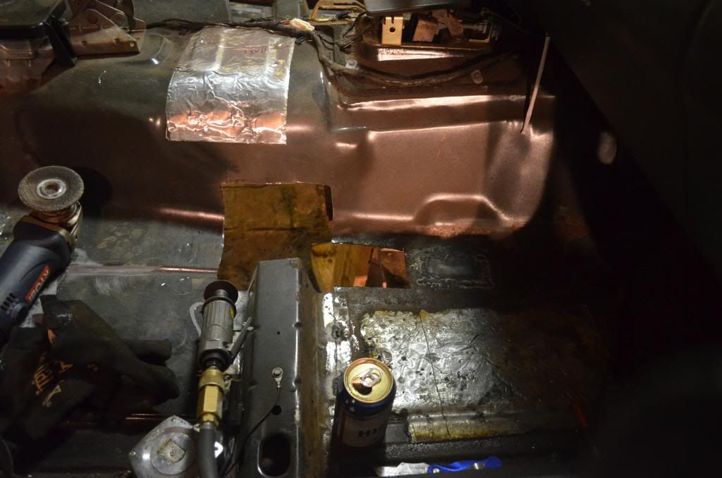

A little bit of measuring and some estimation
The smaller section is from some rust repair that I haven't fixed yet, the larger hole will allow the body of the tcase to clear the floor. Still haven't made a place for the shifter yet, but that is my next move.

Make sure you RTV both sides of that clocking ring if you didnt get any gaskets with it!

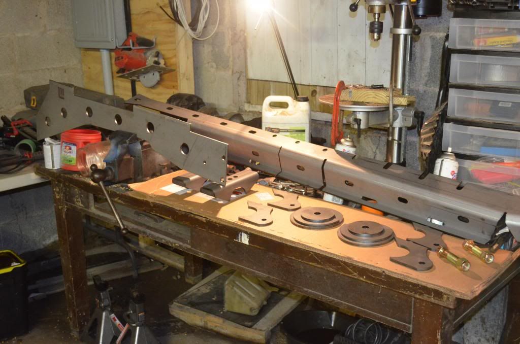

We have had quite the heat wave here in PA, so that has really taken its toll on my jeep building motivation. Anyway, I did get some parts in and that got me going again.
What you are looking at:
-Liquid Iron XJ front plating
-RuffStuff Chassis Reinforcement
-Ruffstuff Spring Perches
-Ruffstuff Coil Mounts
I had to readjust my jackstands, and started mocking them up

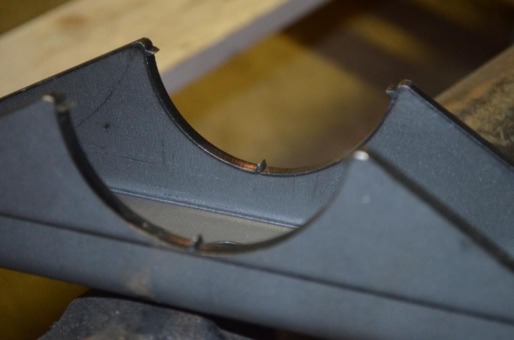

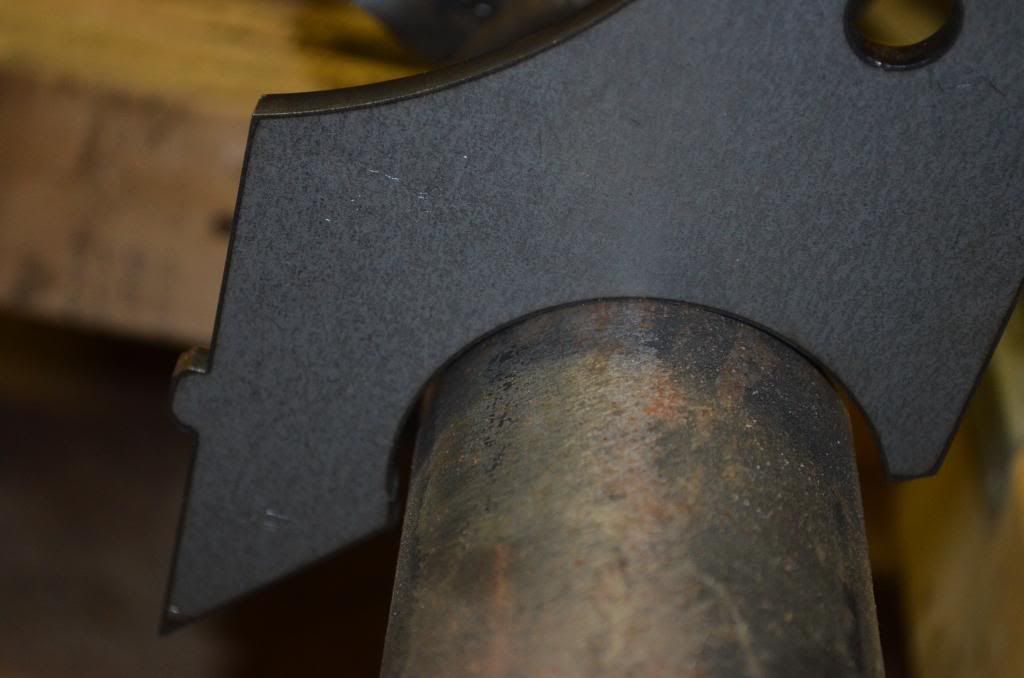

Also, does anyone know why my coil mounts fit the axle so loose? The leaf perches fit fine and are for 3" diameter tube. Is this just something I will fill in with weld?
What I also noticed is that the spring perches have little teeth making the fit more snug, which the coil mounts do not have.
This should be a productive weekend, and im planning on getting the frame stiffening wrapped up, and then start focusing on mounting the tcase again. At this point im pretty much waiting on a paycheck so that I can order my long arm kit!

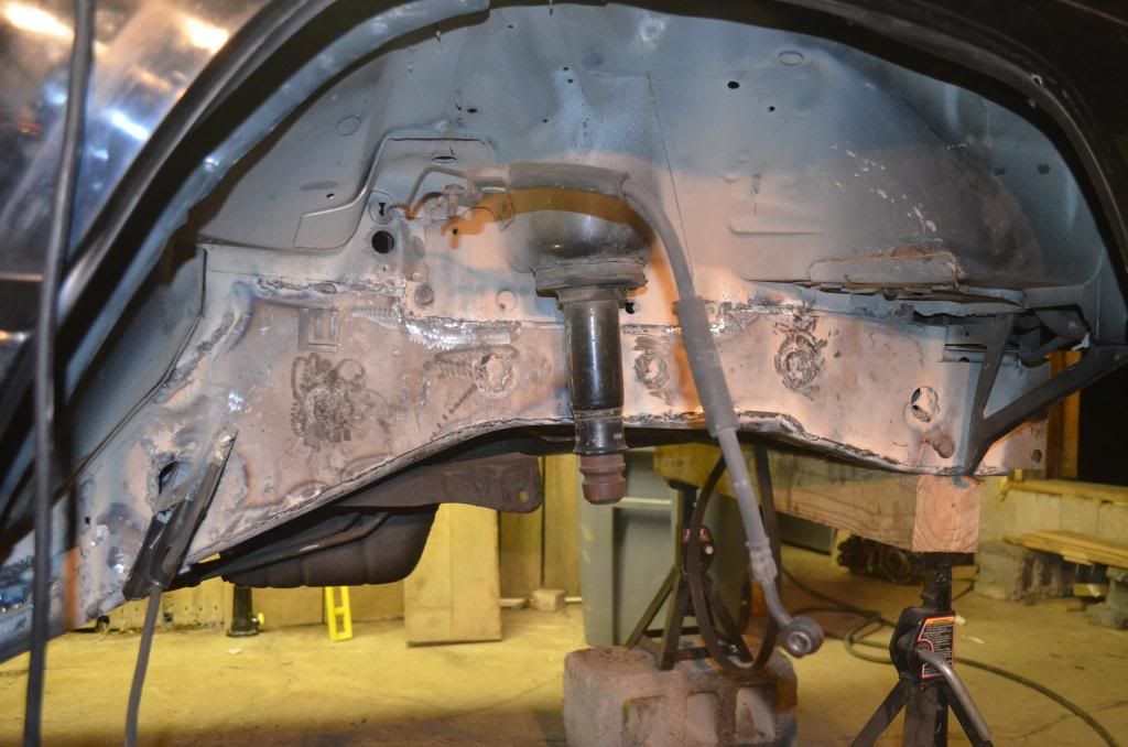

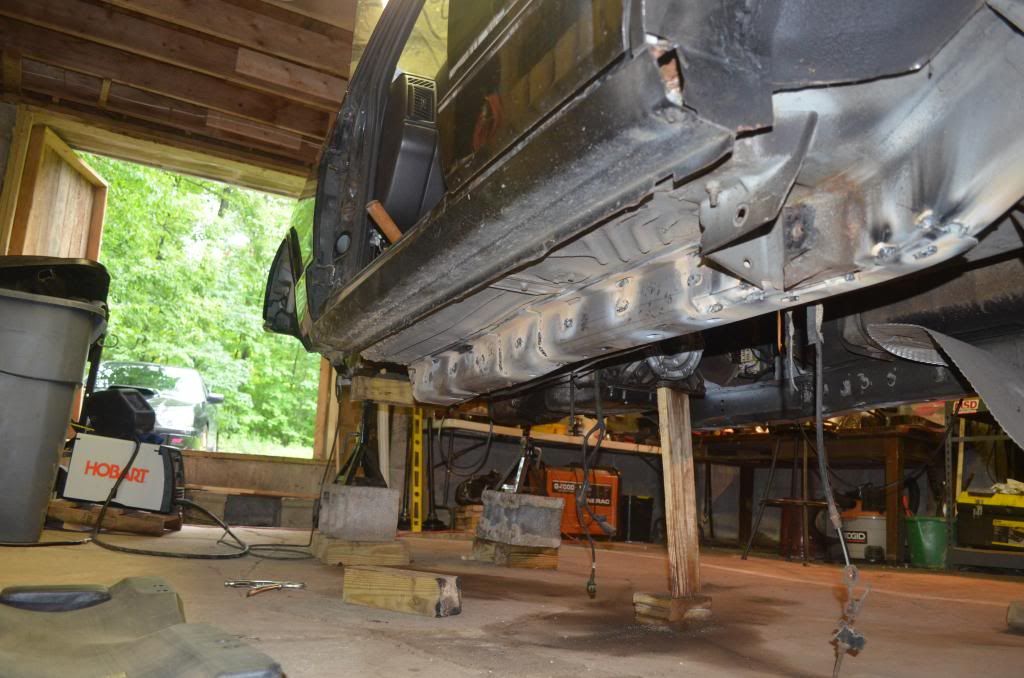

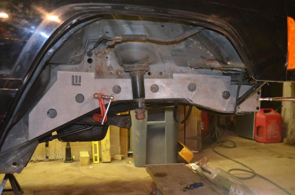

I had to trim the plates a little bit to get them to fit perfect on the front section as well as the rear section. Also had to chop the stock chassis mounted control arm brackets, all I can say is that a plasma cutter would have really helped.
Welding isn't really my strongest area, but im happy with how these are coming along. They are almost finished, just need to lay a few more beads and they should be good to go, then on to the drivers side.
Im not sure she's gonna make it out of PA this summer, unless I can find a hell of a deal on a trailer. Maybe thanksgiving
As for the clocking ring, I ordered on ebay from a vendor called 4wheelsupply $70 shipped
Some dana 44's are 3" and some are 2 3/4. But either way that gap is fine. Get it to where you want it and just burn it in! Looking good! Keep em coming! As for towing.. you can probably borrow out flat tow hitch and just tow it up behind your truck. Thats how my parents tow the cj around behind the motorhome.

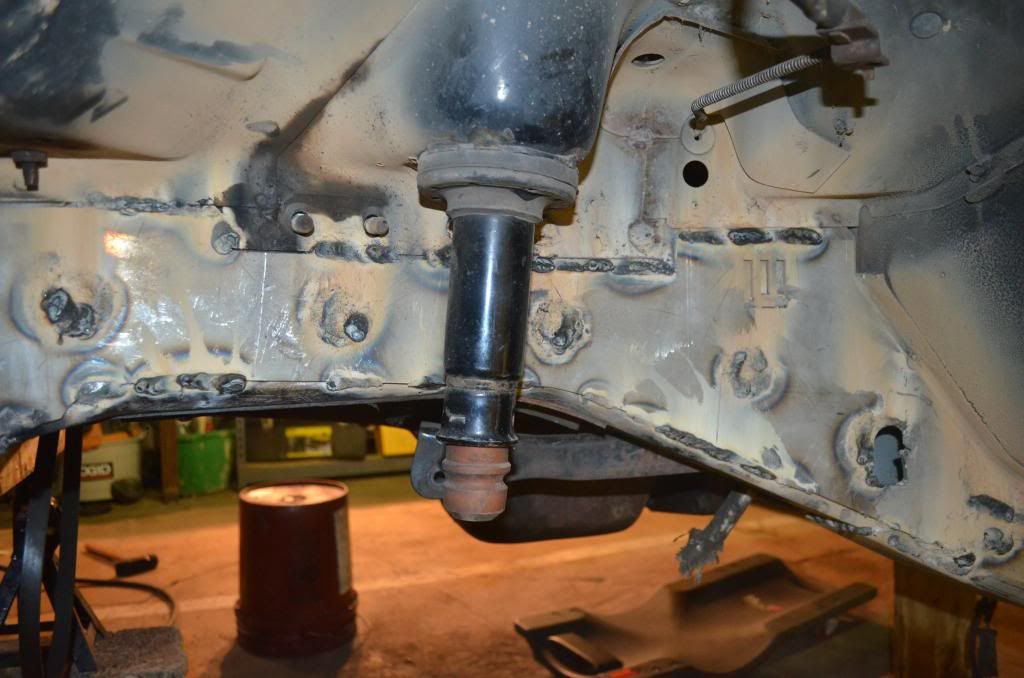

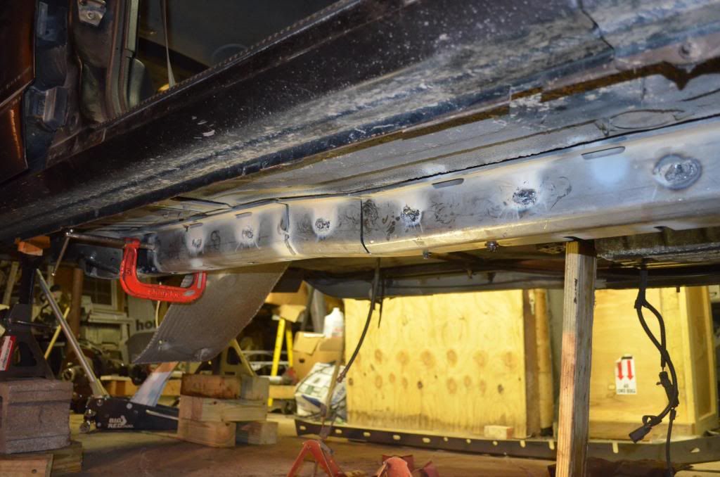

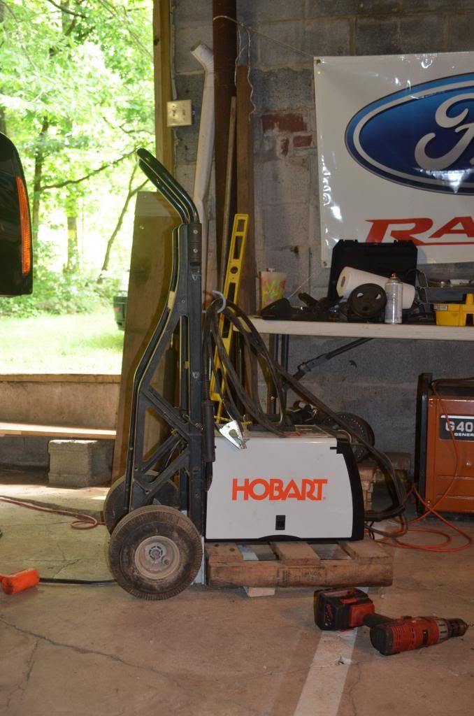

Well I would say this thing is just about finished. Maybe another few spots here and there, maybe some more on the bottom of the midsection. Im in process of getting something for the rear section. seems silly to leave one section un-plated.
And i got tired of carrying my welder around when I moved, and since im cheap and impatient i rigged this up. Going to get some caster wheels for the front so i don't have to to tilt the hand cart, maybe redo it with some tube later when I pony up for shielding gas. That mini pallet is screwed to the hand cart, its surprisingly sturdy.
