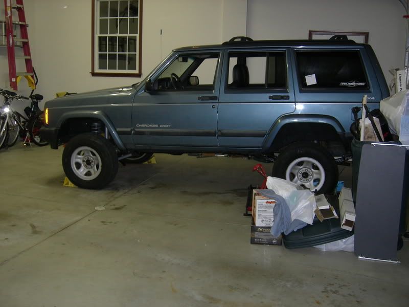

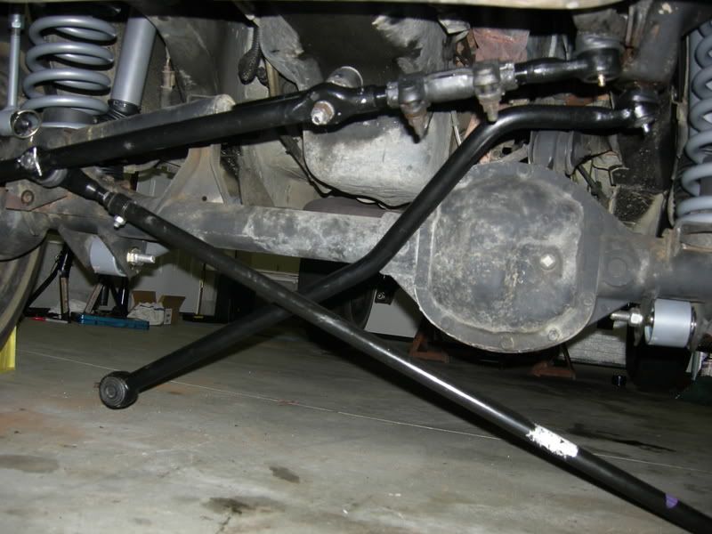

UPDATES and GOOD NEWS! I got the driveshaft installed with the sye hack n tap. We had to take the DS to a local shop cause i didnt have time to keep messing with it. 20 bucks later it worked like a charm. Still hell of a lot cheaper than buying a new one though, we'll see how it works out. Also, the lift is officially done! Now we are working on a new brakeline. We are getting the stealership to get us a prebent hardline for 45 bucks. Also putting in new tierods and tierod ends, track bar, etc.
DS/HnT
Something wrong with these pictures?
Here is a pic as the XJ sits in the garage.
Hopefully well have new tires on the new wheels and mounted by saturday/ on saturday. Still gotta figure out how to mount those center caps.

I might have totally missed something, but that's quiet a rake you go goin' on there man. Love the progress, it looks like a really clean and complete install. Good luck with tying up the loose ends!

Dont know what you mean about rake, but hey thanks for the comments!

By rake I meant that the rear looks higher than the front. It might just be the picture, but I just thought I'd mention it because I was curious...

oh well yeah the rear is higher. Ill level it out with some heavy rear bumper for the rear, and then the front, and then ill be right back to where i started... lol. But the next project will probably be the aussie i have up sitting in my room, new rotors, and maybe some discs for the rear. But i want to be able to use the ebrake so IDK.
Edit: oh and yes it sucks very badly.... Oh well, i get to drive the commander around for a while!
EDIT2: and another thing i forgot to mention, im also in the process of spraying the exposed parts of the undercarriage with That 3M underbody coating. Looks good too.

Isn't one option to throw some sand bags or something in the trunk for a while to bring down the back a little bit?

Well, i might do something like that for winter to get a little better traction. But in the mean time ill have a full sized 31x10.5 back there for a little dead weight.
Oh and it feels good having to kinda "climb" rather than duck into my XJ.
