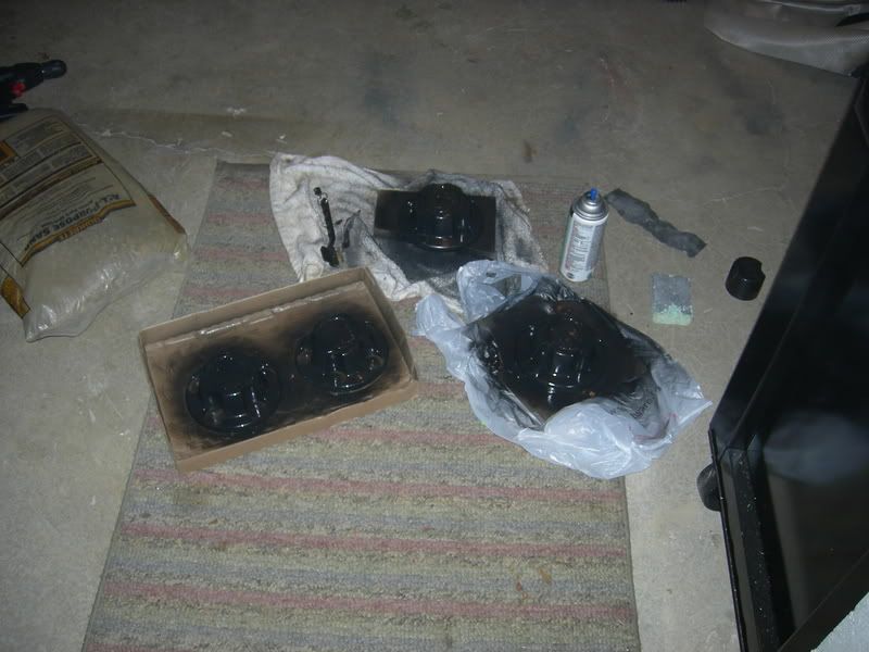

Took the center caps off of my steelies, taped em up, and painted them a gloss black. Just used electrical tape and a knife to cut it into the circle emblem.
Used a first coat of Flat black enamel followed by a second coat of gloss krylon fusion, and a final of acrylic laquer.
Slowly but surely, ill get all of this back on eventually. Ill get a shot of them dried with the tape off tomorrow. Gotta get some PB blaster under the jeep asap. Has been raining and raining. Also i found my bumpstop just laying at the bottom of the coil spring...
