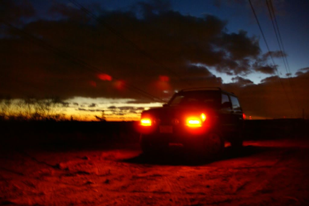

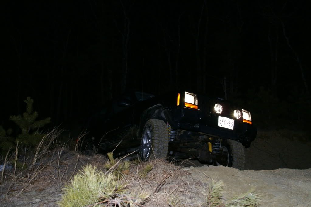

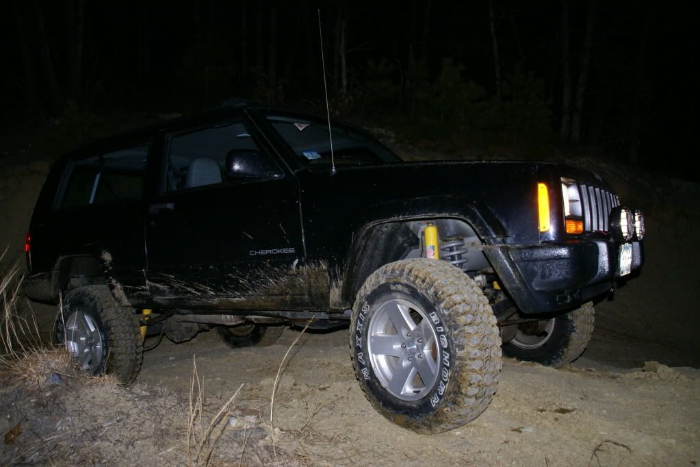

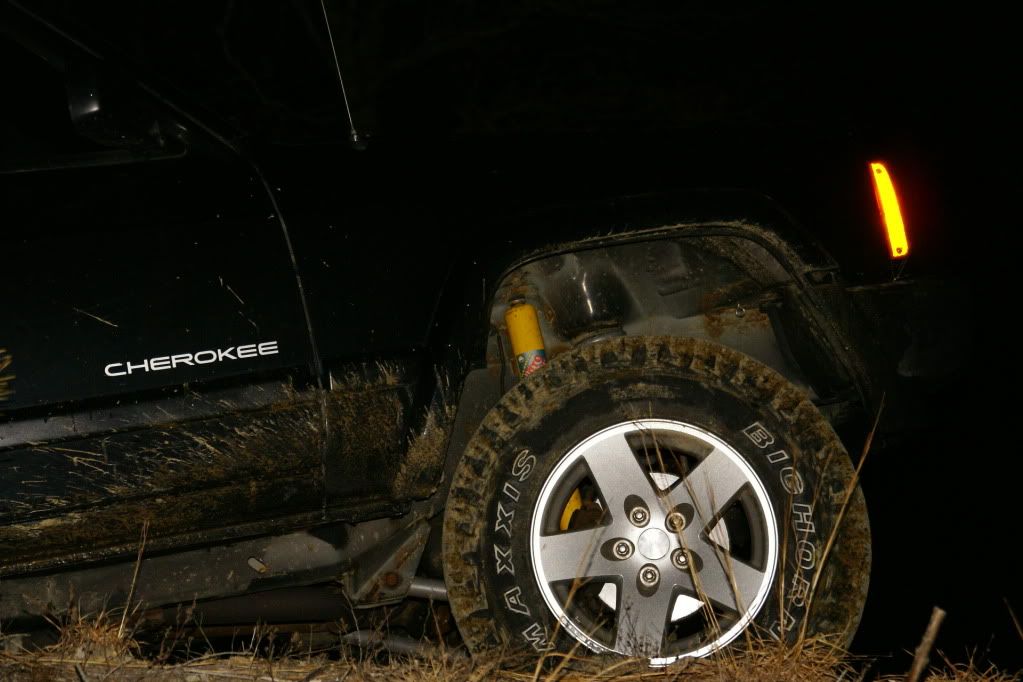

Just got back from wheelin. Thought I'd share some pics.
