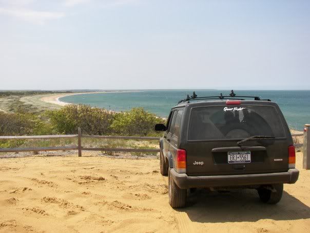

I bought this 01 Cherokee in the beginning of the summer (2009) with 98k on it. Had no intension of lifting it or wheeling it, simply bought it as a first car and something I could use to drive on the beach for surfing.

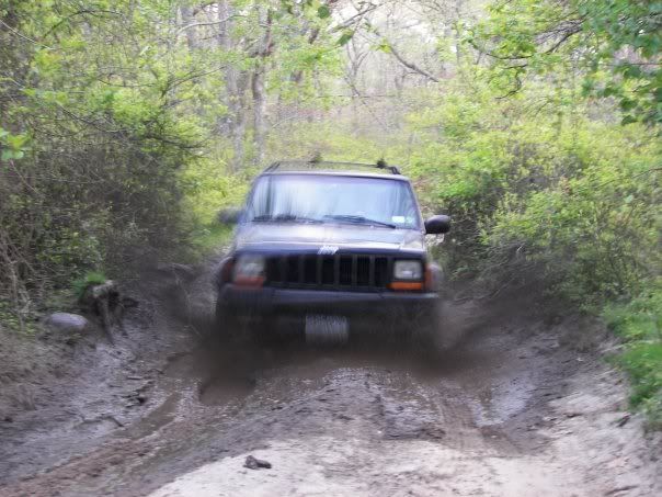

First pictures I took of it, Also first time 4 wheeling
Memorial Weekend 2009

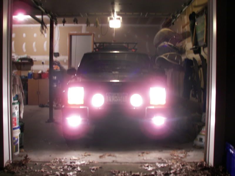

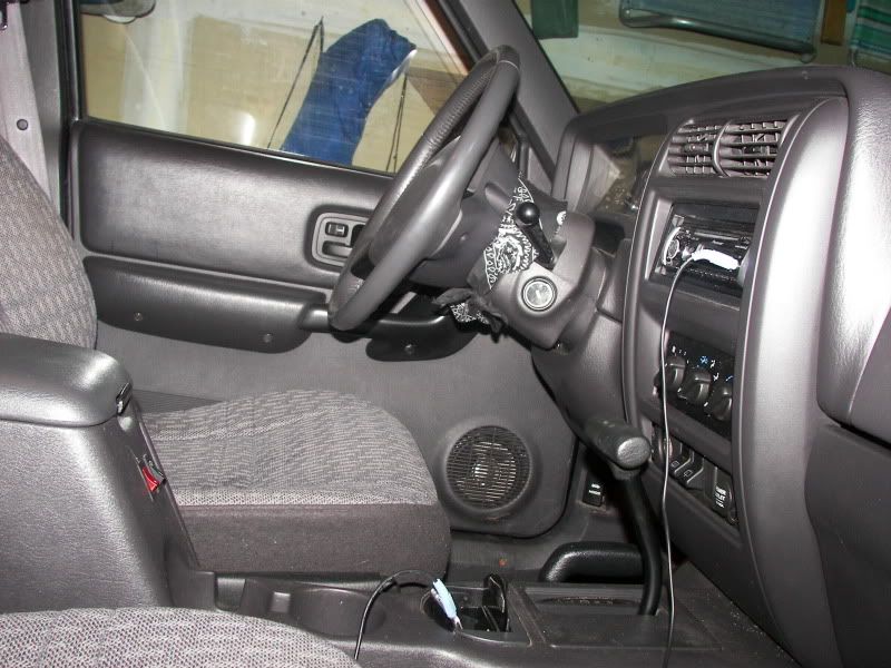

Over fall and winter I fixed up a few things and added a few nic nacs here and there. I put in a new radiator to start, replaced the stock speakers with Inifiti Kappa Series Speakers, added 2 12'' Kicker CVR's w/ a Fosgate Amp, 6'' Off-Road Lights, Fog Lights and I built myself a roof rack.
Fall-Winter 2009
(Notice where I put my Light Switches) Haven't seen anyone else put any switches, east access and out of the way

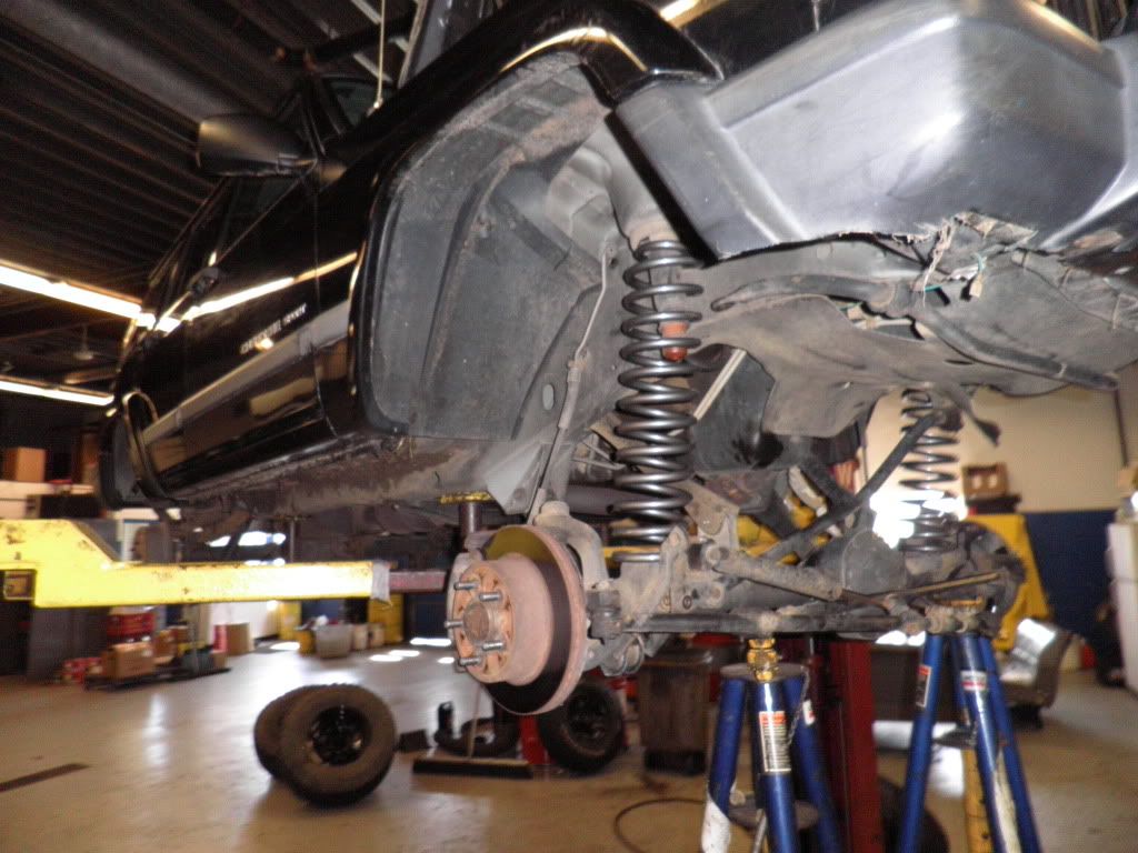

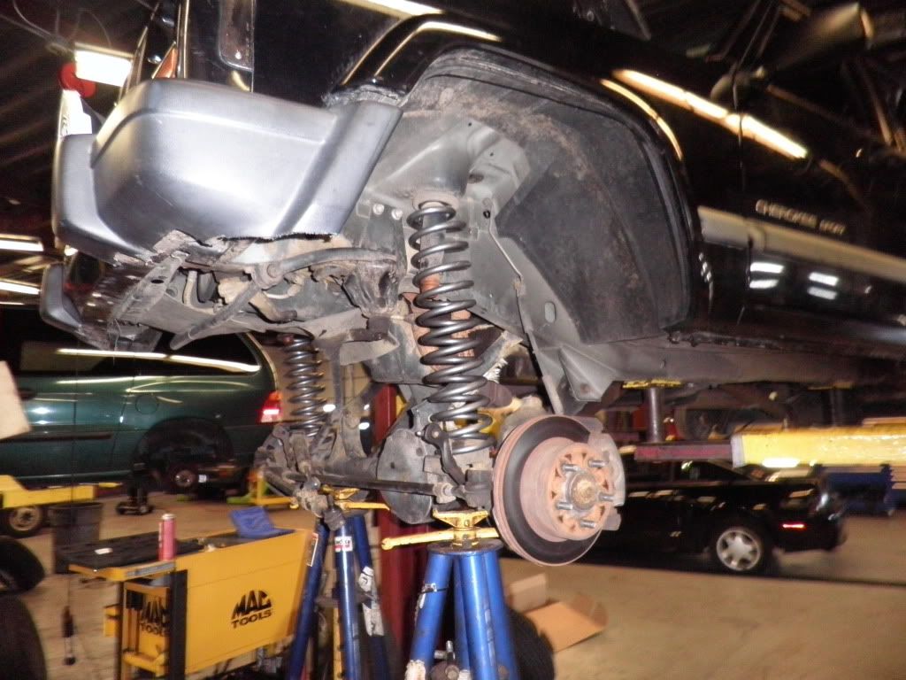

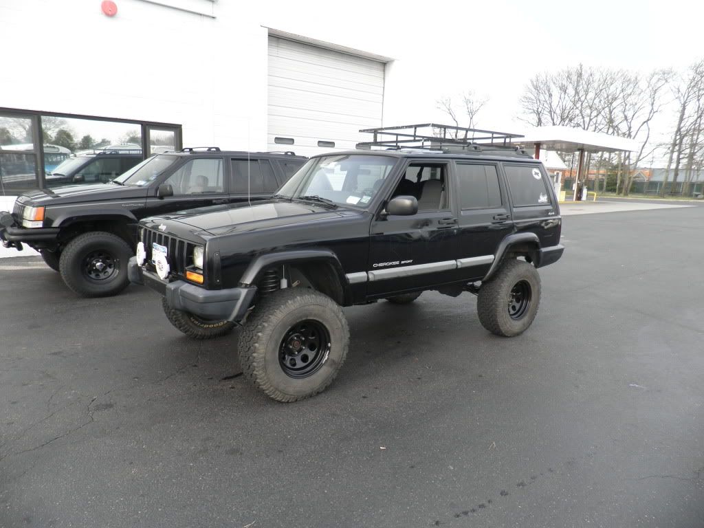

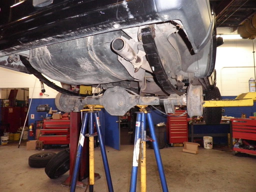

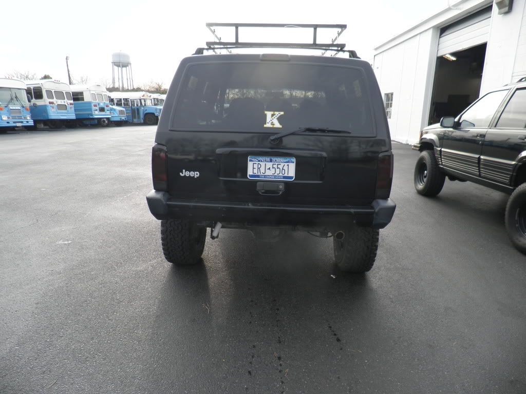

After saving enough money and doing my research I decided it was time to give it some lift and some new shoes. Considering my tight budget and driving situation, school, work, beach, weekend wheeling, I decided what the right build would be for me. I decided on the 4.5 Rough County full-leaf pack. In my opinion, a solid kit and not too pricey. I was originally looking for mud terrain 33's. Nothing too aggressive though, keeping in mind that this truck is a DD. I happened to stumble across four 32x11.5x15 BFgoodrich a/t's with Crager soft 8's mounted on CL for 530. They had great tread, wheels were in good condition. I couldn't pass up a deal like that. Plus with the 32's I don't have to do much trimming and re gearing isn't necessary!
Lift being put in
March 2010
After

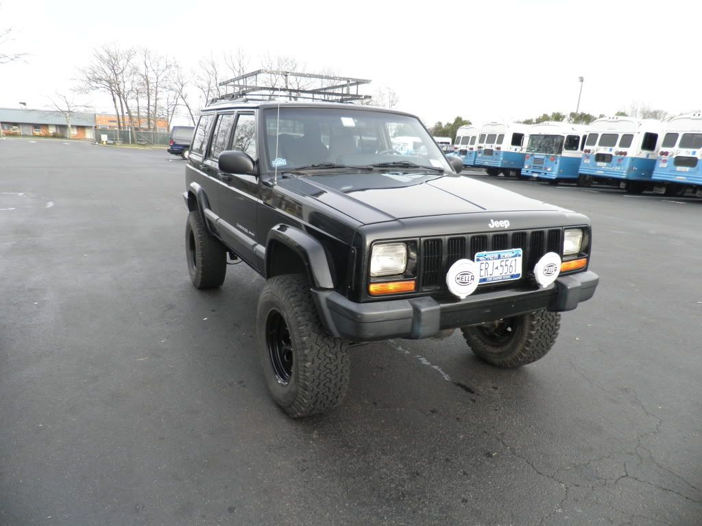

Too much plastic still existing after the lift . You get longer brake lines yet? They'll be restricting you a good few inches it looks.
Good lookin rig so far

i really like the interior of the 97+ and like the all black

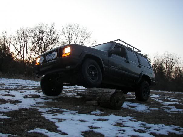

Sunday we rode around with the top off all day and took some pictures with my XJ.

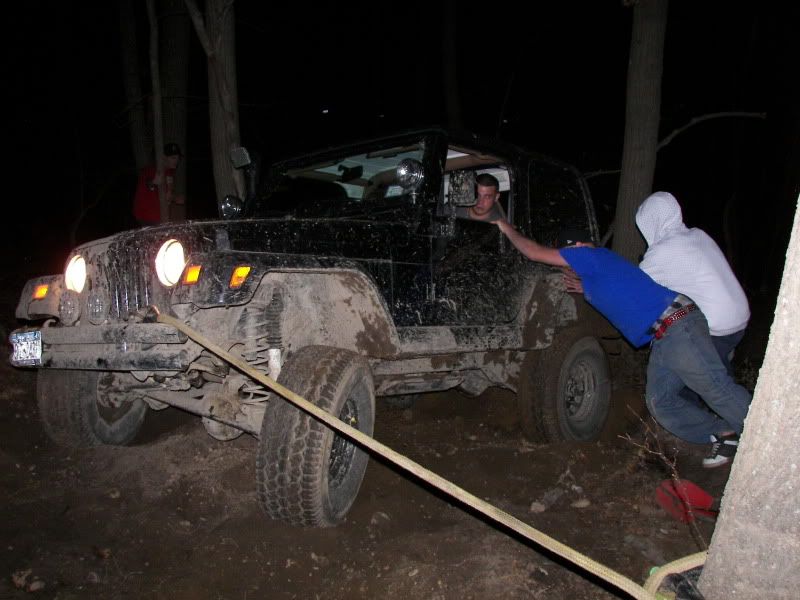

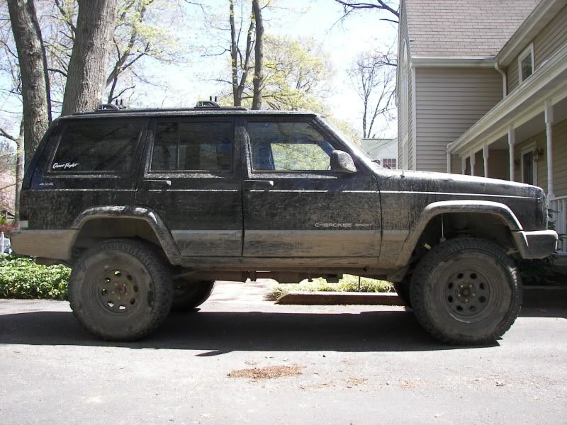

Later that night a group of friends went out wheeling, first night out with the lift. Very happy with how everything went, flexed really nice but had a little rubbing on the wheel-well. Going to have to rip that out before I go out next. No pictures of the truck wheeling, was too busy but my friends wrangler got stuck bad on a nasty hill climb.

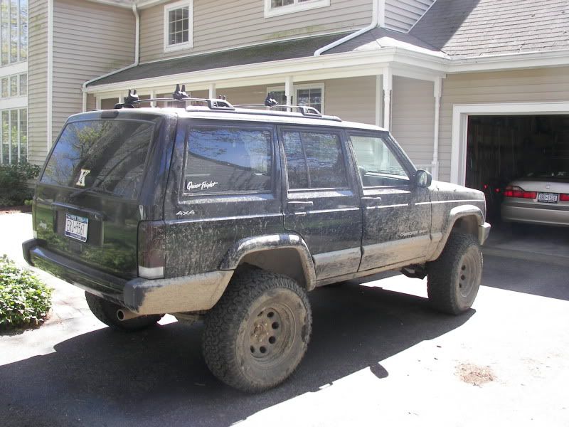

Heres the aftermath, pictures I took this morning

nice XJ.. reminds me of mine, but black and with a roof rack.
I bet it would look real nice if you took that side molding crap off!

Yeah i figured id rip that off soon, whats the best way to go about it? hair dryer?

The cladding comes off pretty easy. Its just stuck on there with some double sided adhesive tape.
Pull it off and then just get some adhesive cleaner(I've used the one by 3M) and use a soft plastic scraper.
