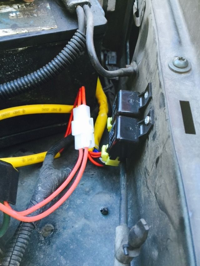

Putco Harness/Autopal Housings Install
Since I'm done working on weekends I finally have time to work on my heep and install the lights and harness that have been sitting around for a week. It was a straightforward install and only took about 30 minutes with a break in between to warm up from being outside. The weather in NEPA still isn't too pleasing lol but I found a nice spot in the sun on my driveway.
I started by popping my hood and taking the headlight bezels and the grille off of the front
After that I started to find out the best way to route the harness. I ended up going through the hole right in front of the battery that leads into the passenger side headlight area. You can barely see it in the joke of a picture that I took with my iPhone, but trust me, its there
I skipped using the mounting bracket that came with the harness for the relays and mounted them both straight to the inner fender on the passenger side right next to the fuse box. I also ran the power wires to the fuse box power post under its little black cover instead of straight to the battery
I ran the drivers side wire across the front of the radiator next to the front bumper. For grounding points, I used two of the radiator support bolts after I cleaned them up with a wire wheel on my dremel
I'll get a picture of the light output down on my road tonight and see how much of an upgrade these things really are

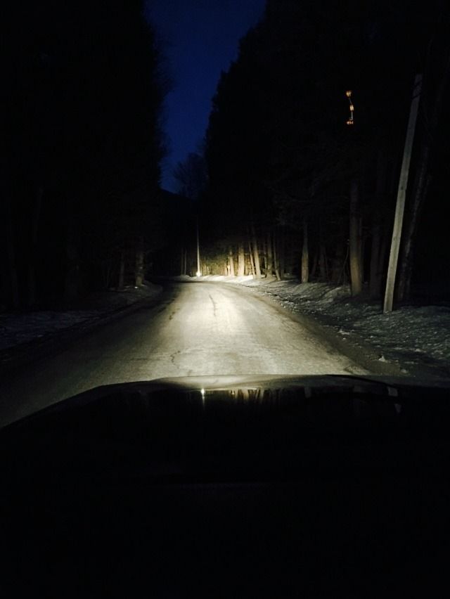

Well the testing is complete. I should've done this the week I picked the jeep up!
Lows
Highs
I really wish I got a picture with the piece of junk sealed beams on stock wiring to compare on here, but these bad boys are amazing compared to stock, and that's still only with 55/60w bulbs that came with the housings! Definitely a mod recommended to all
