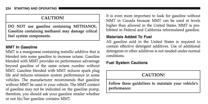

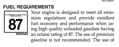

I filled up with premium before a trip on accident (about 15 gallons premium to 4 gallons regular). Didn't really notice any difference. Any who here is what the 05 service manual says about premium/ and fuel blends.
