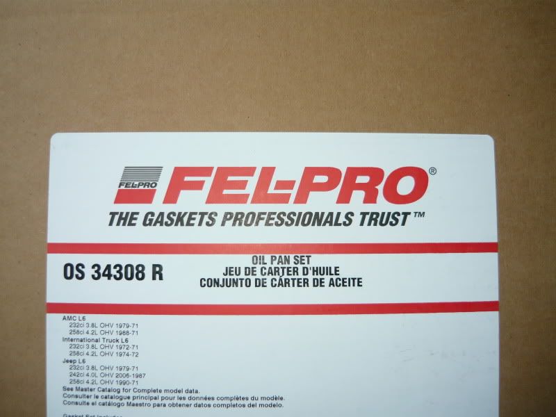

Here is the Felpro oil pan gasket part number. It's a one piece gasket.
According to RockAuto Auto Parts your 2002 4.0L takes a FEL-PRO Part # BS40183 rear main seal (2 piece set)
