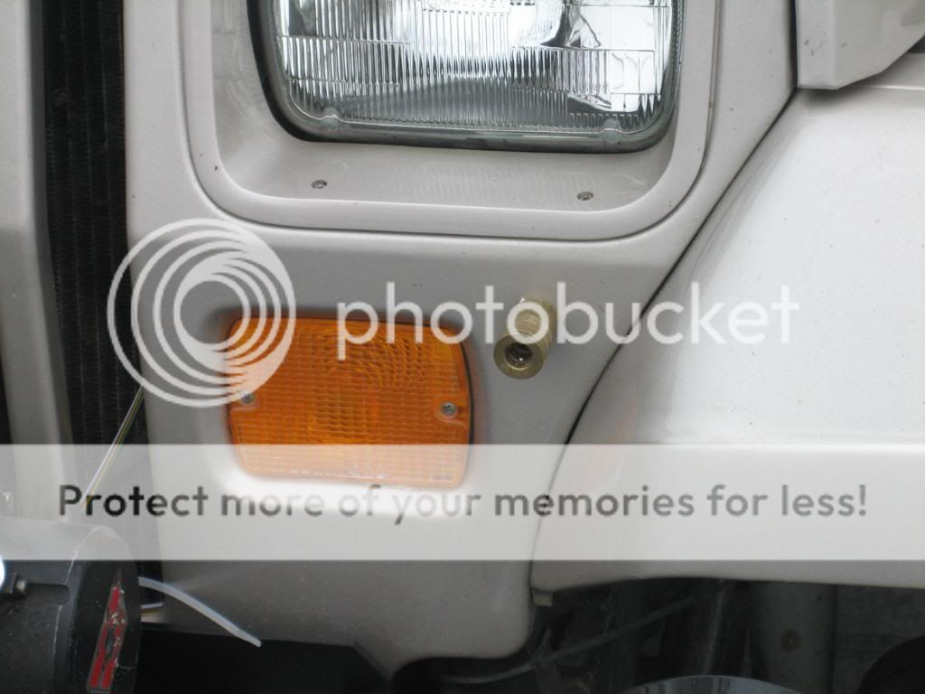

Well I REALLY like my ARB air lockers, I have them front D30 & rear D44. Not sure what your issue is "seems silly to lug around the added infrastructure involved with air lockers" not really any issues. I also have a York OBA system so no big deal to send air to the lockers. If you don't have an OBA you can always get the larger ARB compressor, it is great being able to air up tires and the end of the trail w/o having CO2 tanks.

Well it all depends on how you set it up, like I said I use a York compressor. First flip the compressor switch give it a min. or so and you are ready to go w/ the ARB's. I leave the switch for the compressor on all day. It only comes when it needs to, the switch is on all day but the compressor only comes on a few times during the day. Now I have also installed quick disconnects front and rear so I can get air from either end. I can fill all four tires from one location, but I went this way so that I can help out jeeps in front or behind me if needed. Installed all of the switches in one spot,and I am using the ARB switches but then I am in a YJ so will need to find a spot in yours to locate the switches.
