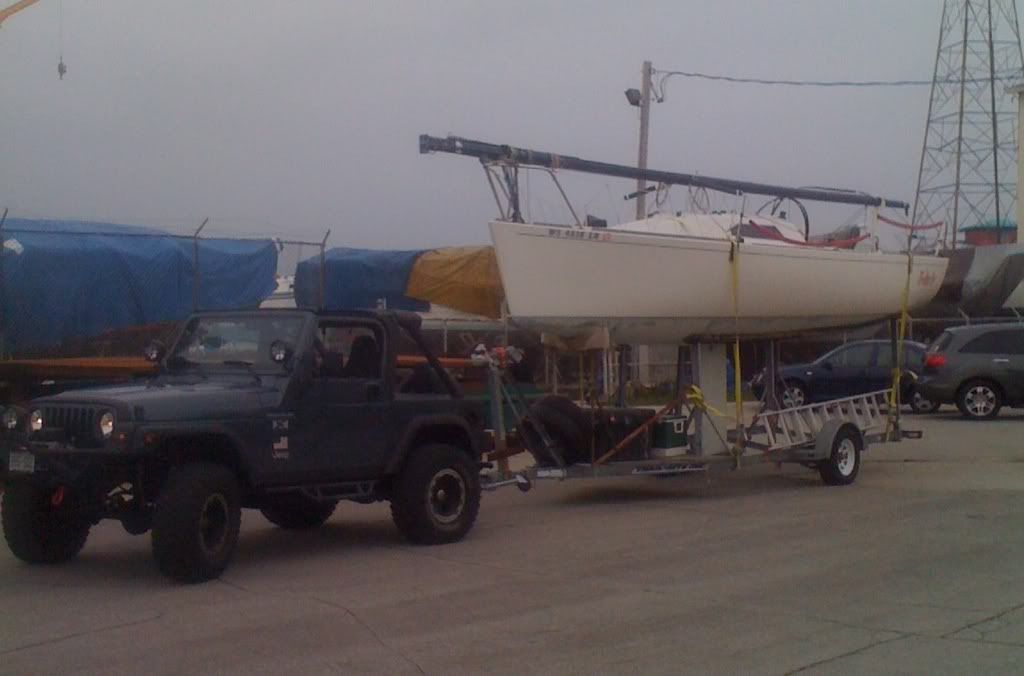

I'd be shocked to think an unlimited JK couldn't handle that little pop up. Granted, I don't hit the highway with this, but my little 3.07 geared TJ can tow this fella around easily.
Nice rollbar
