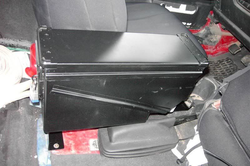

That 40mm can is a great size! Big enough to hold a ton of stuff but not so heavy that you can't lift it when it's full.
I wanted that size for a console as it's a little narrower than the 20mm can that most people use. The larger can was pinching my seat covers when I closed it. I made a bracket for the 40mm can to lift it up to arm rest height and over the e-brake handle.

Go to the hardware store and buy a couple of eye bolts. I think I used either 1/4" or 5/16". Also buy some lock washers and also some fender washers.
Drill a hole to match the eye bolt diameter through one of the slots in the can latch.
Put a regular washer (sized for whatever size eye bolt you bought) on the outside. Put the fender washer on the inside along with the lock washer and the nut. The idea of the fender washer is to give more surface area on the inside of the can where the eyebolt passes through to give more support if someone tries to pry the can open. Do this on both ends of the can.
Take a look at my picture in Post #6 to see the lock that I used.
You can buy sets of 2 or 4 locks with matching keys at Lowes/Home Depot.
