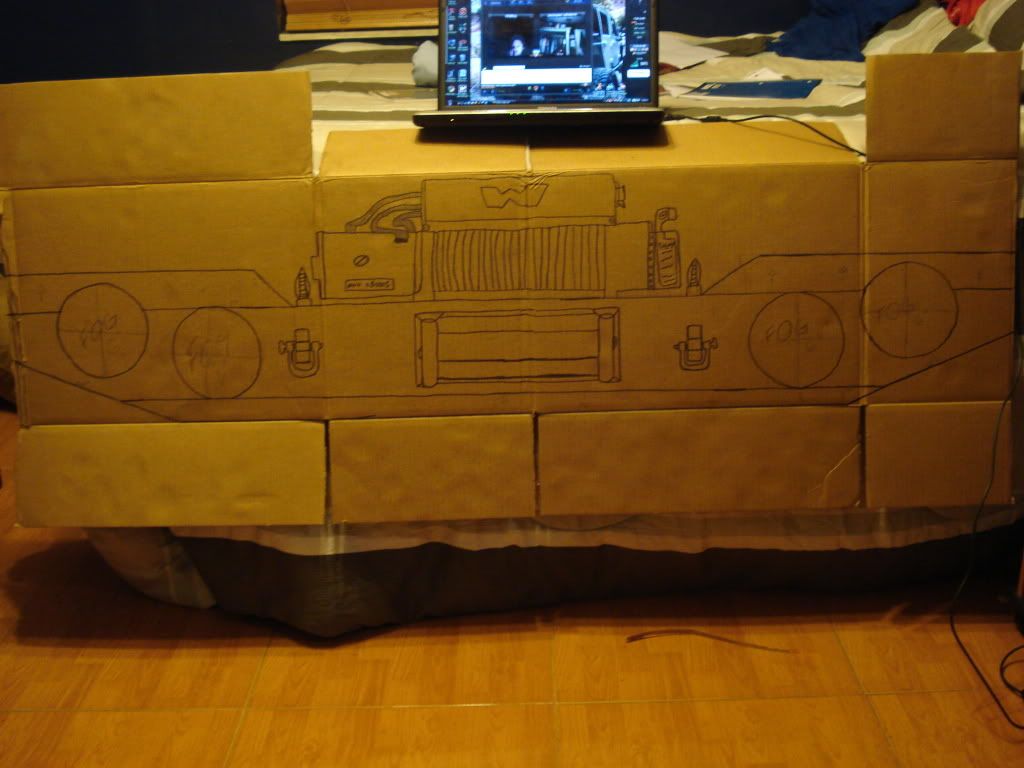

as most have seen i am building a bumper for my tj
does anyone know where i could get some sheet steel 1/4th inch i have both a mig and a arc welder i am adding a stinger n 2 supports to the stinger also i tried home depot lowes ace no luck

Hard to believe a person would own a welder and presumeably have the ability to use it and not know where to buy steel.
Nice drawing by the way!

Just curious..... Why 1/4"?
3/16" will be plenty with proper reinforcement for the d-ring mounts and you will save a significant amount of weight.

x2, I'd go with 3/16" for the majority of the bumper and maybe 1/4" for the winch plate and mounting brackets. That's what I did and it's still too heavy IMO
