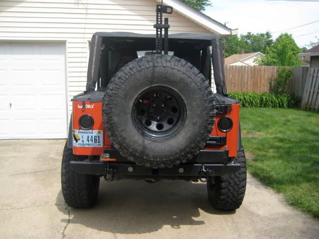

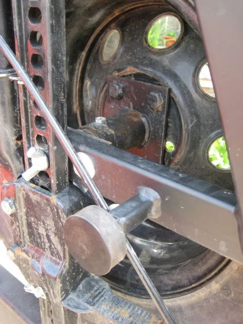

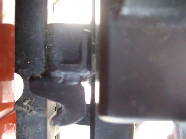

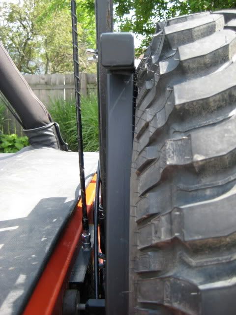

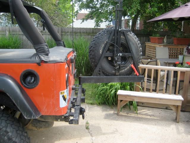

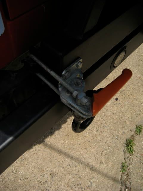

sorry, totally spaced i was supposed to get you pics. better late than never.
here is how tight the tire should fit against the a frame.
latch mechanism
back of carrier
proper adjustment of rubber stopper leaves about a 1/4" before latch is secured! (this might be where you are getting your rattle from)
finished product
