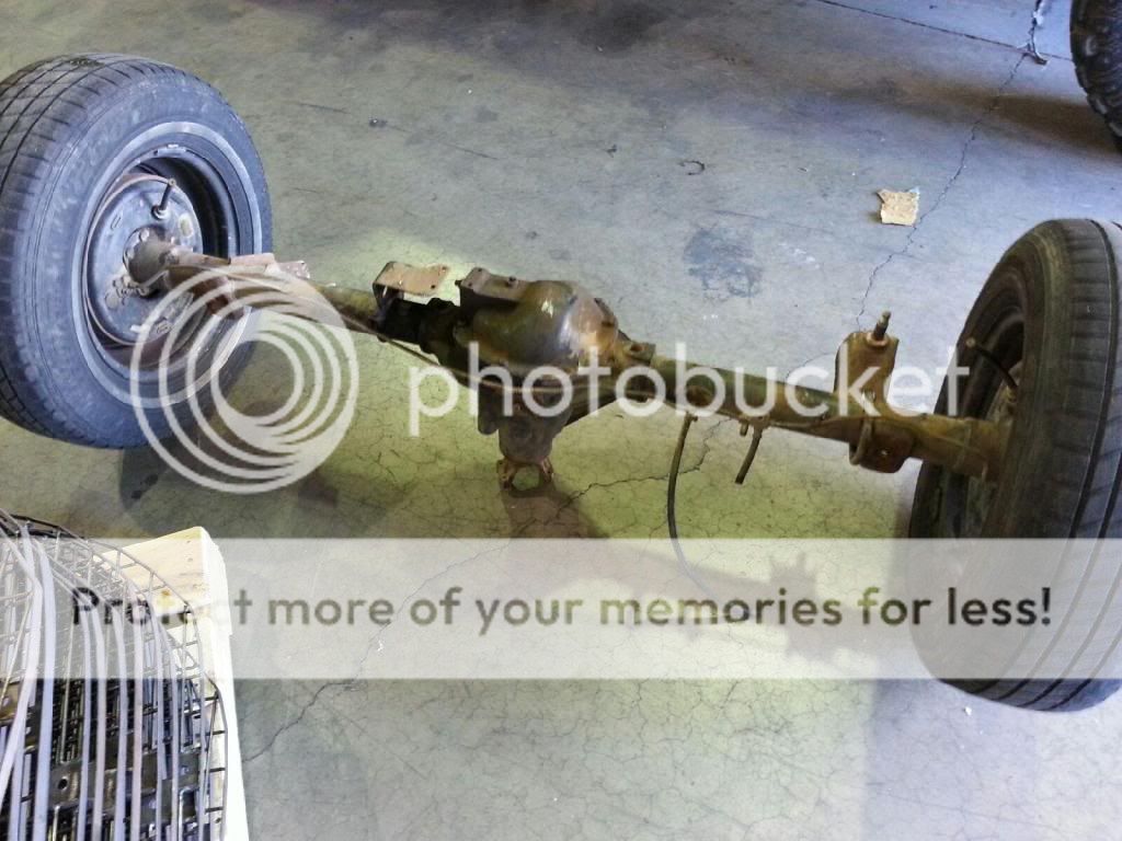

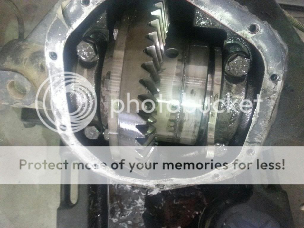

Here are some pictures:

I'm thinking my buddy was wrong.... this looks like an ox locker to me, not factory. What do you guys think?

Are the pics of it under the liberty?

I believe the pics are of it under the XJ.

Good, cause I don't know of any kj with leaf springs

Dana 44 with and E-Locker for $200? You got a heck of a deal regardless of what it actually is.
Seems like there would have to be some model numbers stamped on that locker. Try putting them in Google.

Thanks! I'm pretty stoked! Turns out it has 4.56 ratio (yes!!!!!) And its an ox locker!!!! I'm 99 percent sure. It appears to be one of their earlier models but is in perfect shape.

I emailed Ox, but i am sure it is one of their lockers. Upon further inspection, the diff cover is definitely not factory but appears incredibly professionally done. The large aluminum block houses the shifter fork. I plan on buying a new ox housing and cable setup. should be about $250 extra to have a perfect working ox locker and dana 44 I emailed ox to confirm it is one of theirs. I found some numbers on the shift fork and locker housing but nothing popped up using my google fu skills. The speedo housing is on top of the axle so I think it actually may be a KJ axle.
