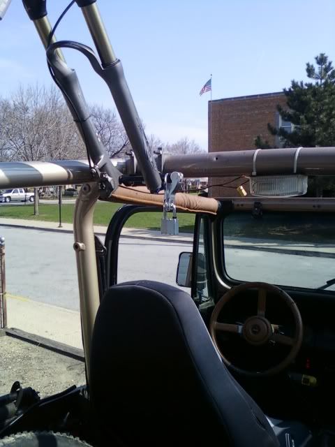

i didn't like the rear tire. its easy but i think its to much weight for tailgate, also i like having my bike above for safety and lastly i have it mounted in the rear so no mud falls on me with the design above it seems liek u need to take it off to put top on. i can keep mine on all year and doesnt require welding and tubes.
i get the fork mount tomorrow and i will be happy to show u my design! cost to make my design work so far, 27.00 25 for clips and 2 bucks for muffler clamps. i have my teacher getting me a rear mount for my rear tire.

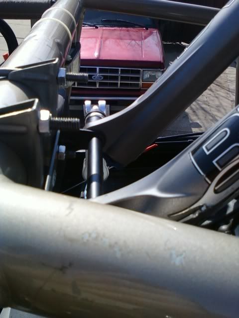

just finished it up yesterday, two muffler clamps and a fork mount... for the rear im getting a rear tire bracket to strap it down. but for now bungee works fine on to pics my roll bar got scratched so you can put some padding between the bar and clamp i didnt care. im also getting a summer top so it works all summer

Thats a really sweet idea.I drive a unlimited so i dont know if the length with work in my favor or against me. But i have a spare fork mount so i will definately have to try that. It looks pretty B.A. too.

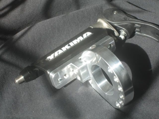

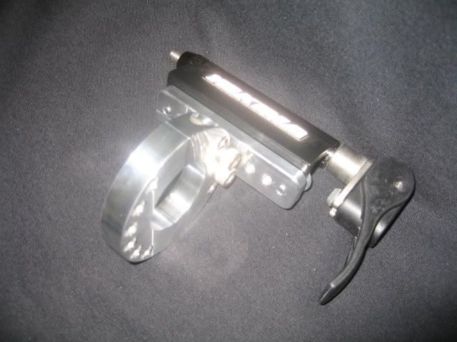

This is a pic of the bracket I use, its made by FOURTREKS, and is designed to work with a Yakima Deadhead mount. They make differant size collars depending on the size tubing of your cage or rollbar.

50 bucks for that clamp plus shipping or 3 bucks for muffler clamps ill stick with the m/c lol i guess it would work though

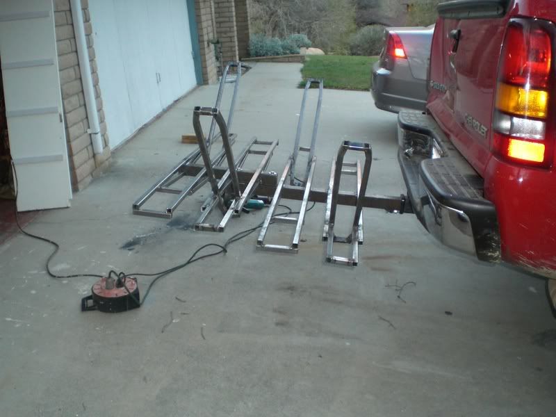

heres a a link and a picture of a guys homemade bike rack:
http://www.socaltrailriders.org/foru...bike-rack.html
