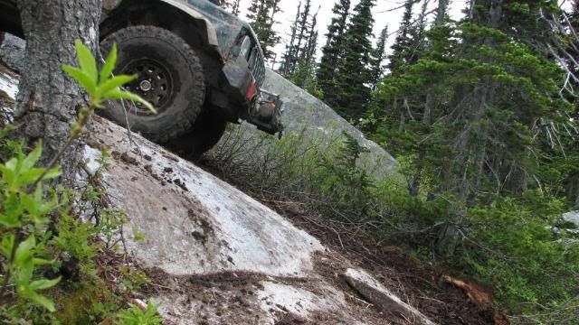

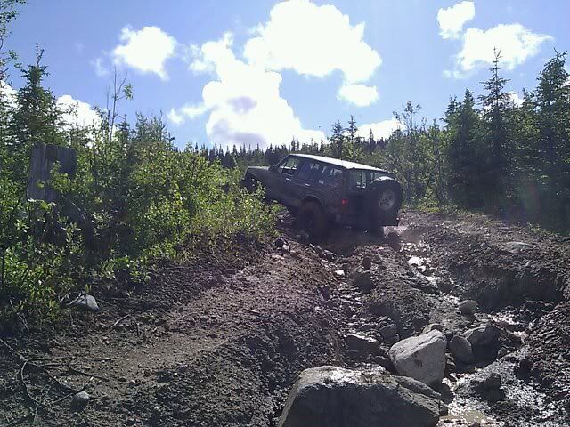

for the record... I run this
thru stuff liek this...
its not alot of rocks, but major mud, hard trails, logs, trees, mud, more mud, and some more mud....
I have yet to break a front welded or otherwise, Im not hard on the skinny peddle, find I dont need to be with the TSL, it just idles thru most ****, love my TSL
