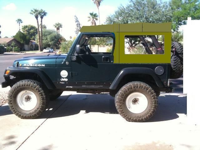

Unread 05-14-2012, 11:50 AM   #26
Squint77
Squint77's Avatar
Location: Tempe
Posts: 429
Here it is. Not exactly a TJ, but you get the idea- close enough.
Greg
Squint77 is offline   Reply With Quote
Unread 05-14-2012, 12:32 PM   #27
flying_bosun
Watching Big Brother?
flying_bosun's Avatar
Location: 34*24'N, 119*42'W, SoCal
Posts: 3,893
Originally Posted by Squint77 View Post
I also made a steel mounting rail that ties everything together and uses the factory holes for mounting. There are so many things you could bolt, tie, etc, to this rail that you cannot fasten to the factory tub without drilling holes. Perfect for outfitting my LJ. More on the mounting rail later...
The whole thing was drawn up in Solidworks by a friend who is an engineer originally, but I have changed it a number of times since.
"drool: Looking great and I am chomping at the bit in anticipation. I really would be more than happy to see any plans you might care to share in order to get started.
BTW, the "TJ" photoshop version looks fantastic, too.
