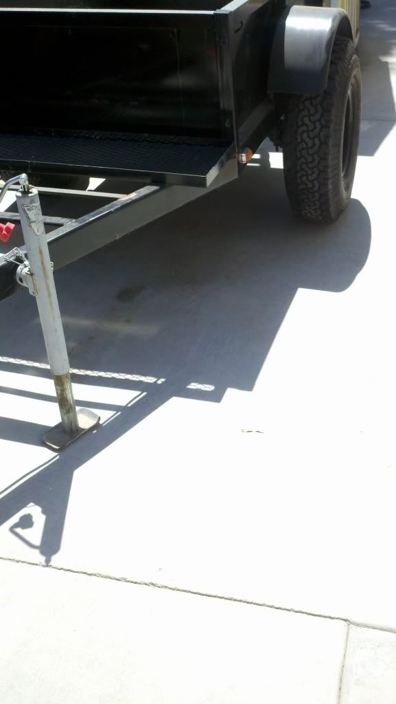

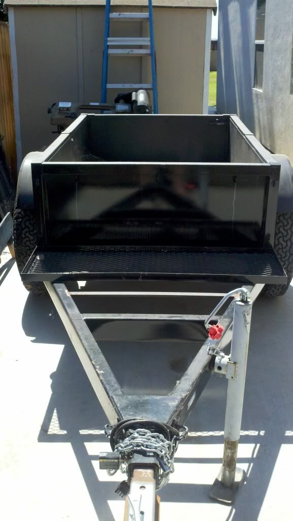

1. Absolutely...mine is the same width as the jeep, therefore, it'll go where the jeep goes. I did a #1500 to start with. On the first trip out I put a side load on it on both sides. By this I mean as I went over a large rock with one tire the loaded trailer had a lot of weight on the opposite side. This resulted in the spindle bending. Picture an old swing axle VW beetle. After replacing with a #3500 there have been no more issues.
2. Yep..and bolt pattern too. You can get the trailer hubs in 5x4.5. I used 33x10.50x15 BFG ATs.
3. I bought the fenders at TSC and trimed a few inches off each end.
4. I had a size in mind when I did mine. It came out t 44x68. Has a fold town tail gate too.
5. Look at my pics for the hitch. I used a receiver and have multiple hitch options. Pintle, ball, farm implement. Depends on what I'm using it for at that particuliar time.
6. Not too difficult to do at all.
7. I used oval LED tails and all wiring is routed to avoid any snags etc.
8. Yes. My main frame rails are 2x4 rectangular tubing. All other tubing is 1/8 wall 1 3/4 square. Inside panels are 1/8 sheet and Rhino lined.
9. Drain holes make clean up much easier.
10. Ideas from friends are always good when planning.
