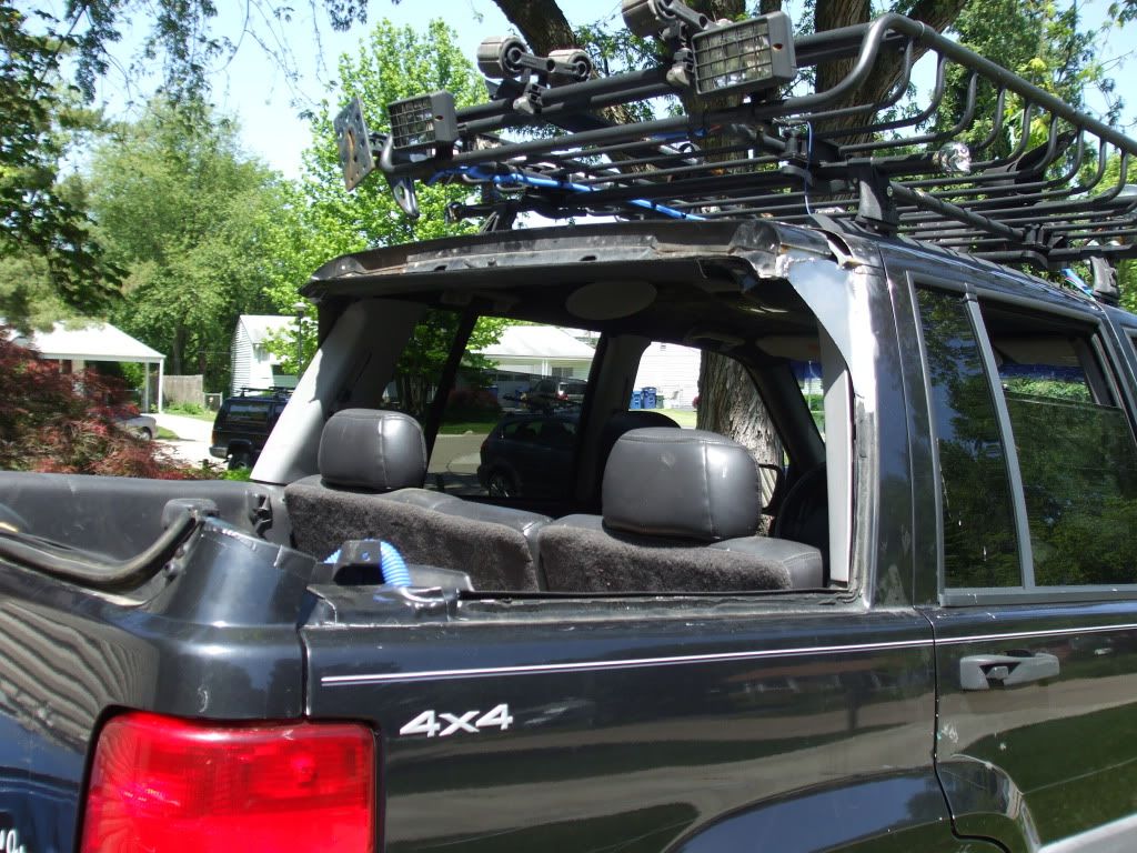

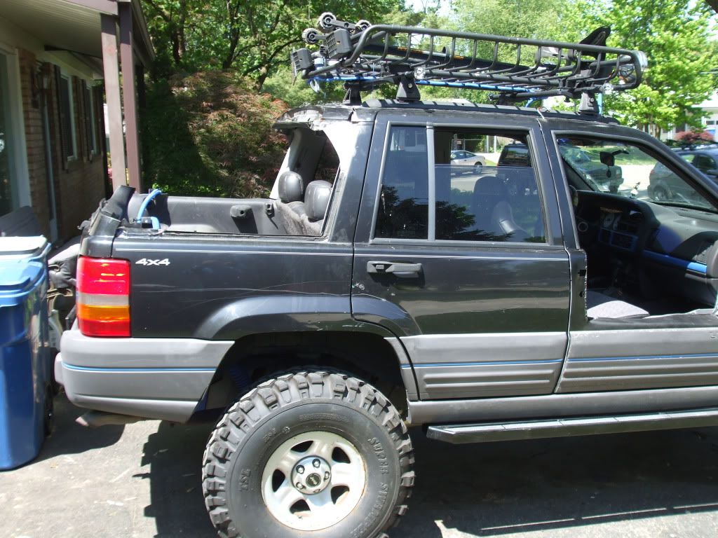

You can see the Dpillar top has been welded to just behind the Cpillar. It really solidified the roof. I can grab the Dpillar to help me up or if you are in the back standing you can grab it and shake the jeep back and forth pretty wildly and it seems good. I also put the hatch back in and that solidified the rear quarters. I used the nuts that are welded into the hatch to space it correctly from the body and then built spacers and drilled a hole in the dpillar and ran a bolt though it and the homemade spacers and it lined up well. And it is latched to the original location.
Think that I am going to have to hold off on Hannibal rocks. Which is a bummer since it is not open all the time. Once that cage is in(6pt or 10 pt) then Im game.
