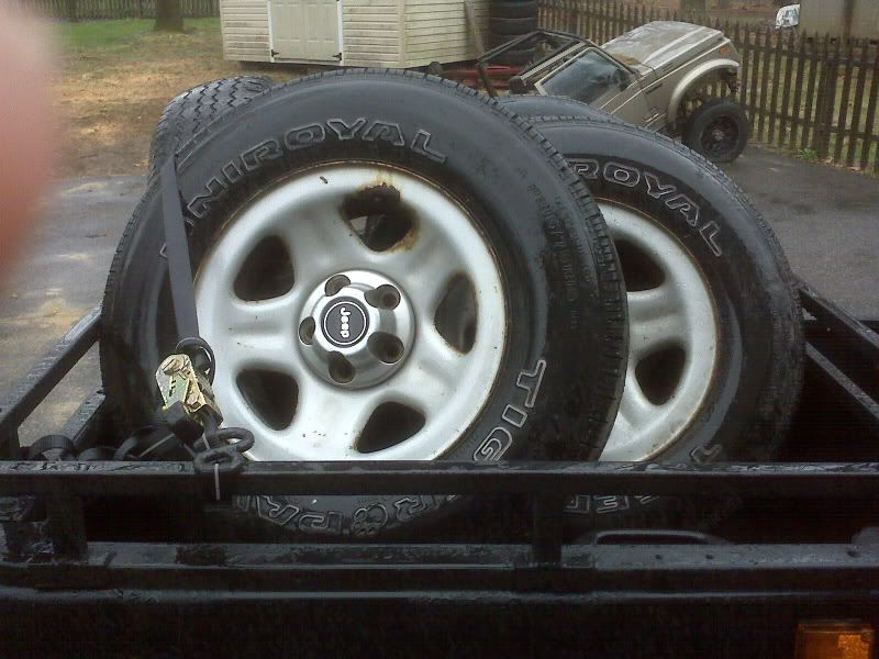

I have a RE BB and a 1" BL in the works and I want to run 32-11.50's or 33's
If I go 33" I am not sure if I will get 10.50's or 12.50's
I really like my factory wheels and I bought a set of jeep steelies to use for my trailer and extra spares.
On the jeep now.
Set of 5 wheels I bought for $60 for the trailer and as additional spares.
My question is: What size spacer will I need to run to clear suspension components of the sizes I mentioned. Will I still rub the 33-12.50's even with the lift I am planning?
I am leaning towards the 32's but there are limited tire choices in that size.

The amount of lift will not get you away from all rubbing issues. Spacers will move the wheels out (wider wheelbase) and keep them from rubbing on spring perches and towers and from body rubs at full lock when turning.

However, I do know that clearing the front swaybar and LCA during turns will be greatly affect by tire width. If you get a 33" tire and put on a stock wheel, I suggest a 33 X 9.5 R15. The Dean SXT is my favorite in that size, and since it's a quarter inch shorter than most 33" tires, that'd help your fit too. The 33 X 9.5 R15 size is not shown on Dean's website, but that size does exist since my local Schwabb store has them in stock and tells me the SXT are still being made in 33 X 9.5 R15 and will continue to be offered.
However, regearing becomes an issue with a 33" tire, though the light, narrow, slightly short Dean SXT 33" tire would be the best 33" tire for clearance and weight, and fit your rims well and clear your swaybar and LCAs well. Still not sure about the vertical height clearance though.
The easiest fit for you, IMO, would be the Parnelli Jones Dirt Grip 32 X 10.5 R15 tire. It's officially called a 31 X 10.5 R15 size, but is actually a 32" size. It'd be ideal for your fit, and it's a great tire for all terrains. I think it'd outperform any 32 X 11.5 R15 tire for all around, all purpose, versatility on all terrains and all climates and all weather conditions. It fits stock TJs just fine. So it'd be easy fit for you.
The SXT is also great for all terrains, IMO, and offers more ground clearance and similar flotation (because although it's an inch narrower, it's also an inch taller - so while the contact patch is narrower, it is also longer patch). But fitting the Jeep is most important factor, and also not needing to regear - and the PJ tire is the ideal size for those things.
Note: when I say "all terrains" I mean literally all terrains and all climates because these are hybrid tread tires (a nice crossbreed of AT and MT tread in one tire).
P.S. - BFG AT is available in 33 X 9.5 R15 if you want a great AT tire, but I think the Dean SXT (with extra sipes added to center treads by tire store) is the better tire for two reasons: SXT has a tread that can work on all terrains including mud. The BFG AT has a tread that works on all terrains except mud. So right there the SXT is better. Also, since the SXT is 1/4" shorter than the BFG AT, the SXT would fit easier for you. Though the PJ tire is probably your best bet since easy fit and works for all terrains.
PPS. - since you are in NJ I'll point out that the narrow the tire the better for winter roads. So a 33 X 9.5 R15 would be ideal for that. However, the 32 X 10.5 R15 would be good for winter roads and better for towing than a 33 X 9.5 would.
There is no way you can fit a 33 X 12.5 R15 on a stock rim, IMO. No satisfactory way anyhow. Also, a 12.5 wide tire would not be as good for the winter conditions and mud you're likely to encounter in NJ. A 12.5 would be excellent for sand and rocks, but a 10.5 is good enough on those things (if they aren't your main thing). On road, and especially while towing, you'd be most happy with a 10.5 wide tire, IMO. For towing a 10.5 would be better than a 9.5 (stability reasons) and way better than a 12.5 (power and gearing reasons).
So I suggest the 32 X 10.5 R15 for you. It's clearly your best choice since you are not regearing. Well, the 32 or a 31 X 10.5 R15. Either would be great for you, IMO.

Thanks for the advise.
That may actually end up saving me a lot of money. I have 2 procomp mud terrains with about 75% tread left that I recently took off my Jeep. I also have a complete set of 4 PepBoys AT's with 90% tread left on them.
With all the 31's I have, I can run AT's on the trailer, Parnelli Jones Dirt Grips on the TJ, and have 2 AT and 2 MT spares.
I can also avoid the 1" BL which I wasnt crazy about anyway and just run the 2" RE BB. That also would save me the cash for all the spacers.
I looked at the Parnelli Jones website and the 31's look like they are 31.5" OD. Is that what you were talking about?
I rarely see much mud where I am located. Almost everything is sand. I am planning on heading out to visit some Marine Corps buddies in Alabama and Oklahoma this summer. If the Fiance comes along, we are going to extend to the Grand Canyon and also hit Moab. Either way, the truck is going to see a lot of dirt this summer so my commuter Michelins have to go.
