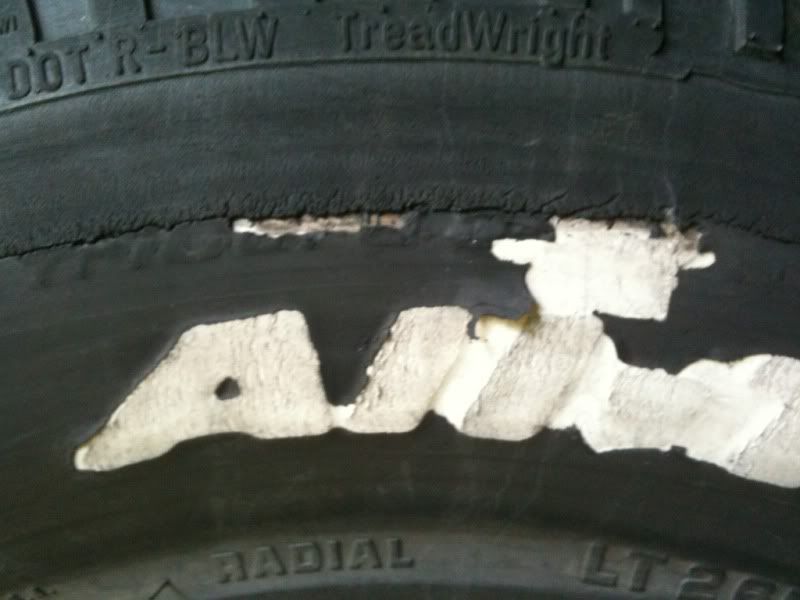

Originally Posted by srmitchell View Post
I've had my 265/75/16 A/t's from Treadwright for 2 years now. Can't wait to get rid of the damn things.
The tread is flaky. I have many lugs with big cuts, and chunks missing.
2 of the tires are older than 2006. (One is from 04- eek) All suffer from dryrot.
The biggest issue is the cracking and flaking of the recap. This tires just look awful, and the sidewalls are very weak.
Also, they're heavy as hell.
They've been used heavily,but still, new tires would not do this.
New tires do that
Looks like you got a bad batch or ride the curb. PO said thats what happened with mine.
That or someone is taking corners too fast too often. Indicated by how far up the sidewall the shaves are.
New tires do that
No, I use my jeep. These tires just aren't good enough to last in harsh driving. Sidewalls are too old and brittle.
It happened wheeling. (Not specifically here though)
http://i24.photobucket.com/albums/c1..._/DSCN4902.jpg
http://i24.photobucket.com/albums/c1..._/0684f0c1.jpg
Drop any radial tire to 15 PSI and constantly run the tire up the side of a rock. Report back here with results. If you use any radial tires sidewall to climb they will start to peel like that. The sidewalls on treadwrights are all revulcanized after the tread is put on. They will last just fine on most trails, but they will not last 2 years as a weekend warrior trail vehicle. They are still a retread tire and still a radial tire. BFG A/T's are also known for that exact problem on older tires. Like has been said that is something that happens when the tires are not used like designed. We have plenty of people that I wheel with on a lot rougher/bigger rocks than you posted photo's of that have done so without a problem. This on top of the fact that you are running the cheapest tires that treadwright offers...
I'm not arguing with this. I agree with everything you've said.
Point being, these don't last the way I've used them. Im going km2 or kevlar next.

A lot of the time time it depends on what casings you get. I asked specificly for BFG AT KO's because of the strong 3 ply sidewalls. They have held up to a lot of abuse. Others have run tires that were not C rated, or not KO casings as re-treads and had poor results.
