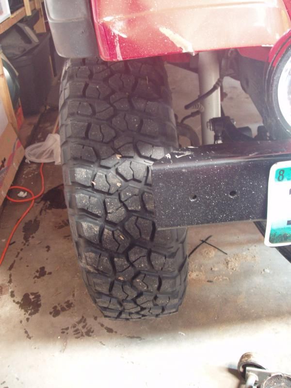

In the never ending quest for better traction, how many others out there have done this? Show us what ya got!
Pro Comp XMT, a bit worn with some miles on em.
BTW, the sipes I cut by turning the blade over are visible as well.

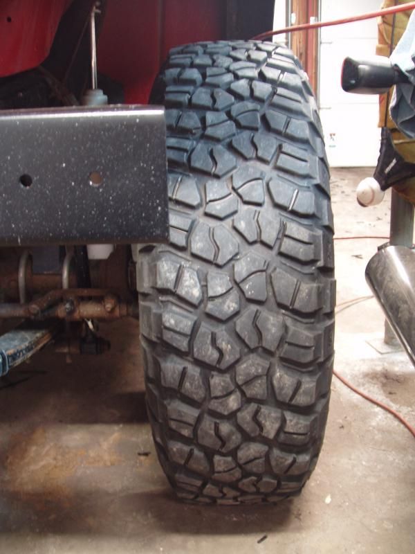

I opened up the factory groves on my KM2's as they wore out and also added a few more. They now have as good or better than new traction on hard packed snow.
Where I started:
What I ended up with:
John82601 is offline
Where I started:
Cool deal!
It sure is amazing what this simple, low cost DIY mod can do for your traction.

It may not add to total longevity of the tire (i.e. - mileage before bald) but I feel that it greatly increased my usable longevity. My KM2's were starting to get pretty slick on hardpack snow as the separate tread blocks were becoming single, large tread blocks. Using the groover to renew the grooves in the tire and give me more, smaller, biting edges will let me get a few more winters out of them before they get sold off or become summer-only tires.
I agree that any time you remove rubber from the tread you are reducing the total number of street miles you will get out of the tires. For me, that wasn't a concern.
Oh yeah, it took me 15-20 min per tire at a very leisurely pace to groove my tires.

That looks factory, and what BFG should be doing in the first place. If I had KM2s, I'd copy that.
Oops, meant to respond to John82601.

That does look factory. He did a great job.
