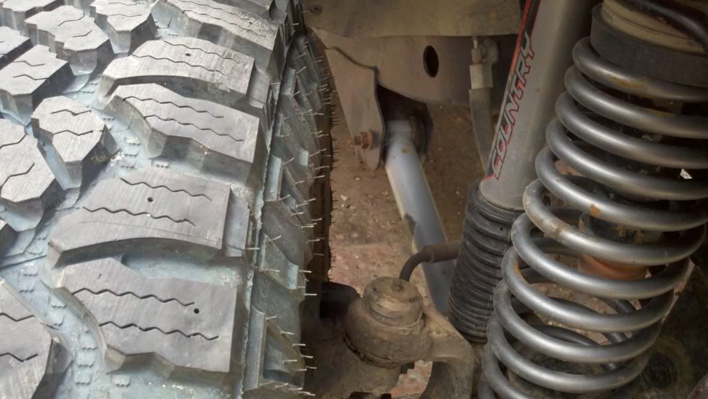

3.75" bs with a 1.25" spacer makes 2.5" bs. and 3.75" may not be enough with 33x12.5s, It's not about hitting the coil or flexing into the spring/shock tower, it's about rubbing at full stop when turning, you can adjust your steering stops to limit your turning radius, but why limit your Jeep when spacers will keep your radius.
no spacer -
With the spacer -
