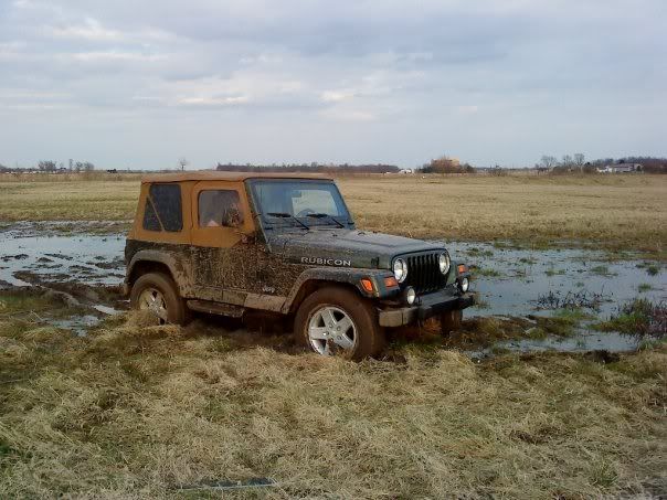

First pics of the Jeep with the rims that are on it now, please. Second, 15x8 is a pretty common rim size for Jeeps. A 10.5 or 12.5 wide tire will fit fine. The thing you must watch for is the back spacing of the rim. You may want to look at your tire choice depending on what you are going to use your Jeep for. More details are needed for that. You could fit a 33" tire with your setup but you wont be doing much off-roading.

It is not a Rubicon, the previous owner decided to put those on there.
