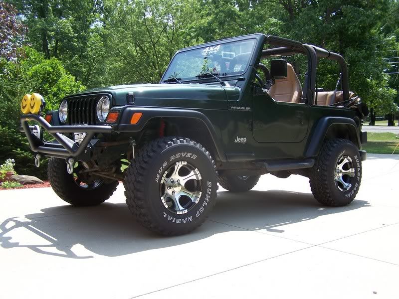

hey i purchased the 2" BDS lift last year and had 30" mud rovers. This summer i got new wheels and tires. I put some 32" Mud Rovers, and had tons of room!!!!!!! no rubbing at full turn!! I could of easily put 33's on with no body lift or anything!! I JUST have 2" BDS too. I have a 97 and probly netted around 3.5", ill send a pic soon

2" BDS on 32x11.5" MUD ROVERS

Remember that the 32" Dunlop Mud Rovers actuall height is only 31.3". Which makes them the smallest 32" tire on the market. On the other hand, the 31" Interco SSR's are 31.5". Which makes them the tallest 31". So it all depends on what tire you buy as to how much room you will have.

that how all tires are! all tires are about 1" less than what they advertise, except those super swamper cause of the thread size. Besides i was just telling the guy that my 32's fit fine and would def have the room with no rub if i went to 33's, not matter wha kind of tire!!
Besides the mud rovers have some of the biggest threads on the market, besides super swampers
